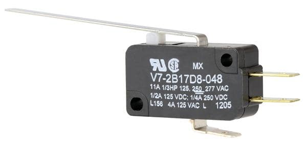

Hello punters, still dodging along with this project as time allows!
Am hoping someone has good suggestions for a switch. I have wired up the actuators using 2 car horn relays to confirm all working ok before trying to nut out the panel mount relay. Everything is working well and am using a SPDT rocker switch to control the actuators. What I need to do is set up a switch so the lift carriage passes by and controls the actuators. So when the carriage goes up (maybe 300mm off the ground) it will lock the lower door. When it returns to the lower floor the switch will unlock the door. Same applies for the top floor. What type of switch can I use that the carriage can activate on the way past up & down? Switch needs to return to centre after the lift passes. So a momentary on/off/on SPDT . Is there a limit switch type of switch with a lever that can do this?
Thanks!
The microswitches with long arms (you can place them in the side track and they can set/release as the car passes.
https://www.ttiinc.com/content/ttii...MIhu2K4bS33gIVz1qGCh1bKQ1NEAQYAiABEgL1wvD_BwE
I think they are an on/off switch? Needs to be momentary on but double throw, on/off/on, and be able to be activated as the lift passes upwards or downwards, that's why I was thinking of a limit switch type of roller lever that resets to off after the lift passes
The micro switches can be arranged so they are momentary when the lift passes. Look for the ones with the bent wire lever/arm or with a roller.
