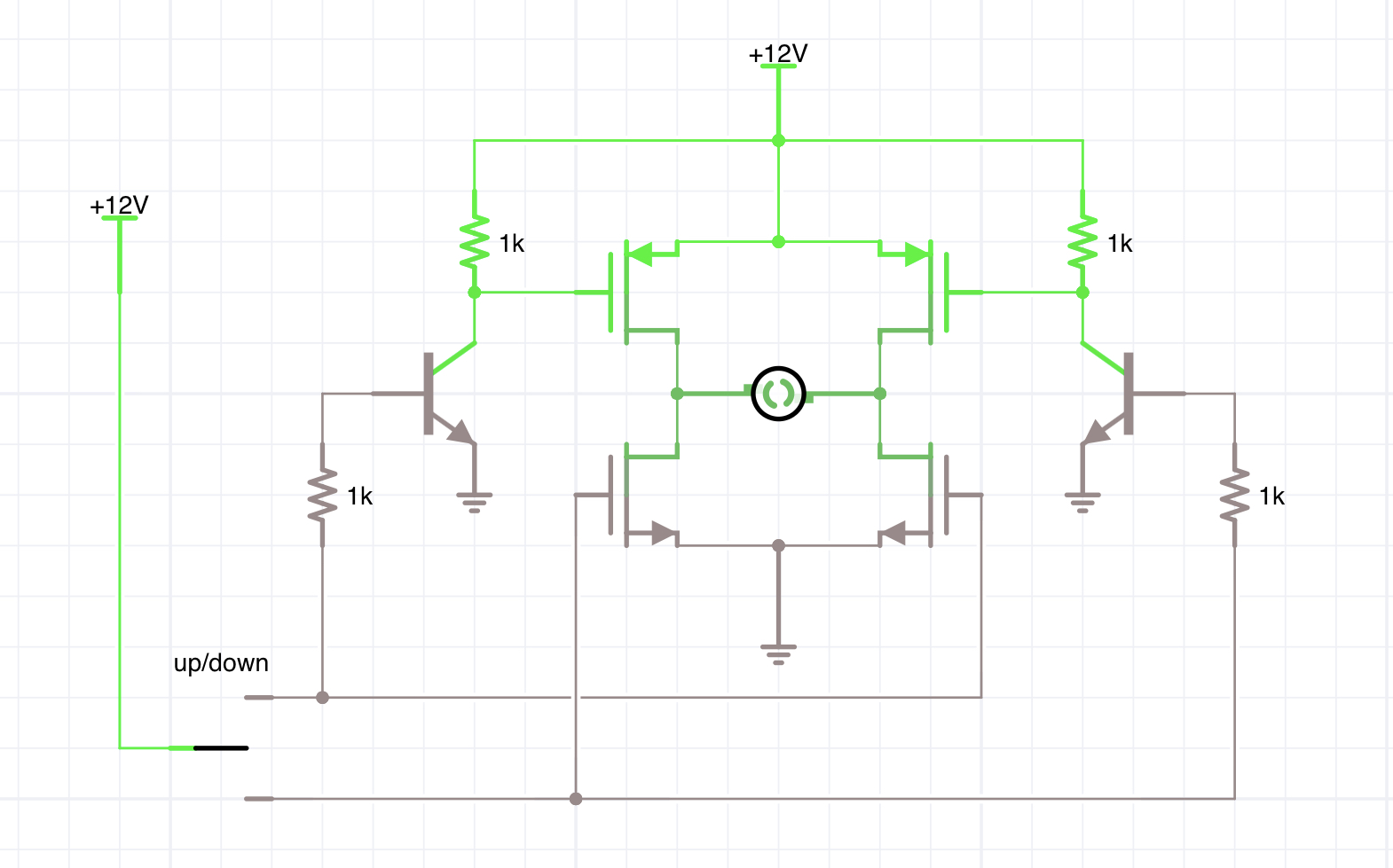

Im pretty sure I can make them do the job but need assistance on how to actuate them. They work on 12V momentary pulse to actuate in one direction and then momentary reverse polarity to actuate in the other direction. I have 12V supply but am unsure how to get the reverse polarity to actuate in the opposite direction? Do I just need 2 x 12V supplies to a relay with one supply reversed (to suit how I will switch it)?

One solution would be a (very) large capacitor in series with the actuator and a change over switch. Current will flow until the capacitor is charged. Unfortunately, the capacitor required might be huge depending on the current and time required to switch the solenoid.
You need an "H-Bridge" to reverse the circuit as below. You may be able to buy a fully assembled H-bridge to drive this on eBay.
Add 10K pull down resistors from each of the switch throws to GND to guarantee that all four FETs are off in the wait state. The base resistors sorta kinda do this through the BJT base-emittter junctions, but not well.
Ooh, H-Bridges look technical! And the ones I am looking at look like they are for Arduino boards?
As I have 2 actuators that need to be controlled individually I guess that means 2 H-Bridges?

yes, yes, we can do relays too but my little computer with the easy schematic drawing app is being used by a guest. maybe someone else can help but you can look at the H-bridge and maybe figure out the DPDT relay. Or to recycle someone else's explanation...
