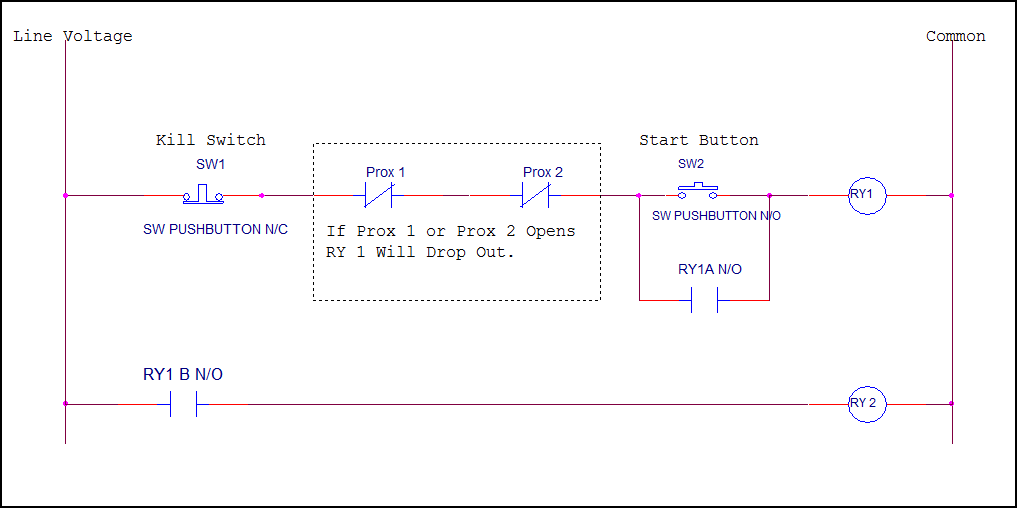

I don't think you want a dual coil latching relay in this application. Currently you have a system with a "Kill Switch". A Kill Switch is generally a normally closed push button switch, on some when pushed they mechanically latch open while on others they simply create a momentary open. Kill switches also generally have a large red mushroom button making them easy for a machine operator to hit. Some machine start / stop circuits run on low voltage DC while others may run on line voltage (AC Mains). The below circuit is a very basic example of a typical latching relay circuit as used on machinery.
In the example the Kill Switch, Prox 1 and Prox 2 are all normally closed contacts allowing voltage to the Start Push Button. When SW2 is momentarily pressed RY1 pulls in. The normally open relay contacts across SW2 close and this action "Latches" RY1 in an On state. Any break in the line, be it the kill switch, prox 1 or prox 2 opening then RY1 will drop out. Pressing the start button won't do anything until the fault that caused prox 1 or prox 2 to open is resolved.
Per Alec, the switches you are looking at come in several designs as to output to drive a relay. Knowing your design is important. For example you see NPN and PNP used in the description. For example you may want an NPN Open Collector switch so each switch output can be configured to drive a NAND or AND gate.

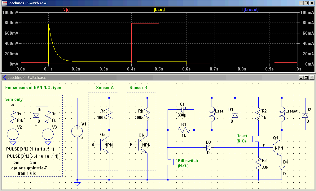

Something like this should do what you want, if the sensors are of the NPN-N.O. type (i.e. with open-collector outputs.
  • LatchingKillSwitch.asc
