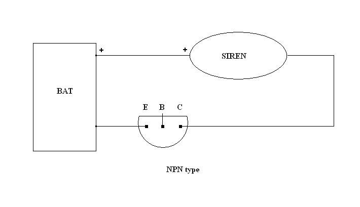

If you're going to knock up that transistor and siren i posted earlier,
then please show a photo if you can, before energising it.
(just in case)
John :)

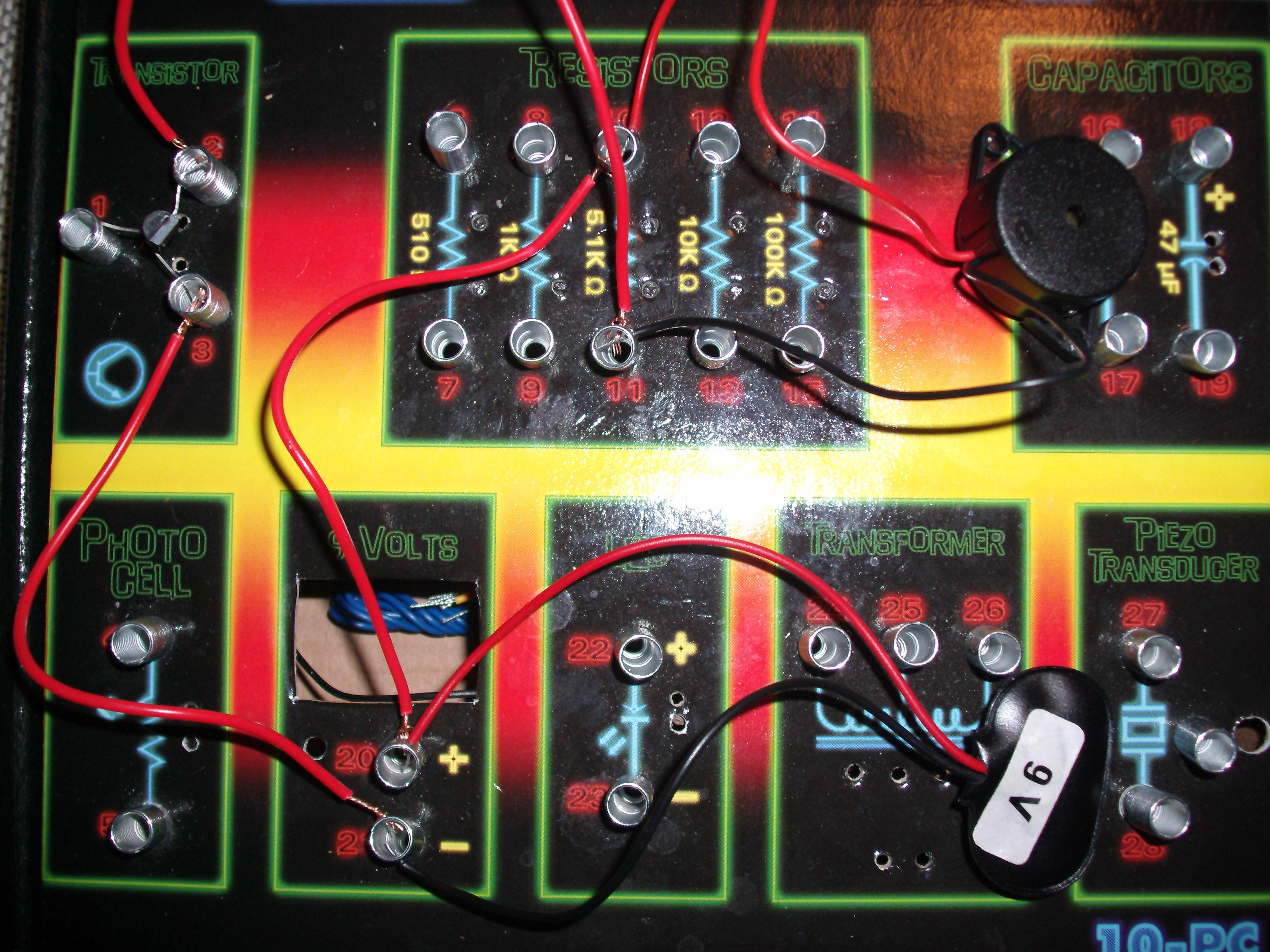

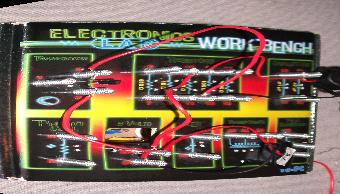

Here are some pics. These are the pics of what I originally had. I'm going to try what you guys have been suggesting I guess. And thanks a lot again by the way.
And Torben. My laser is just a normal laser. It has 5mW of power. The 28.5V junk was my confusion over the transistor needing 30V so I'd have like 19 AA batteries supplying 28.5V and the laser supplied the rest. So when it broke, there wasn't enough and the siren would go off.

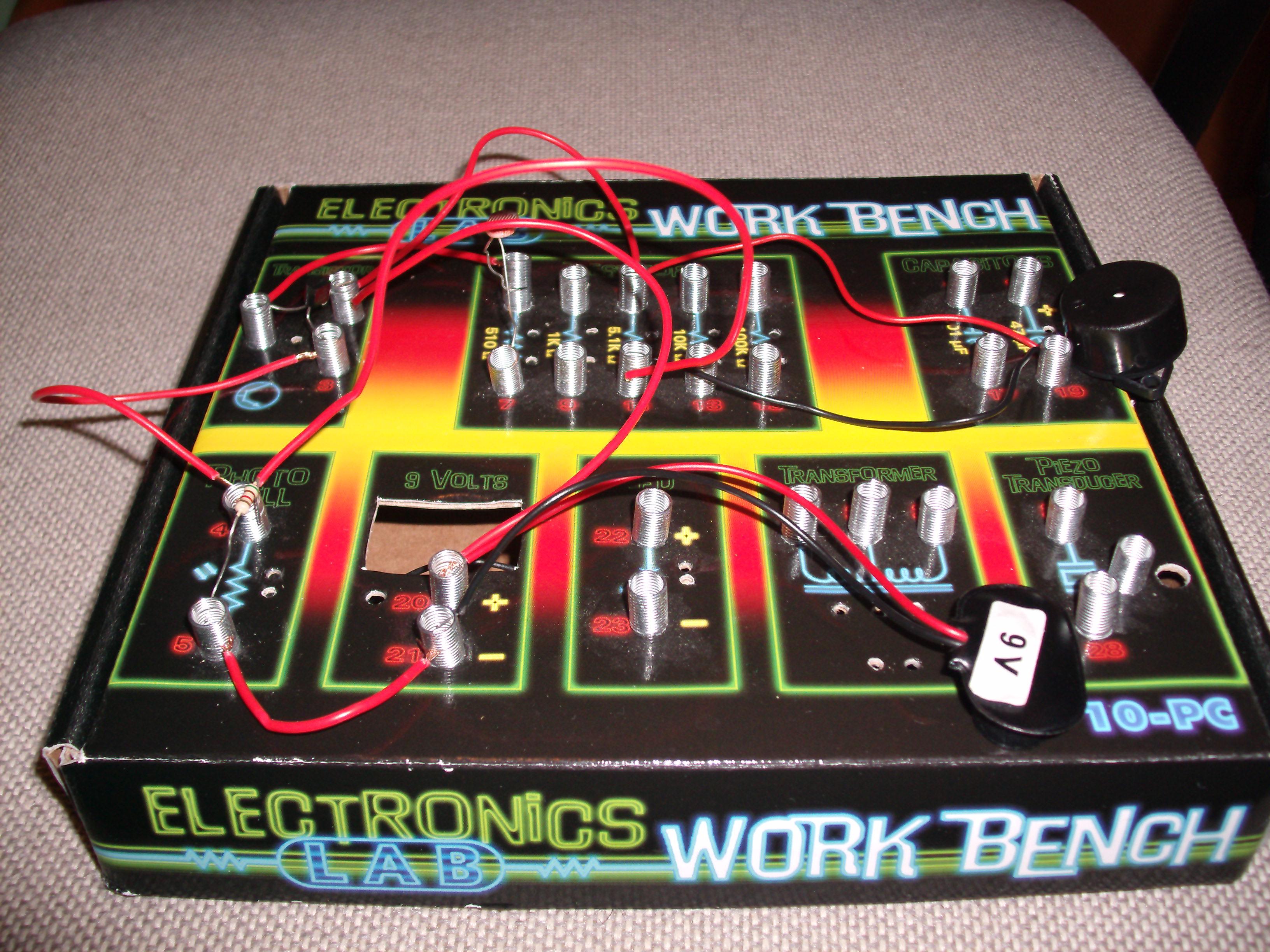

Any chance of one from directly above the springs. ?
John :)
Umm sure. Well I was making that small circuit you advised me to before. So it's kinda disassembled. Should I still take them nonetheless?
just one from above is all i want.
please carry on with the circuit you're doing.
Cheers, John :)

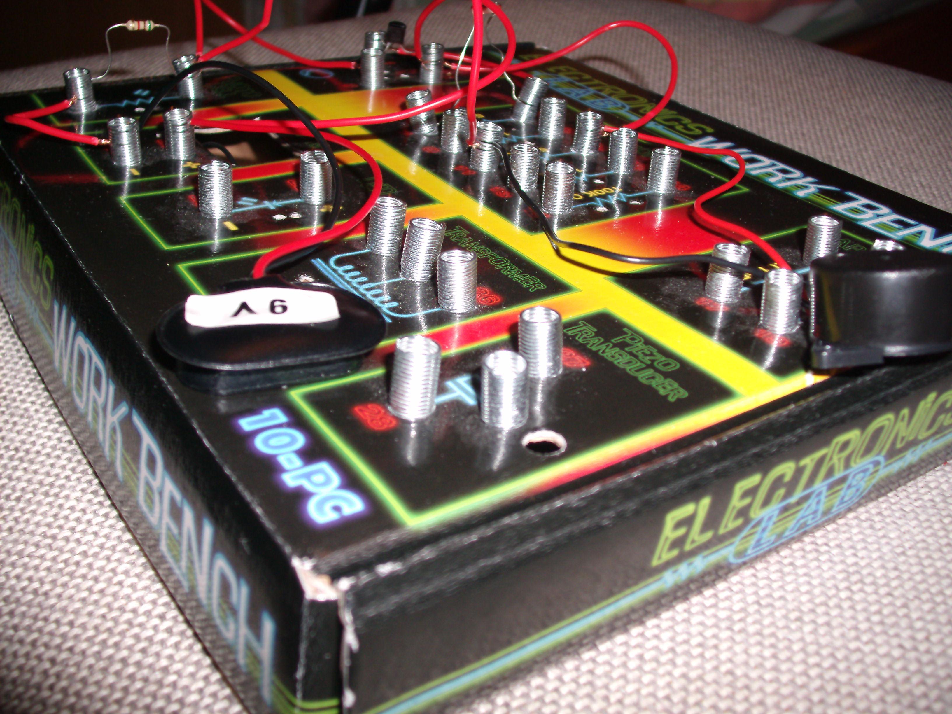

I believe I got it right. I must admit that I am a little confused as to the connections. I mean...+ve of battery to +ve of siren? But anyway, this is what it looks like with that circuit you advised. The pic from above is coming. The one I took right now was too big for this forum. -_-;

Have you put that circuit together ?
Yes, I have. I have a pic of it in a previous post. It's called "6". And I think it's just the size of the pic that's causing this. When I shoot a bird's eye view of it, the pic size is bigger than the other views. :confused: :(
Edit: Wait..that pic. I can't really see it.... Have you just rotated pic "6"? Or made your own?

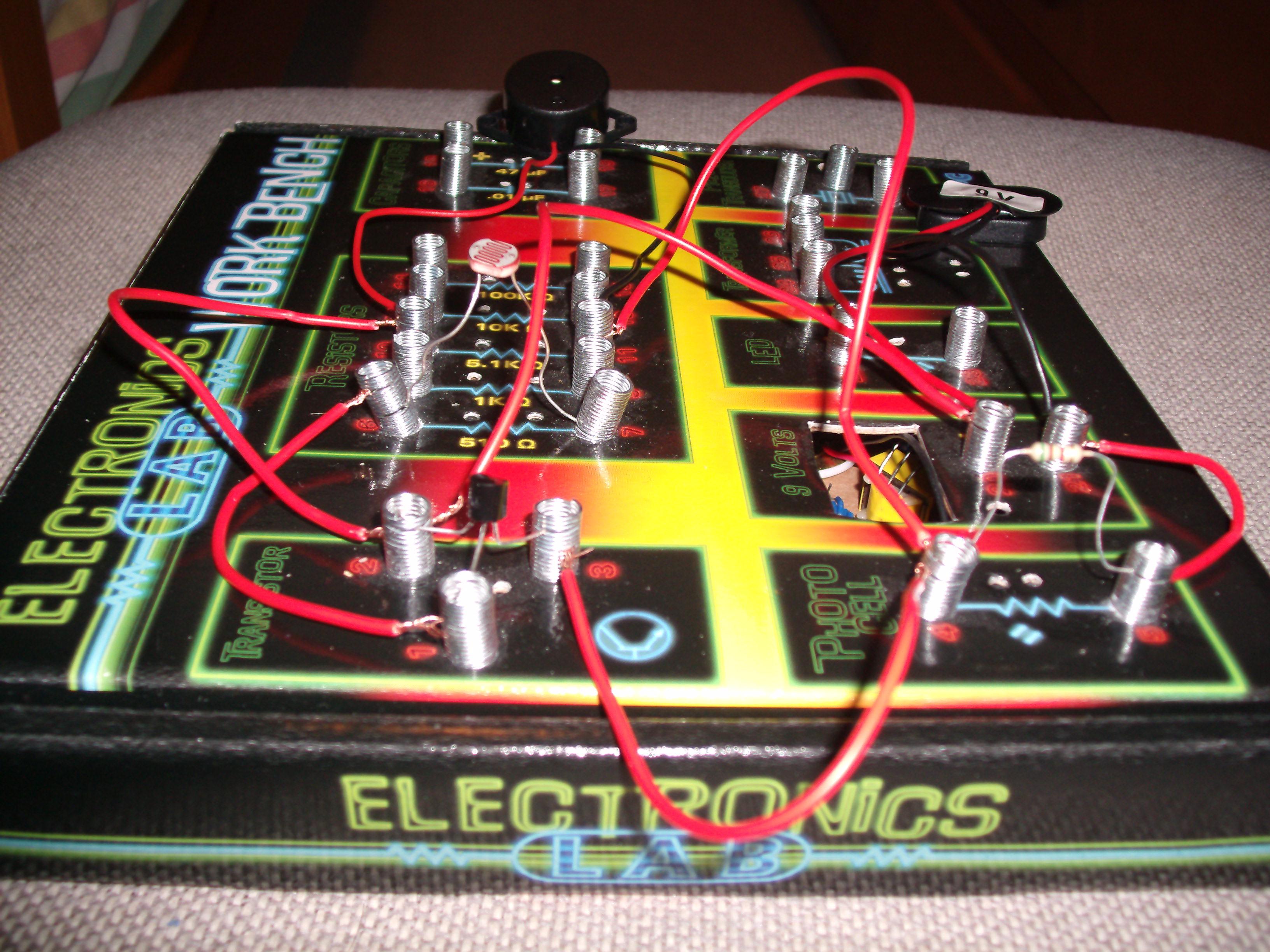

Ok got it. I had to bring the camera in a little. I hope you can understand it.
