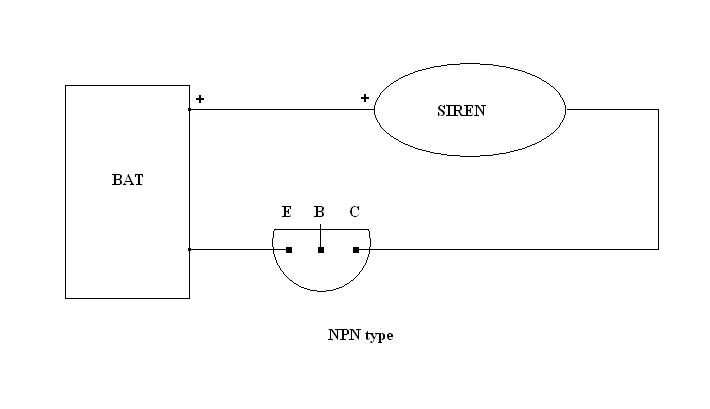

Okay, i looked at the picture of your buzzer/siren.
Yes, one lead is red, that is to indicate positive.
The chances are if you tried it the other way round, that would bust it.
Here is a little picture i have drawn.
Before you put it together with springs, are the springs spaced decently apart?
we dont want any of them touching each other.
The wire you may be using ...
is it insulated wire, which you bare the end a little way for the contact ?
Its not just lengths of bare wire is it ?
Do you reckon you could link up the siren and a transistor like that ?
If you do so it should not operate the siren yet.
John :)

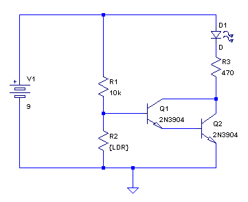

OK, here's a basic circuit. It's essentially the same thing that Hans (AKA Boncuk) posted earlier, except this one uses a Darlington pair instead of just one transistor.
I've drawn this one running from 9V, on the hypothesis that you have a 9V battery and not a 12V battery handy. You can either replace R3 and the LED in my circuit with your buzzer (make sure the + lead goes to V+ and the - lead goes to the collector of the Darlington pair) or just wire it parallel to LED/R3 so that you get light and sound when the beam is broken.
The buzzer should work fine at 9V; just won't be as loud as at 12V. If you want to run the thing at 12V just increase R3 to 680 ohms or so first to protect the LED. (Hm. You don't list 680 ohms in your parts list--so if you run it at 12V, try 1K for R3 and if that's too dim use 330 ohms in series with 470 ohms instead).
When I built this last night it would make a godawful howl unless I kept my cheap laser pointer aimed right at the LDR.
If you have any questions or problems lemme know. This should take about 5-10 minutes to wire together and test using your spring board.
I assume you have an LDR and a laser pointer or similar? Your original post mentioned something about running a laser on 28.5V or so. . .? Cheap laser pointers often just run off of 3 1.5V button cells in series. What kind of laser are you using?
