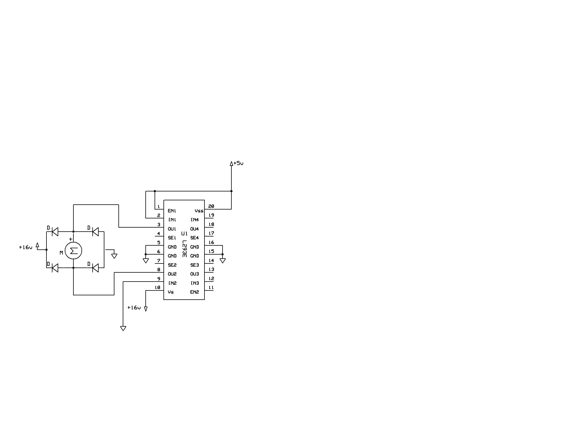

I'm new there and pretty new to the robotic world and i'm trying to do a project with a L293N to drive my motors from an Arduino board.
Let me explain the problem....
I have tried 2 motors
First one is a small 5v ( i suppose) motor comming from an old CD-ROM drive.
The Second one is a unknown 12v motor.
The problem is:
The small motor when connected to L293 is running about at half speed then when connected directly to the Power Supply. I didnt calculate the amps but it should be really low.
The bigger 12v motor is not running at all when connected to the L293. When connected directly to the power supply it run fine and i'm observing a peak of about 1.2Amps at startup then it runs at about 600mA. When Applying PWM to the input pin I can ear noise. It start to run when I connect 1 of the 2 wires of the motor to the ground it running fine and at full speed.
The Facts:
The Schematic I'm using is the one comming with the specsheet of the L293N IC for Bi-Directional. I tried with and without the diodes I used (251D) but I think the diodes are just a higher level of short circuit protection.
I also tried of stacking 2 L293N chip and using all the 8 bridges on it ... with the sames results.
the +5V for IC logic is connected to my arduino 5V supply
I tried with a 1000uF Capacitor on the 12V line too without any succes.
I also tried to connect 1 input pin to groun and the other to +5V with the same problem.
I'm kinda out of idea i'm working on this for about 7hours and browsing the web without any clue of what happening....

OMG I made a big mistake.. its not a L293N its an L293E just miss typed it on topic and re used it thru the Thread....

I have the 20 pins IC and the chip is not destroyed, I tested all the inputs 1 by 1 in a 1 channel configuration (no reverse) also tested both direction on all channels and they all works fine. The problem is when I try the 2 channel configuration to have the reverse.

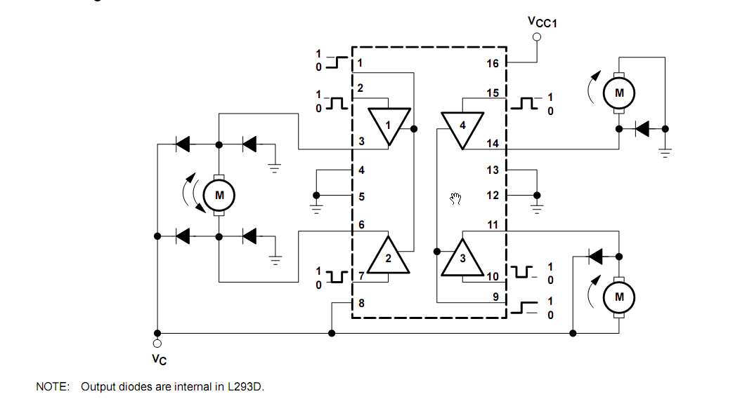

The circuit i'm trying to get workin is the one on the left ... the ones on the right side are all working on any pins.
https://www.electro-tech-online.com/attachments/esp02-sep-16-gif.22388/
I have double checked the pins for the 20 pins chip and all the connection are right from the beginning the Enable pin is on +5 and one of the inputs is HIGH and the other one is LOW
I have checked lots of circuit on the net ... and they all using the same configuration and seen no problems.. but since I have checked all the outputs independently in both current direction i can conclude that the IC is working.. I also tried another IC and I have same kind of results...
You attached the schematic for the 16 pins L293B or L293D.
Copy and post the schematic you are using from the datasheet.
Ok I have made the Schematic and attached it to this post. With this it should be clear how i'm using it
I have removed the MCU inputs from the equation just to be sure he is not in cause.. I'm using +5V from an USB port thru the MCU.
I hope is much clearer now

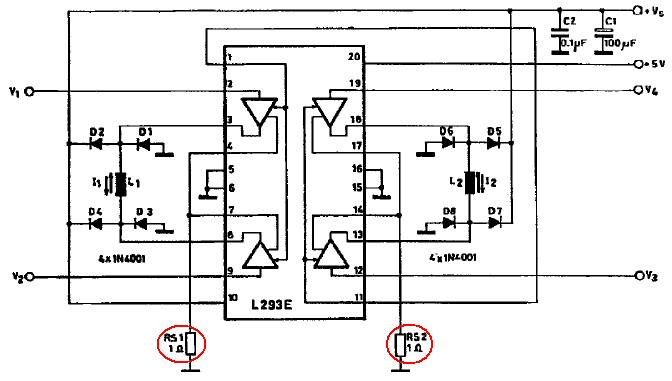

The datasheet has the sensing pins 4 and 7 connected to ground through resistors with their value not specified and also shows pins 4 and 7 connected together and connected to a 1 ohm resistor to ground. You forgot to connect them.
The datasheet does not explain the function of pins 4 and 7. Maybe they limit the max current.
They are for sensing the current the motor is using.. i read somewhere they can be leaved Open... but not sure... im not sure what resistance value I should use...
The datasheet shows you 1 ohm which limits the current to 2A.
Without a resistor the current is nothing.
Thanks a lot it is working just fine .. I tried with a piece of wire since I have no 1ohm at the moment .. and the motor start running... I will buy 1ohm resistor tomorrow continue experiments but it should be good now.
