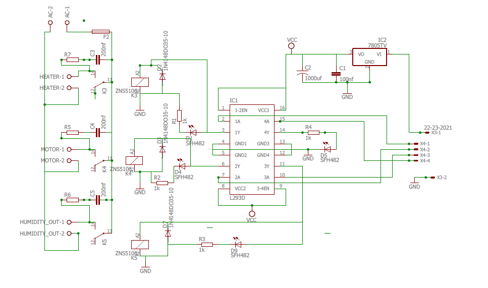

l293d interface MCU to relay
mah
could i use l293d to interface MCU to separate relays?
do i need external freewheeling diodes ?
is there any problem with this circuit
