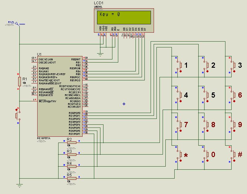

Hi, there..
I'm designing a 3x4 KeyPad with LCD. I'm using pic16f877a and PICBasic.
The program take the number from the keypad and disply the number on the LCD"Key= num".If no number pressed the LCD disply "Key= 0"
The problem is: only the numbers of the first column are displied on the LCD.
I tried to solve the problem but i couldn't. plz help me.:confused::confused:
DEFINE OSC 20

Key VAR WORD
'**** KeyPad *****
TRISD = %11110000

SCANKEY:
    KEYPRESS = 0
PORTD = %0100                      ' Chose colum 1
    CALL ROW
    IF FLAG = 1 THEN FIRST_COLUM
PORTD = %0010                      ' Chose colum 2
    CALL ROW
    IF FLAG = 1 THEN SECOND_COLUM
PORTD = %0001                      ' Chose colum 3
    CALL ROW
    IF FLAG = 1 THEN THIRD_COLUM
    KEY_RESULT = 0
    RETURN
FIRST_COLUM:
    LOOKUP KEYPRESS,[1,4,7,10],KEY_RESULT
    OLD_RESULT = KEY_RESULT
    RETURN
SECOND_COLUM:
    LOOKUP KEYPRESS,[2,5,8,0],KEY_RESULT
    RETURN
THIRD_COLUM:
    LOOKUP KEYPRESS,[3,6,9,11],KEY_RESULT
    RETURN
ROW:
    FLAG = 1
    IF PORTD.4 = 1 THEN EXIT_ROW
    KEYPRESS = KEYPRESS + 1
    IF PORTD.5 = 1 THEN EXIT_ROW
    IF PORTD.6 = 1 THEN EXIT_ROW
    IF PORTD.7 = 1 THEN EXIT_ROW
    FLAG = 0
EXIT_ROW:
    RETURN

Try setting KEYPRESS to zero at the start of the row subroutine. At the moment you only zero it for column one.
