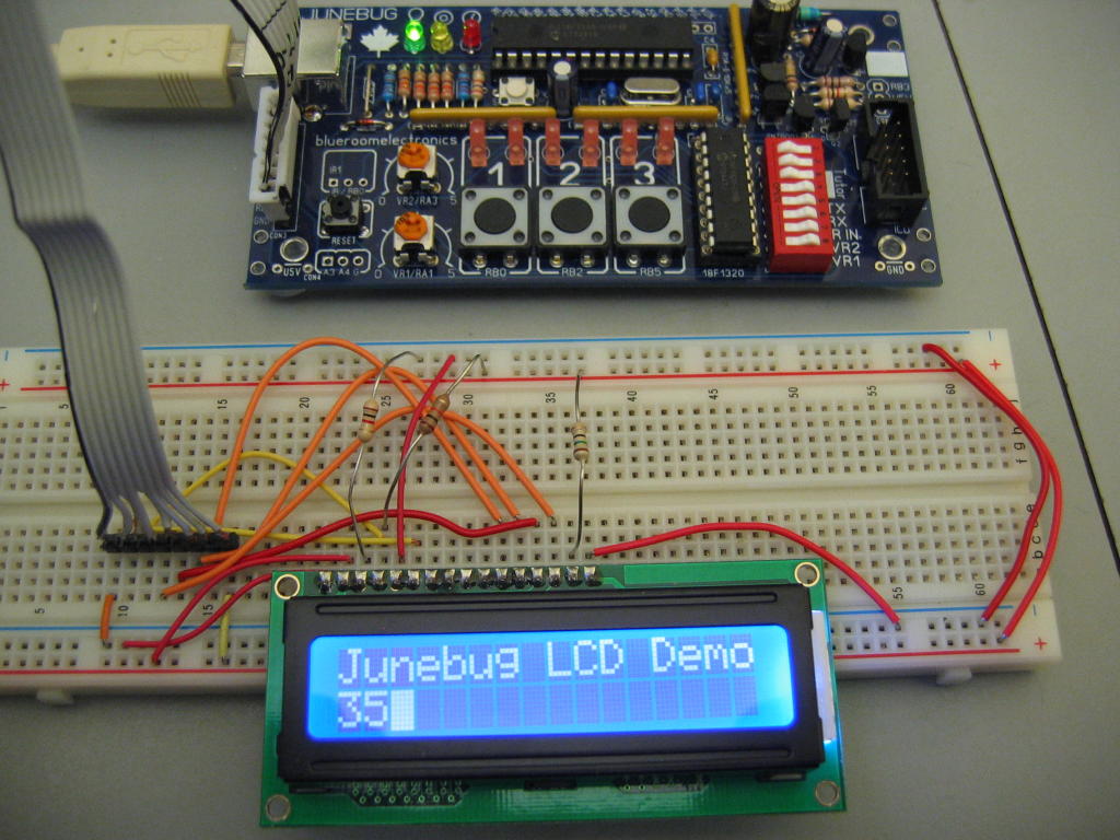

What fun! Got an LCD working on Junebug tonight. :D Ported my 16F88 code and tuned it up for 8MHz 18F1320. If anyone wants asm source just squawk.
Pinout is:
RB1 - RS
RB4 - E
RA1 - D4
RA2 - D5
RA3 - D6
RA4 - D7

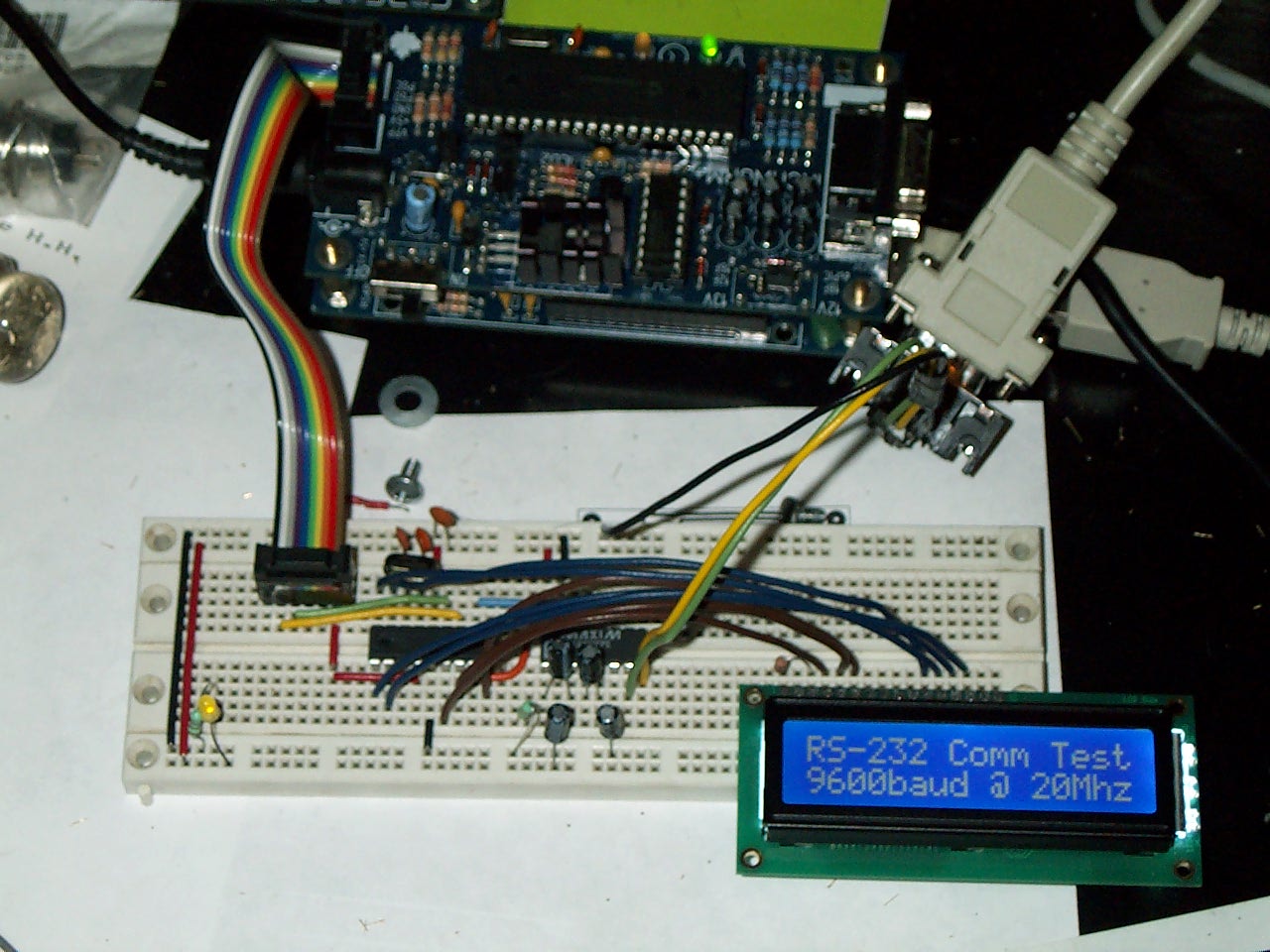

Well, I'll throw a pic of mine up in this thread as well, now that I have it working.
This is an RS-232 communications test between a 16F88 / MAX232 and a PC (my laptop). It's running from the Inchworm+/Unicorn combo, with the LMB162AFC blue LCD.
The reason for the crystal (instead of using INTRC) is that it's running at 20Mhz -- because that's what I'm going to be working with in a near future project.

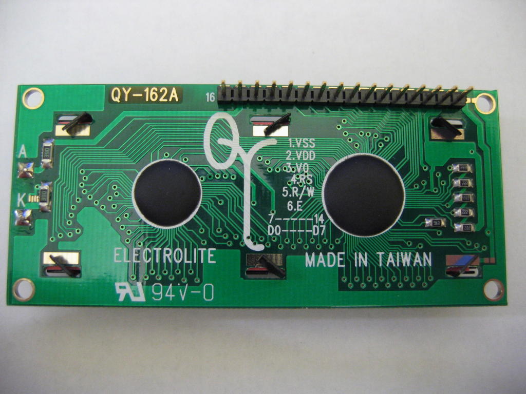

blueroomelectronics said:
Does that LCD use three white sidelight LEDs? The blue ones I use have built in backlight current limiting. They're made by TopWayDisplay.com
I think it's a different one. There's a lit up bar behind the display. Whether it's EL or LED I don't know. I never bothered to get a datasheet. Here's a pic of the back:
For a measly $6.00 they're a very nice display.
