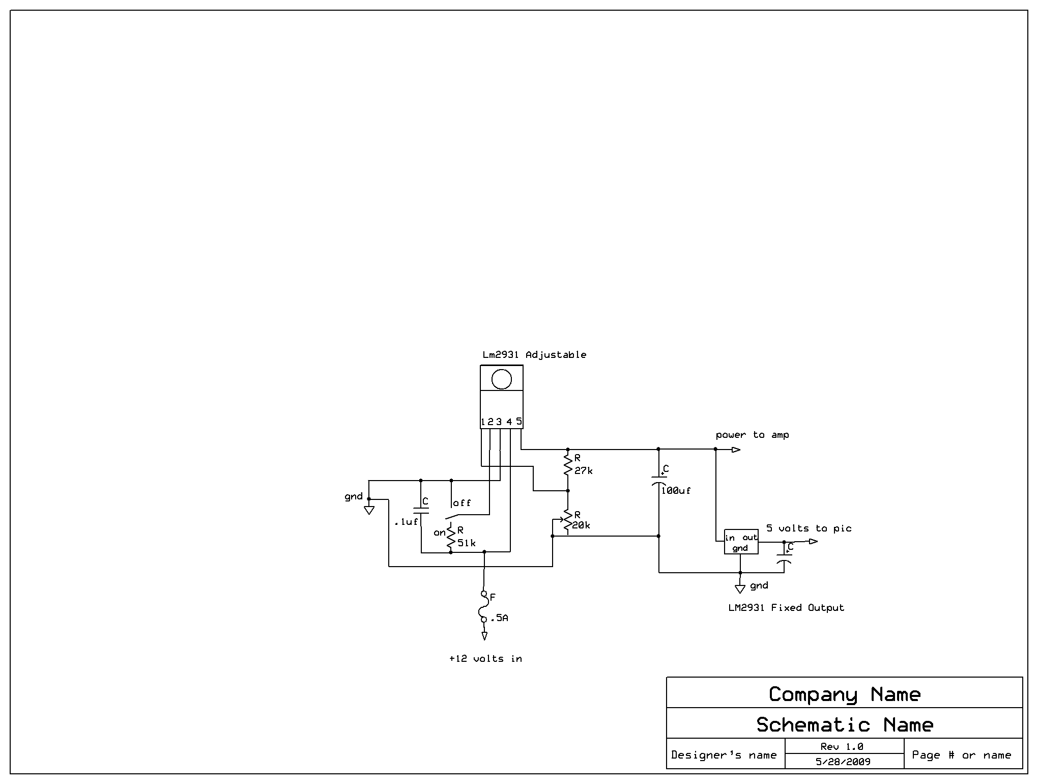

Mrdeb The way you have that for the car you run the chance that the pic can be powered from the amp and that wouldn't be good. You could use this regulator bd3931fp for the pic **broken link removed**

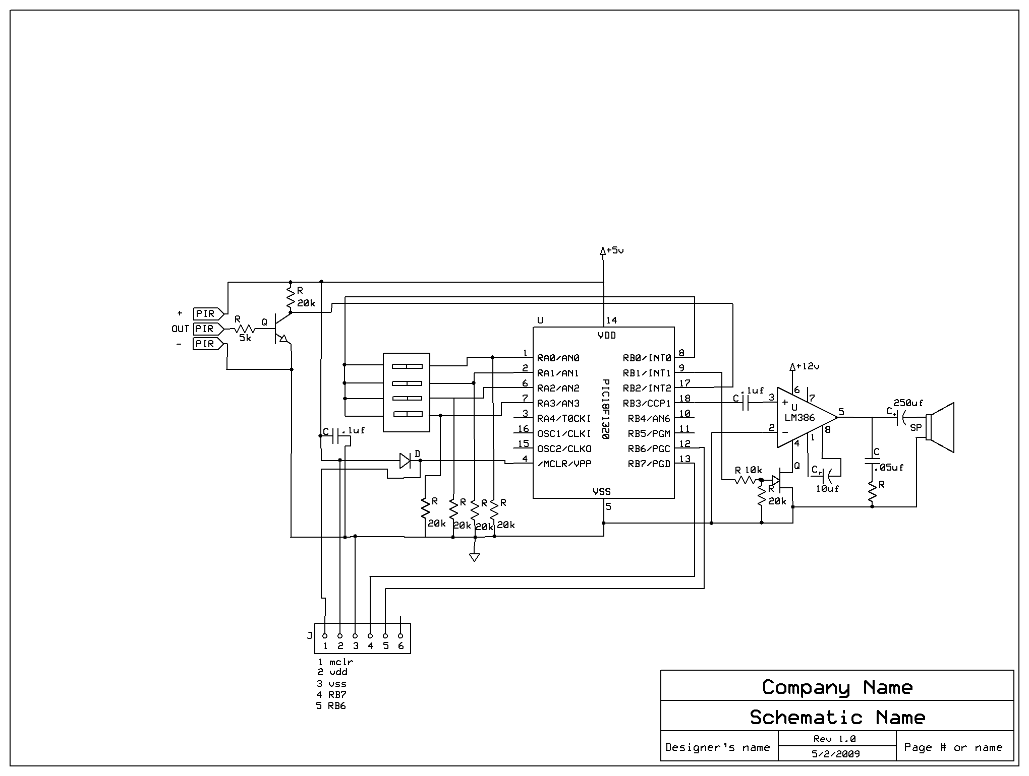

You for sure want to use a capacitor on pin 3 of the lm386 For dc decoupling And you need the pic to turn it on when triggered. Use a Fet
my bad
the schematic for the car should have the transistor to turn it on and off.
the regulator is supposed to be a 12v unit w/ a second regulator or the zener/transistor circuit I posted earlier.
cap on pin 3?? first I herd any mention of adding a cap?
in sewries or parallel with the 10k resistor??

Make sure that LM2937 is a part you can get. Check the ordering information on the part sheet. The last 2 digits of the number indicate the voltage with 33=3.3V, 50=5.0V, and 12=1V. I did not see where Mouser had any 12V version in quanties less then 4000.
Still suggest for 18 cents you can put a 5V LM2931 in place of the zener and related parts.
the NCV8674 output voltage?
data sheet says it will do for 5v or 12v but how does one set it for 12v??fixed
the LM2931 looks like a go at .21 from Mouser
Yes they are fixed output voltage regulators as per the datasheet and my last post. One part with a 12 volt output is TS2937CZ12. Notice the 12 in the last two positions. It looks like you can not get them. I provided a link to a 12V regulator earlier.
or .18 if you buy 25 of them.

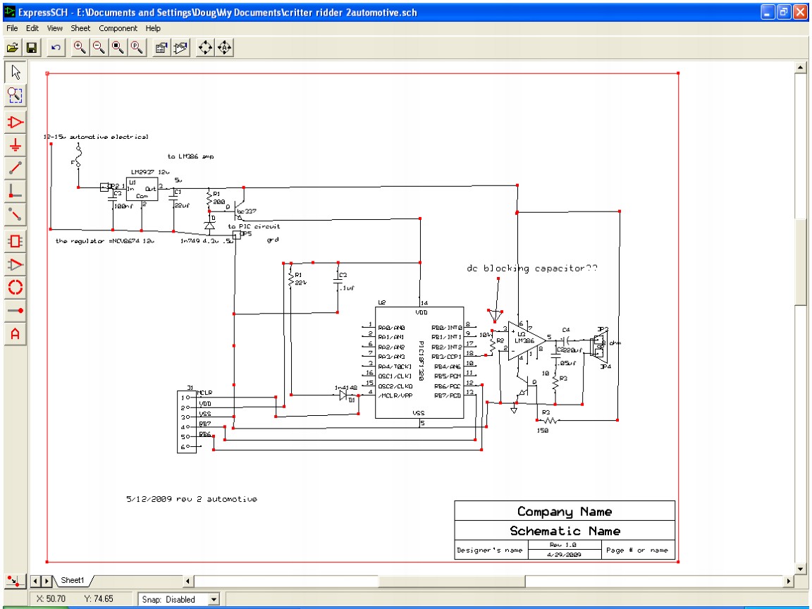

Egadds batman I'm an idiot
I had another PIC go poof!
looked and studied my schematic and see I had the batteries wrong.had them backwards in the schematic. Don't know how I missed it??
I changed the schematic and then it hit me = I have 9v going to the PIC!!!
I measured the voltage at pin 14 to ground =4.5v
pin 6 to ground on the LM386=9v
insert PIC, activate the PIR then POOF
BUT looking at the schematic I have a ground loop so to speak that puts 9v to the PIC
it pays to take several looks at ones schematic.
On the home units I only have 4.5v
on the automotive units I pan on using the LM386 and 12v.
going to run 2 separate grounds ???

I'm sure its going to cry with 14.5 volts going to it in a car. And i'm sure your not going to leave it on when the car is parked. You no what would happen if you put that in a car
and have no current limiting on it and hooked it up wrong A fire.

The sentence I high lighted is not quite true. The additional voltage is know as the drop out. A low drop out regulator needs less additional voltage. Check the data sheet to see what the drop out voltage is and add it to the regulated output voltage to get the needed input voltage.
The LM2937 has a drop out of 1/2 volt so you could easily use the 12V version because cars regulate to 14V when running. The additional 2V might make the sound louder.
will give it a try.
found the 2 voltage regulators.
Something very important that I / we forgot = the regulator needs about 2volts higher than what is needed
