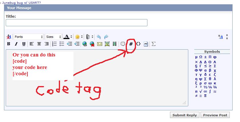

It like this here where and how to use code tags
like-this-jpg.54506
First I have to say up front I am a bit cranky just now.
But MrDeb! I would bet dollars to donuts we showed you how to use code tags back when you first started work on the deer repellent project for the boy scouts.
But then again we all forget sooner or ...what was that word ?
