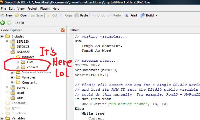

the first code does not use the OW.bas. You missed the // (in my trial and errors I leave code as is but add //. In this case I added the OW.bas and then // disabled it.
Been fiddeling w/ the code that works using only the OW.bas
The code starts out right in cool water(need to make some ice but lost the recipe) but then it tells me I have 120F temperature after inserting in under my tongue.
I notice the red LED on the Junebug flashes with the OW.bas but not the DS18B20 .bas???
with 120 temperature I must be in hell---LOL
LOL it's there you just haven't learn how to use the ide
its-here-jpg.54537
Well blow me down, learn something every day--THANKS
