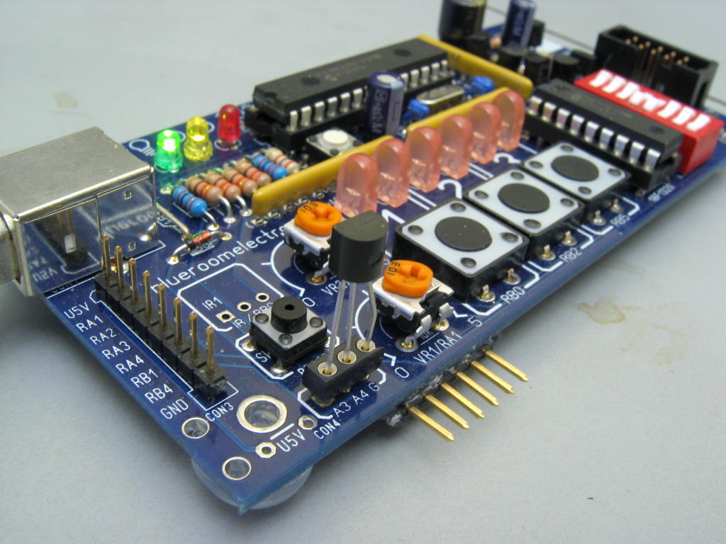

Here's some pics:
Since I didn't build my Junebug from a kit I didn't have the fancy 3 pin socket for CON4. Instead I cut up an 8-pin machine pin IC socket and soldered 3 pins of it in there. In the end it's the exact same thing, only less finished looking on one end. :)
The "fancy 3 pin socket" is just an inline machine connector cut down. Same as yours :)
You can control RA3 depending on VDD, GND, float or even analog VR2 can be switched in.
I like the rocker switch :) I'll have to find some.
