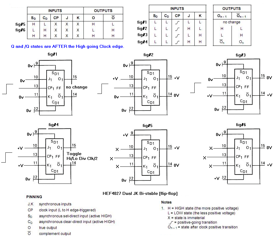

The 4027 is CMOS technology, you must connect the Set and Reset pins.
I am trying to attach a drawing without success.! sorry about that. Connect the Set and Reset to 0V.
Also, connect all unused inputs, including those on the unused FF, to ground or Vcc. Vss must be connected to ground.
Note that I did not say anything about outputs.

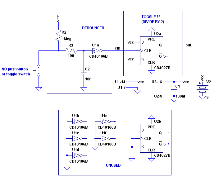

Here's a circuit that will cause the output to change state every time the switch is pushed.

YYYYYYYYYYYYYYYYYYYYYYYYYYYAAAAAAAAAAAAAAAAAAAAAAAAAAAAAAAAAAAYYYYYYYYYYYYYYYYYYYYYYYYYYYYYYY !!!!!!!!!
THank You so much u eased my pain IT FINALLY WORKS FLAWlessly
but i only used the debouncer switch to make it work
Sir Roff now u gotta explain how does this debouncer really work and plz provide some equations to calculate R1 and Capacitance. The de-bouncer circuit u made, is this the only configuration or there r plenty others?
