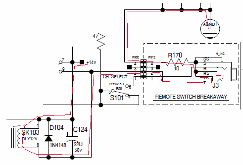

They Call it a Remote switch Breakaway: Take a look
https://www.google.com/search?q=peav....0%3B491%3B333
Why do they use a Sleeve Shunt also? for the REMOTE BREAKAWAY SWITCH?
Why would they have a Switch inside the jack to have the Sleeve isolation point NO when a plug was inserted into the jack?
Mostly I see jacs that are Tip , Ring , Sleeve, Tip Shunt NC, Ring Shunt NC

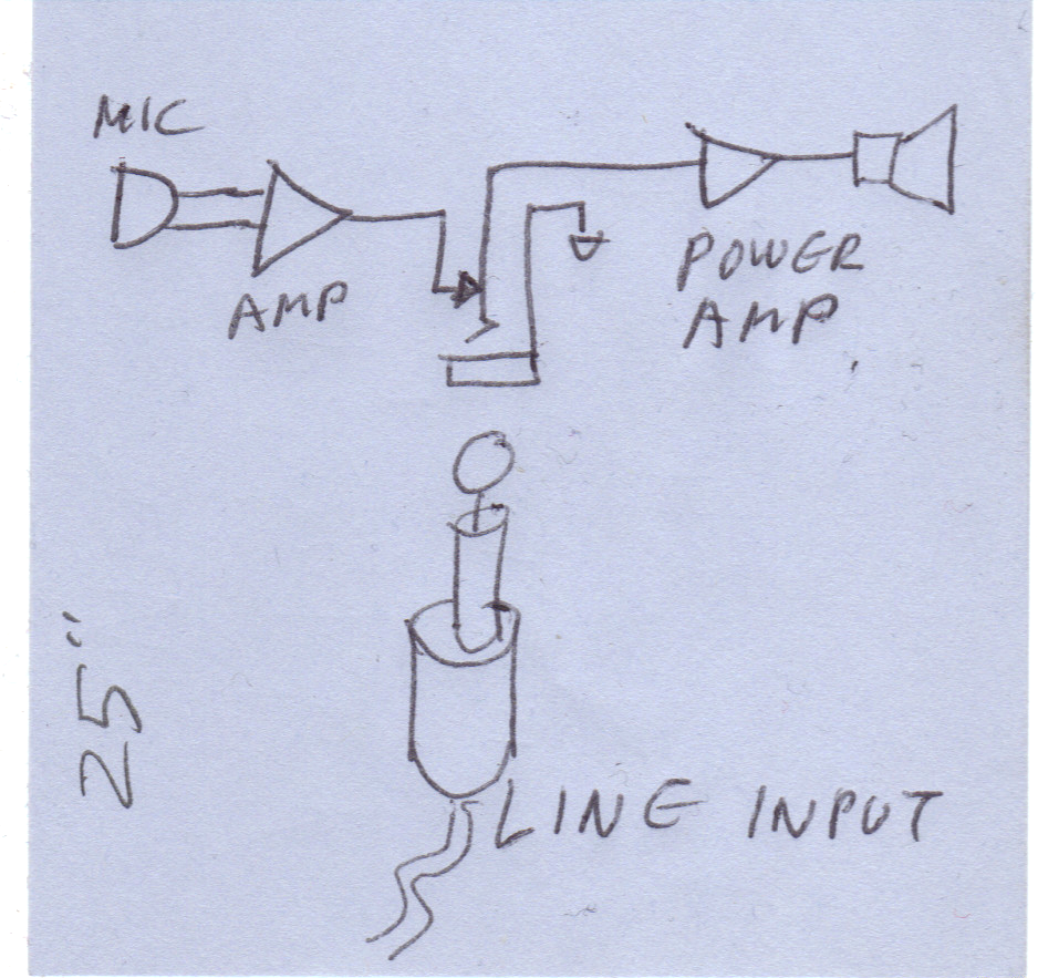

What is the Transfer switching used for?
I have a amplifier. There is a place to put in a microphone. There is a mic preamp. If I want to not use the mic but send in 'line level' audio I plug in after the preamp. When the plug is in it breaks the preamp connection and sends audio directly into the power amp.

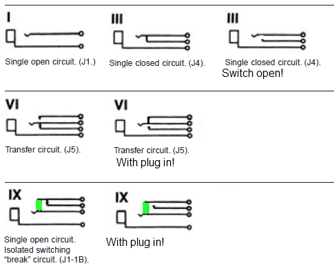

What is the Isolated Switching used for?
Used when a battery radio can run from a wall wort. The adapter, when plugged in, disconnects the battery.
So the Transfer switch , BREAKS the path or stage that is before? is this how it is always used?
It can be used any way you can you can think of. I usually see it to break one signal and inject another. (like you say)
It's hard for me to tell the difference between a SHUNT switch , Transfer switch, Isolated switch
They all look the same to me
How do you guys tell the difference between a SHUNT switch , Transfer switch, Isolated switch? They are all these different kinds of jacks
III shows (with out/with) plug. Note the switch position.
VI shows (with out/with) plug. Note the switch position.
IX What is in green is a insulator. It pushes on the switch with out connecting to it. Note on the right the switch is open.
>It is hard to see but......
>I think there are switches on TIP, RING and SLEEVE.
>When there is no jack, the TIP is shorted to ground and the RING is shorted to ground. The SLEEVE switch (I don't understand) the schematic is strange but I think it is shorted when there is not jack. It is not used! So don't worry about it.
>When the jack is in all switches are open.

Yes , the switches are shunts right? for the tip, ring and sleeve, they each are shunted to ground right?
I know the R170 , 10 ohm resistor is a ground loop resistor, I'm guessing the 10 ohms lifts the ground potential up to a DC offset voltage?
R170 , 10 ohm resistor: is a ground loop resistor
1.) The Relay and the Jack go through the 10 ohm resistor to ground
Why go through a 10 ohm resistor?
When the Plug is in the jack, the Tip, Ring and Sleeve are NO normally Open , not grounded
The Double Closed Jack doesn't have the Shunt for the Sleeve
I guess it would be called a Triple Closed Jack
1.) Tip Shunt to ground
2.) Ring Shunt to ground
3.) Sleeve shunt to ground

The Double Closed Jack schematic has a different 5 pin out than the Peavey Remote Breakaway Jack
Double Closed Jack Pinout:
Pin#1 is Ring
Pin#2 is Ring Shunt
Pin#3 is Tip
Pin#4 is Tip Shunt
Pin#5 is Sleeve
Peavey Remote Breakway Jack, " Triple Closed Jack"
Pin#1 is Tip
Pin#2 is Tip shunt
Pin#3 is Ring
Pin#4 is Ring Shunt
Pin#5 is Sleeve
The Pin outs are different right? is the PCB jack is made for that pinout it can't be a replacement for it
