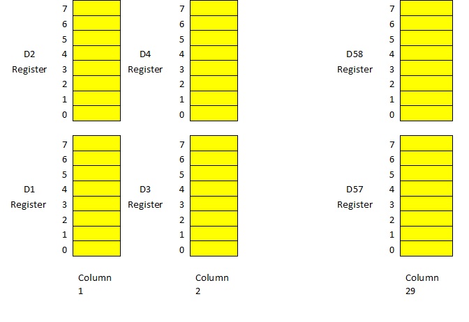

Hi Mike
See the attached RAM locations I have placed (In my Post 10).For the 1st eight rows the last RAM location is 68h. From Row 9 to 16 the last RAM location is 69h. My CBLOCK starting from 30h. Below is how LEDs arrangement to RAM locations.
31 33 35 37 39 3B 3D 3F 41 43 45 47 49 4B 4D 4F 51 53 55 57 59 5B 5D 5F 61 63 65 67 69
30 32 34 36 38 3A 3C 3E 40 42 44 46 48 4A 4C 4E 50 52 54 56 58 5A 5C 5E 60 62 64 66 68

You can still preload it and increment W in the relevant sections. Won't save as much but still 22 locations.

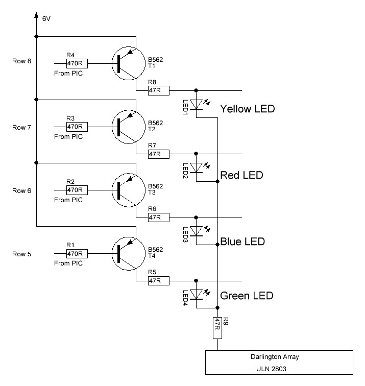

Hi Mike,
I have a brightness problem with my 16X29 LED matrix. Here how I fixed my LED's. Green & blue needs 3.2V to make it to light up brightly compared to Red & Yellow.
Row 1 - Row 4 = Green LEDs (Per row 29 LEDs)
Row 5 - Row 8 = Blue LEDs (Per row 29 LEDs)
Row 9 - Row 12 = Red LEDs (Per row 29 LEDs)
Row 13 - Row 16= Yellow LEDs (Per row 29 LEDs)
Attached drawing is the blue colour LED driving stage (Row 5 - Row 8), The drawing shows only a single column to easier understand.
Planning to use 6V to feed row drivers instead of 5V. Because with a 5V anode rows the blue LEDs won't lit.(I guess that due to saturation voltages + resistor drops it cannot supply 3.2 to blue LEDs).
I short circuit the series row resisters & checked, now the blue LEDs lights up but its bit of dim.
Is there any way to light up BLUE rows with the same 5V power supply with a descent brightness? Or do I need to make my VDD to 6V?
Note that: I cannot find any high current column drivers & anode FETs. So this must use with BJT's, ULN2803 & 74HC595 stuff :)
