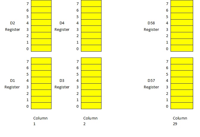

Yes you are correct.I'm feeding to four 74HC595 registers on a cascade arrangement.I'm doing a 16 row 29 column design.Anode row method , 1/16 Duty Cycle :)
Below how I placed registers.
D2 D4 D6 D8 D10 D12 D14 D16 D18 D20 D22 D24 D26 D28----- D58
D1 D3 D5 D7 D9  D11 D13 D15 D17 D19 D21 D23 D25 D27----- D57

Here is the register map how I placed with more details.

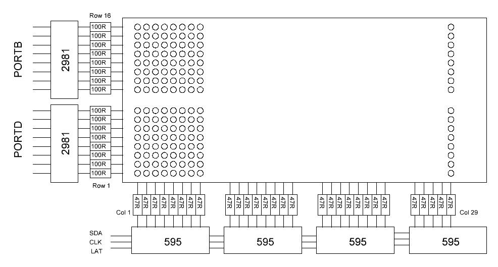

Here is the diagram. Anode Row Design.
Each row has different colour LEDs. I use unbranded chinese LEDs. With a 10mA current the bright is awesome.Not sure the 100R anode resisters are too high...!!!

I got a hardware problem with my design. Its an anode row design.But there is no transistor array to the column shift registers. To turn OFF a bit I should send logic 1 to those shift registers causing most off the columns have 5V which will turn ON leakacge LEDs ( leackage current is passing through UDN2981 inside protection diode to GND). I burned many of cheapy leds while checking. Also many of Leds are lighting dimmly.
Going to use transistor arrays to each shift registers.
Whats your comments guys to make this display smoother with an even brightness?
