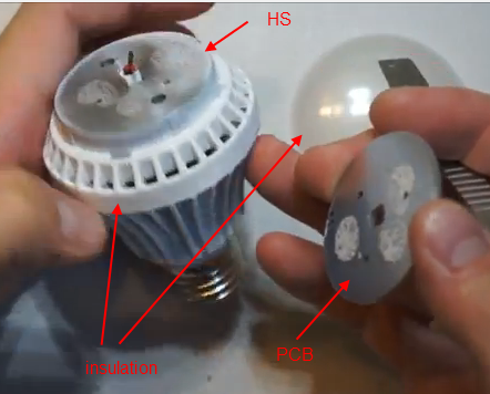

See the pictures.
HS=is the heat sink.
There are two types of insulation.
.....A clear dome.
.....White plastic with vents that covers up the heat sink. The white is not a heat sink. It is plastic.
PCB..... It has isolation between the LEDs and the underlying aluminum. There probably is primary to secondary isolation here.

I have had my products tested by UL, CSA, VDE etc. There is no way a person can touch the power line. OR even get close to the power line.
think of the thickness of the insulator on top of mcpcb.
Now think of grabbing a sheet of that, and touching live mains with your finger the other side of that microns thin sheet.
That same insulation is in every power line switching power supply with a transformer. Your cellphone charger has the same insulator. Your plug in the wall CD player....
The last transformer I designed with stood 10kv for 10 minutes with out failure. If you knew how thin the layers of insulation is you would be more unhappy. Just because you don't understand UL or insulation does not make it illegal.

To me the substrate (Round disk) that the LED's are mounted to looks like a foil backed piece of ceramic which if so in itself would provide more than adequate electrical isolation from the circuitry to the heatsink without compromising any thermal transfer efficiency. :rolleyes:
..its not foil backed ceramic, its mcpcb, its alu all the way through, apart from a few microns of insulator
And your point is? :rolleyes::banghead:
You are aware that even the lowest rated insulating materials they use on MCPCB (metalized paper) is rated at 500< volts per mil and the thinnest insulator ratings I could find for any listed MCPCB was 3 mils which give it a minimal rating of some 1.5+ kV isolation just on the MCPCB itself?
What I am finding online is that the vast majority of MCPCB's designed specifically for line powered LED type applications have isolation voltage ratings of some 3000 - 7000+ VAC which is ~15 - 30 times the typical line voltages are anywhere in the world!
The next thing I see in the video is that the heatsink is not bare aluminum but appears to be coated in an epoxy type coating which in itself adds even more insulation between the lines and the person holding on to the assembly. BTW typical epoxies also have at least a 500+ volt per mil dielectric rating and most tend to naturally cover to at least several to 10's of mils thickness when cured.
