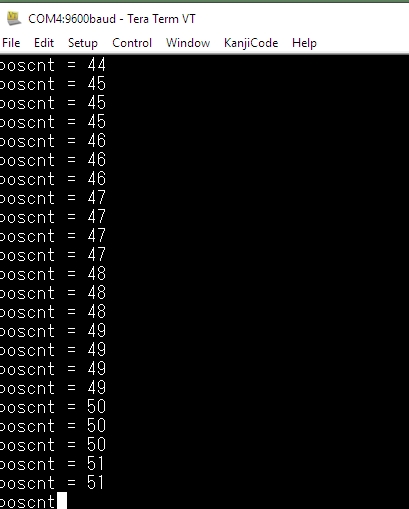

Is this Incremental encoder working?

If you're using a pic with internal pullups then you can connect the sensor outputs to the pic inputs and turn on the weak pullups. Or you can connect a 10k resistor from Vdd of the pic (3.3V) to the pic input pin. The encoder would, of course, still need to be supplied with 12V.

Yes, but no need for that low (I wouldn't dream of using such a low value) - the internal pull-ups should be fine.
However, there's been a lot of crap in this thread about zeners and extra resistors, none of that is required.
The output of the encoder is O/C, so (as Pommie said) you simply power the encoder from 12V, BUT the pullups go to the 3.3V supply of the PIC (or you simply enable the internal weak pullups).

1st July, and I've finally added the ENCODER into my transmitter, and it is incrementing as it should :)
NOTE: The voltage seems to be a bit critical. >5V

As mentioned you need a pullup resistor between the A output and Vcc and the B output and Vcc. It should work fine with a Vcc of 5 Volts but you can up that and as the name implies you should get 360 pulses per revolution or a pulse for each degree of rotation. The output would be measured at the A & B outputs which have the open collector pullup resistors installed. That's about all there is to it.

Remember the pullups need to go to the pics Vcc especially is the pic is running at 3.3V.
Hi R and M,
I have pullups to 3.3V.
The Encoder is working on APP 10V, and the PIC at 3.3V and working well and counting up 0-359
Thanks, C.
