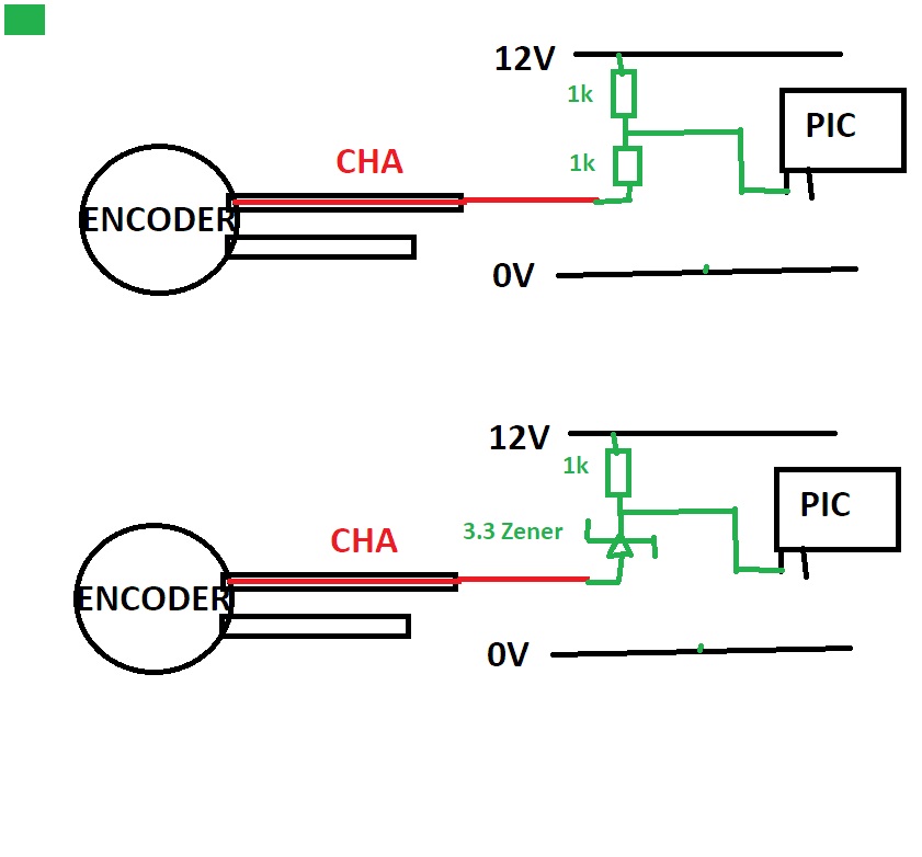

Hi C,
Are these two drawings correct?
Which one is best?
I have some 3.3V Zenere diodes.

No.
The anode of the zener needs to go to GND (0V). The encoder output connects to the zener cathode with the resistor and the PIC pin.
If you use a resistor divider, the bottom of the lower resistor goes to GND. the encoder goes to the midpoint. And if the upper resistor is 1K, the lower resistor needs to be 374 ohms to make 3.3V at the junction.
Why not just have encoder output - 10k resistor - pic input - 3.3k resistor GND.
Edit, or replace the 3.3K with a 3.3V reverse biased zener.
Chris, are you assuming the outputs are OC? 12V directly to the zener (or pic pin) could produce a large current. Or did I misunderstand?

Mike,
Yes, this thread started with the OP asking why he got no output from his encoder. The first few posts established that the outputs were OC.
