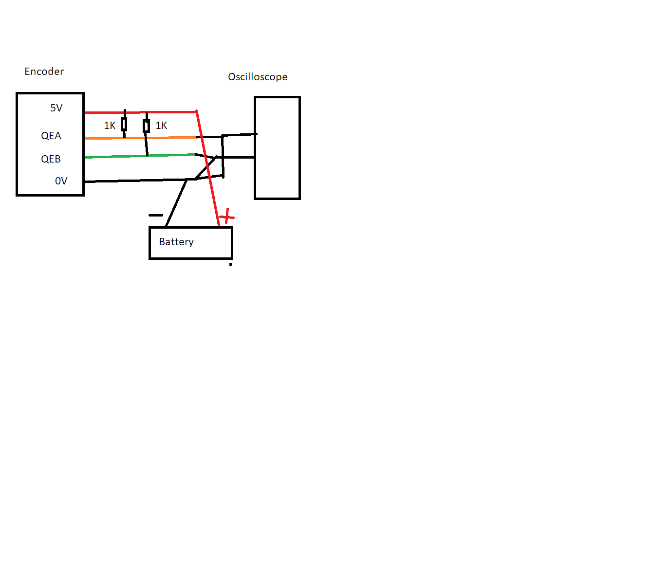

Is this Incremental encoder working?
It states open collector, in this case you have to provide a (1k) pull-up in order to see a signal.

Hi M,
Like this:

I tried a test, wiring as #3 with 5K resistors instead of 1k, but still no signal.
Any other ideas?

You should also be able to see a distinction by using a meter from the 0v to either output, turning the shaft as Slowly as possible should show the signal varying.
M.

What logic state are the outputs locked in with resistors in place? HI or LO?
Try measuring reistance between each output and ground with no power or resistors. If they measure low resistance then someone blew the output transistors by connecting directly to Vcc.

Hi D,
Meter Black, to 0V, RED to output OPEN CIRCUIT
--------Black to +V, RED to output OPEN CIRCUIT
--------Red to 0V, BLACK to output 1.8M
--------Red to +V BLACK to output 26M
