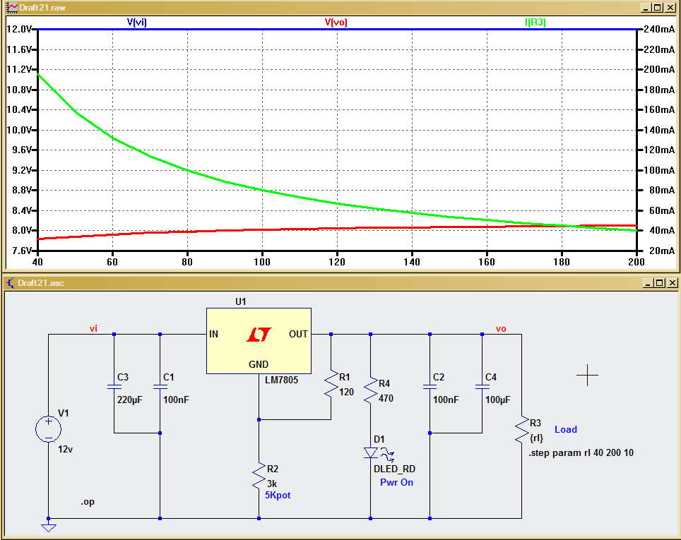

If you can get a 7805 Vreg its easy, using two resistors to change it to +8Vout
EDIT:
Look at this image. The R1 and R2 are the two extra components [ the other components are part of the test circuit].
The regulation at 8V is not as good as it would be for 5V, but will be ok for the circuit it is powering as shown in your posted link.

The circuit will work fine with a supply that is anywhere from 5V to 9V. Use a 78L05, 7805, 7808, 78L09 or 7809 regulator for it.
Wouldn't it need some work on the dividers and the drive for the output stage at 5 volts?
