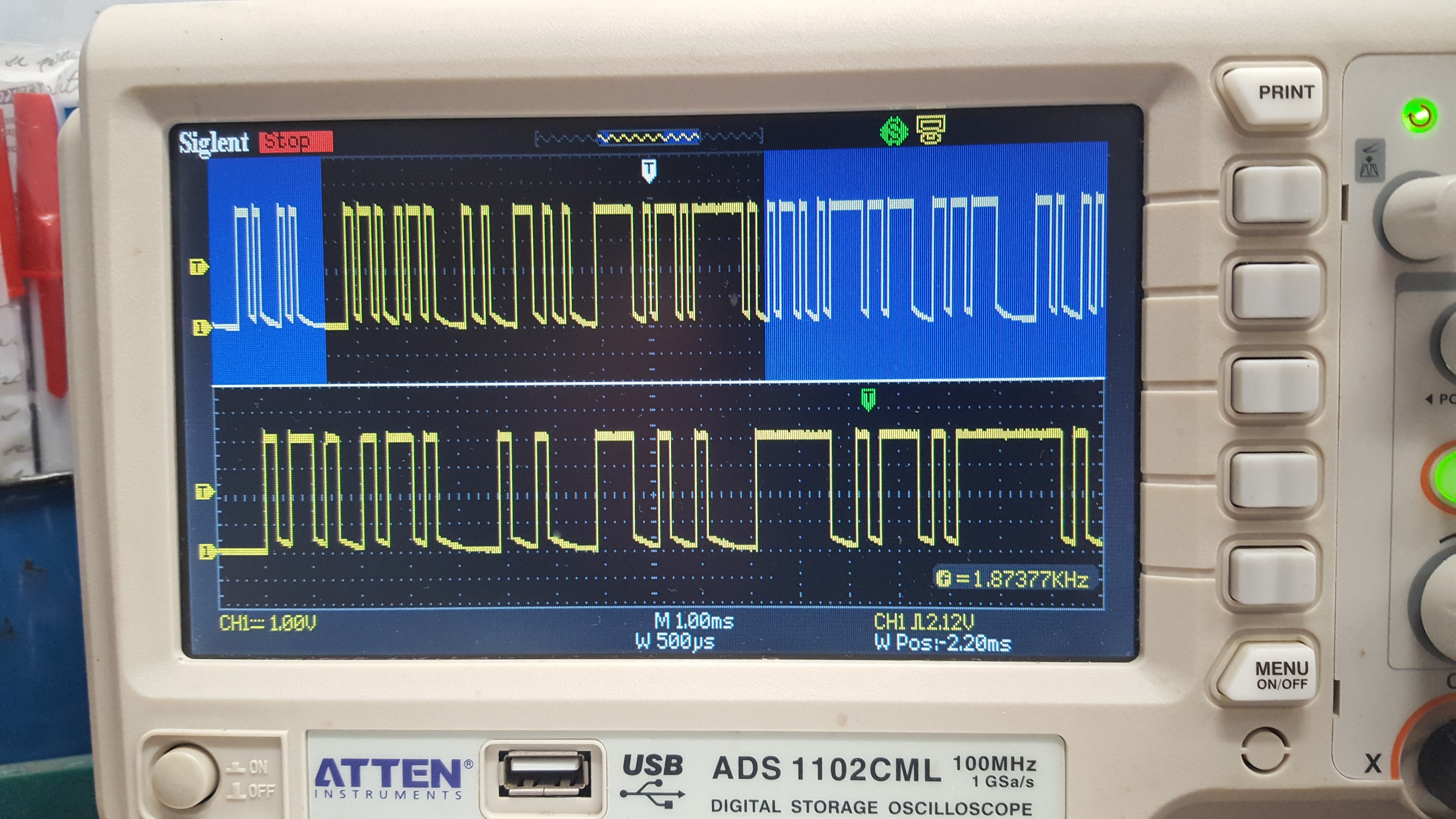

D- is at a dc level of 1.6v all the time ... whether a tag is present or not.

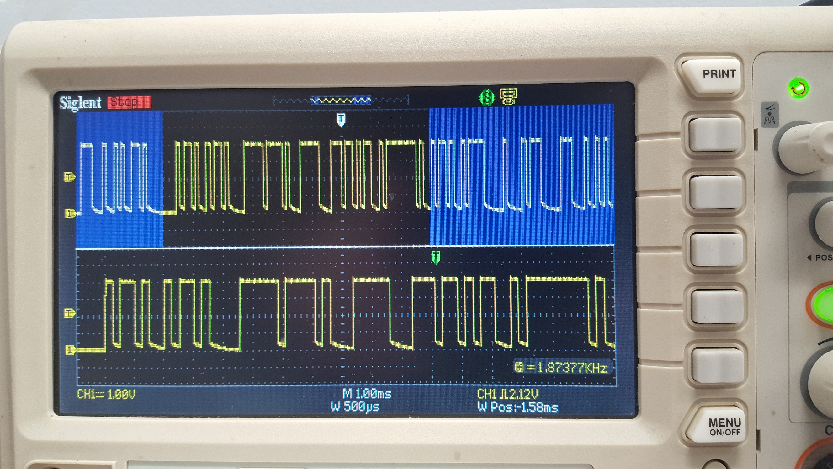

This is the waveform seen on D+ when a tag is near the antenna ... not quite 4v p-p.
If it's 125kHz RFID, it's eather Manchester encoding or BiPhase encoding.

What I notice with that is the same pattern being sent repeatedly, but alternately inverted.
A long "low" appears to be a sync marker (5A 5A or A5A5, depending on polarity). The next block with the pattern of fast transitions a framing code to define the start, then about 40 - 42 bits of data before the pattern repeats inverted.
It's not manchester coded, just straight binary as far as I can work out, as a single long burst.
Manchester must have a transition every one or two timeslots, like in the sync section - but that does not carry on in to the data.
It's also not RS232 format as there are no regular stop/start bits (& that does not work inverted anyway).

Also, can you speed up the sweep slightly and adjust the timing so the bits exactly match the graticule markings? That would make it much easier to decode by hand.
You got all that from one photo ... I'm amazed. I'm feeling a bit inadequate right now. :)

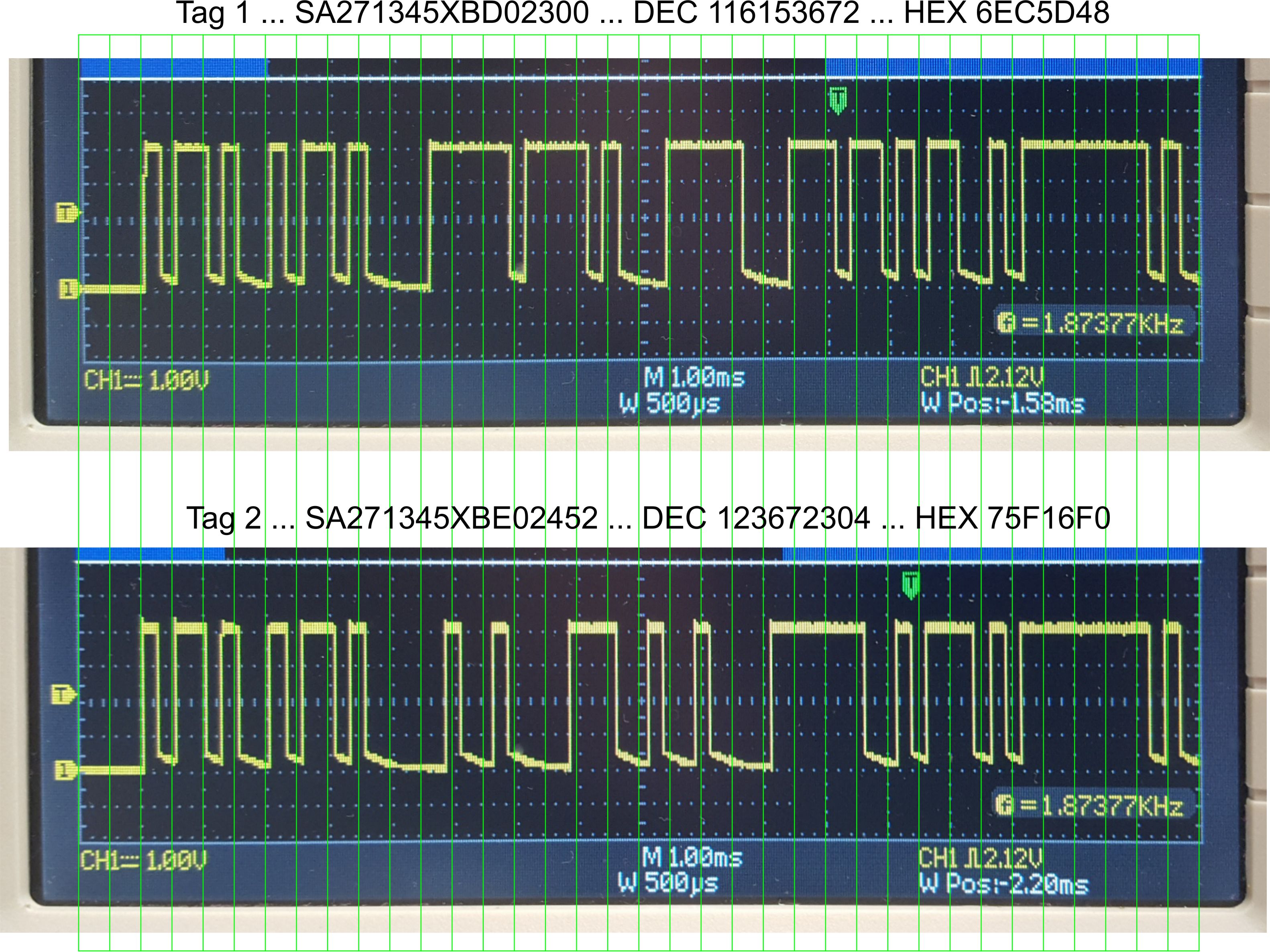

Ok ... so this first photo is of a tag ... SA271345XBD02300 ... DEC 116153672 ... HEX 6EC5D48
I believe the first number is simply the printed number on the front of the tag which has no relation to the RFID code inside ... so I don't think you'll see any connection there.
Photo of a second tag ... SA271345XBE02452 ... DEC 123672304 ... HEX 75F16F0
In comparing the two images I see I captured two identical sections ... I'll have a play and see if I can trigger it elsewhere to grab the variable sections.

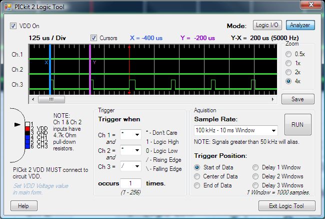

If you happen to have a PICkit 2 programer (Microchip) or clone, the logic analyzer with the stand alone GUI may be helpful. It will capture 3 channels with a large data buffer for a long record. A less than $10 clone might be a worthwhile investment.
Once again ... Tag 1 ... SA271345XBD02300 ... DEC 116153672 ... HEX 6EC5D48
I've changed the window section to 500uS to get more in.
And Tag2 ... SA271345XBE02452 ... DEC 123672304 ... HEX 75F16F0
Mmm ... I have a PICkit 3 ... and a handful of other programmers. I understand the value of capturing a large string of data ... can you expand a little please.
Yes, no argument there.
If I can make some progress here ... I have a heap of other equipment I could test more fully when I work on it.
Unfortunately, Microchip in their infinite wisdom eliminated the logic analyzer and UART tool from the PICkit 3.

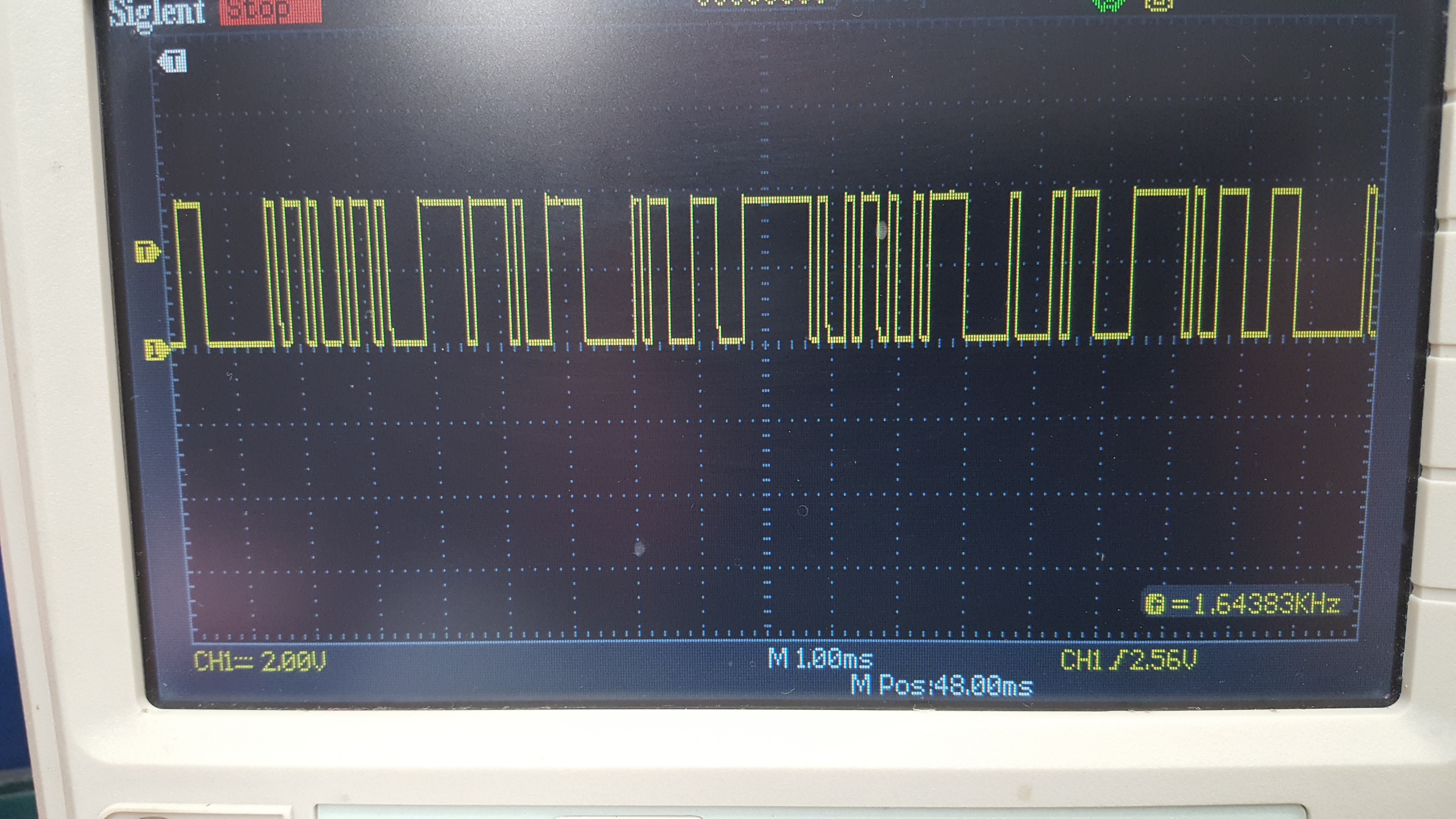

A little off topic, but a quick trick with the PICkit 2 is to set up a software UART to use the ICSP pins to monitor program operation during dev. Have the code send messages at key events or pertinent data.
Load the code, then switch to the PICkit 2 UART tool to monitor program execution without having to change any connections.
I may have to order one of those logic analyzers Nigel. At that price it's too cheap not to have one of those in your kit just in case.
I've spent a couple of hours working through those displays & values, but nothing definite yet.
One has a lot of correlation between the data and the hex value - but reading the other in the same way has next to none...
What are the decimal numbers visible around the tags in one of the early pictures - are they the same things you are reading? The numbers you give do not seem to match that format.
