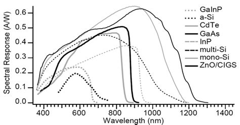

Solar cells have a spectral response that includes infrared -
Not sure how effective/efficient it is though.
