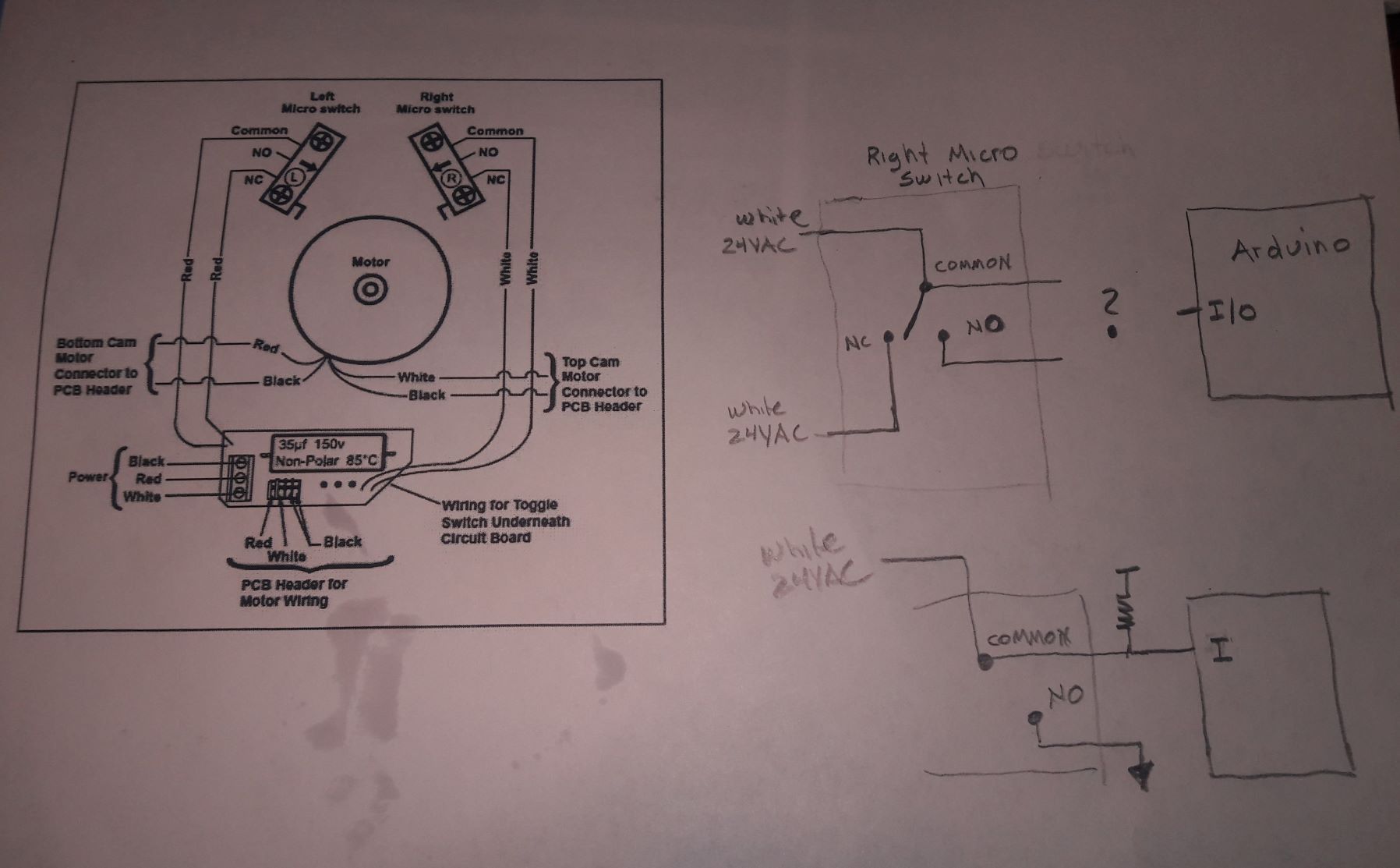

I am working on a pool controller project using an arduino-like microcontroller (particle.io Photon). I am a many-year retired EE who never worked with AC circuits, haha.
I am trying to figure out how I can get feedback from an existing pool valve switch to determine position information about the valve itself. There are unused (NO) connectors on the microswitches inside the valve actuator itself, that become closed (connected to common) when the valve is in either the right or left position. I would like to be able to read if the switches are open/closed whether or not there is 24V AC on the white wires.
To the right of the valve diagram is my conundrum...below that on the right is a simpleton's version of what I would like to do, but probably not possible due to the fact that there may or may not be AC voltages on the white wires.
I hope this makes sense...Thanks again.
If you can live with a 40mS delay then a resistor and zener will give you a suitable signal. Is the arduino running at 5V?
Edit, if you can safely ground the AC voltage then your idea should work.

DrG, thanks...I can see how those chips would be very useful to do what I want (with their AC input side connected between common & NC) ...IF the 24V AC signal stays ON the white wires when the micro switch is opened. I suppose I was hoping that after I turn the valves to a position, I could shut off the AC power supply as well and still "read" the valves' positions. I don't think that's how my commerical controller works currently, it leaves the AC voltage ON. So I may have to live with that.
Mike, I can live with any sort of delay. These valves move in slow motion and I am only wanting to read their end position to confirm it, and monitor that there has not been a failure in the valve mechanism/motor/etc. Does your method also rely on keeping an active AC voltage on the white wires? My photon is actually a 3.3v device but is 5V tolerant.

My advice would be to use an opto-isolator to pick up the AC signal from one of the micro-switches.
Or, if you want an indication which works in the absence of the 24vAC supply, maybe you could fit an extra micro-switch on top of one of the existing switches. ie using the same mounting screws.
This of course assumes that there is physically enough room to do that.

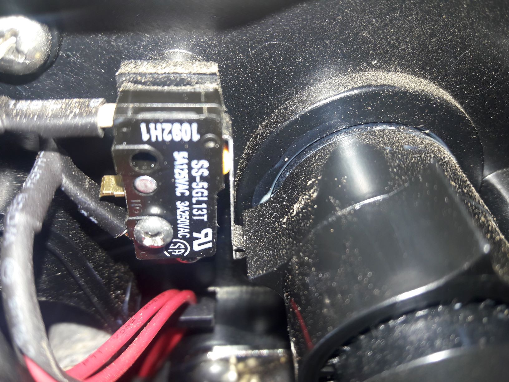

Jim thanks...I hadn't thought of the "mounting on top" idea and went out and took some pictures. It looks like that is very possible. The "cams" that actuate the micro switches are actually double wide and both would support another micro switch. I really like this idea because then I can avoid AC circuits entirely, haha.
I will look around to see if I can find this same switch and/or if they make a "dual pole" version of it that would mount with the same screw hole.
Thanks for all the help everyone...I did order these...not exactly the same mechanism on the end but I think they will work (ones exactly the same would take a bit more time, or cost a lot more, haha...and I am pretty cheap). In addition, they are cheap and I can get them relatively quick to try. I'll let you know how it works out!

An update...I received my new switches a couple days ago and installed them yesterday. The install was problematic because there was actually no good way to install the micro-switches on top of the existing switches without permanently impacting the current implementation.
So instead, to avoid permanent irreversible changes, I stacked TWO of the new micro switches to replace each existing micro switch. Super glue was the only viable method I had to stack them on top of each other (special screws have been ordered). Bottom line: it works, I now have a separate DC circuit path for my “arduino” read of the valve status.
BUT, I don’t like these cheap switches and decided immediately that these would not be the permanent solution...and will order OEM replacements. It was an interesting and relatively easy test case, but these cheap switches would probably introduce more problems than they actually help resolve. So the project is not done yet...
