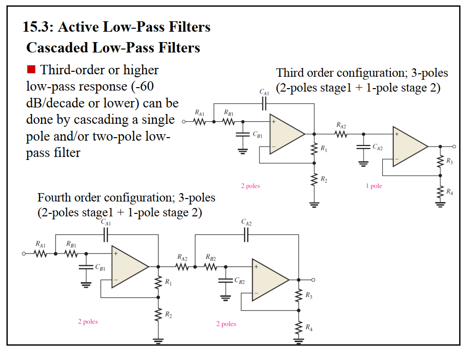

I am TRYING to build a 5 band audio spectrum analyzer for my car. I'm still in the design phase, working out resistor & capacitor values for the bandpass filters. I've chosen to go with 3rd order(single op-amp) Sallen Key low pass filters cascading into a 3rd order(also single op-amp) Sallen Key High pass filters due to their steep roll-off and flat pass band characteristics, but also reduce the component cost, complexity & real estate needed for the circuit board layout. I intend to use one quad op-amp as a buffer, and a single quad op-amp for each bandpass (this is going to be a stereo display, with left & right being handled by each half of the quad op-amp). This way I'll only need a total of 6 op-amp chips. I've found numerous websites to help me calculate the low pass & high pass filters, yet most of them spit out insane values that I don't possess in my assortment kits.

A properly designed audio filter does not oscillate.
You need a filter with parts values that produce a sharp corner and a flat response before or after the filter that is called Butterworth. I cannot remember what is its "damping" number.

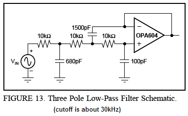

The 1st stage of a Sallen-Key 3rd-order filter does not have an opamp with R1 and R2 setting its gain. Instead it is passive.

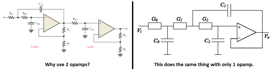

Prior prior post was based on this, a cascade of a 2 pole active and a passive (Ra2, Ca2) -
The order of stages, in this topology, 1 passive pole first or 1 passive pole last, is irrelevant.
Unless of course one is taking output at intermediate stage as well as output stage, for
some other purpose.

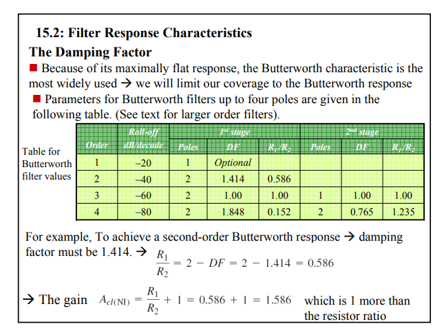

A Butterworth filter has the RC values producing critical damping that has a flat response and a sharp corner.
A 2nd-order Bessel filter with a gain of 1 has equal RC values producing over damping with a drooping response and a gradual corner. Adding a 3rd RC to a Bessel Filter makes it more droopy.
A 2nd-order filter with equal RC values can have a gain of 1.586 to have a sharp Butterworth response.

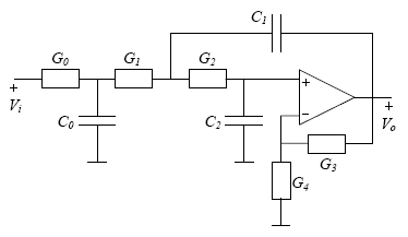

I have never seen a 3rd-order Sallen-key filter with an extra opamp.

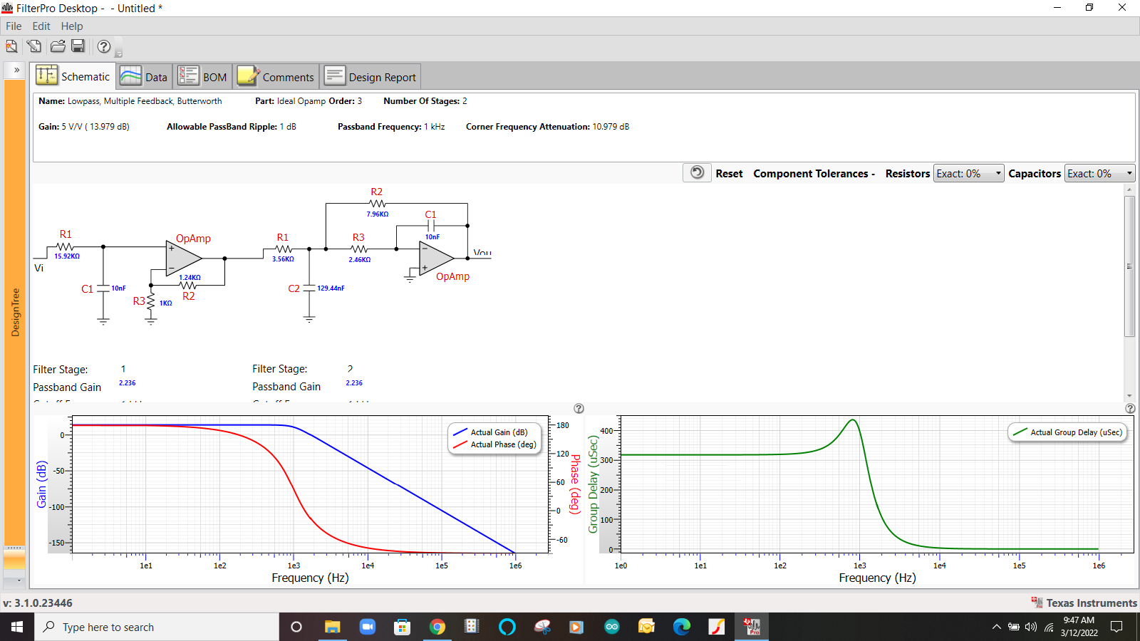

Looks stable, example G = 5. But design is not your freq.....
Number tools refed in article - https://www.edn.com/a-sallen-key-low-pass-filter-design-toolkit/

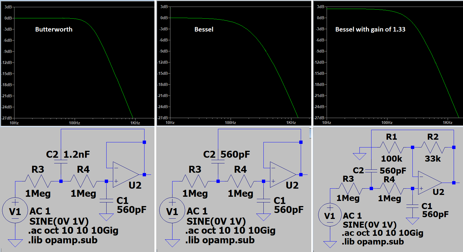

So what is the difference between Bessel & Butterworth? Both look the same in that the resistors & caps are placed identically. Is it the math? The values of the caps &/or the resistors? I don't understand.
When the opamp gain is 1, a 2nd-order Sallen-Key Butterworth filter has the feedback capacitor value for a lowpass filter twice the value of the capacitor to ground, or the feedback resistor for a highpass filter half the value of the resistor to ground.
When a Butterworth filter or an equal values Bessel filter has gain then there is a peak in the frequency response that oscillates when the gain is a little higher than 3 times.
Well then, the answer seems obvious. To avoid instability, ripple or oscillation, any gain desired should be outside the filters, either in the buffer stage or afterwards. Since I intend to keep all the filters at unity gain, it shouldn't be a problem.
