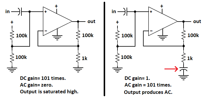

Is this what you are talking about?
Yes it doesn't look anything like textbook examples.

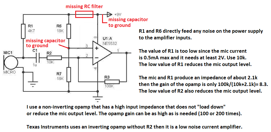

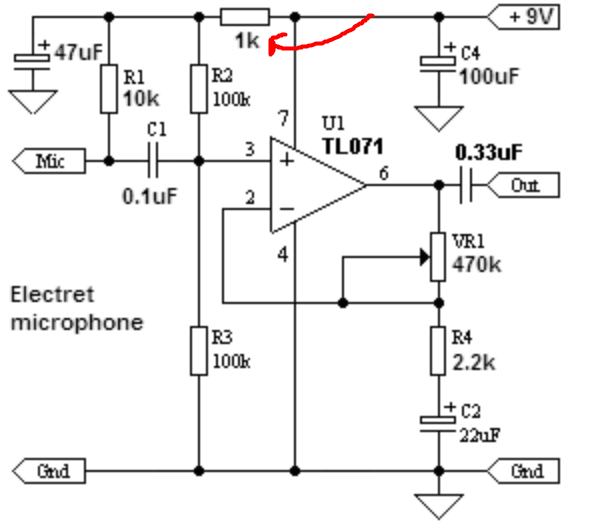

These resistors existence also confuse me.
So the capacitor makes DC gain 1 since it acts like open circuit hence making it a buffer but acts as an short so the AC gain is 470K/2.2K right? Makes sense when I think about it.

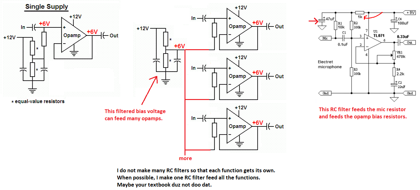

Actually missing RC filter was this you pointed out a year ago.
A wall wart power supply could have hum and a weak 9V battery could have its voltage jumping up and down with the circuit signals. Then the 9V must be filtered so that the preamp does not amplify the noise.

A large part of the noise will be due to ground currents, in a PC. I use an isolating transformer to break the ground back to or from the audio port, when connecting to equipment that has external power connections.
Or you could use an isolated converter from the USB supply, so that ground is broken rather than the audio one.
USB audio devices don't gave a problem because they have a single ground and the audio to & from the PC is digital, so not sensitive to noise like analog audio.

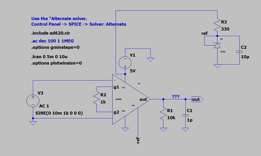

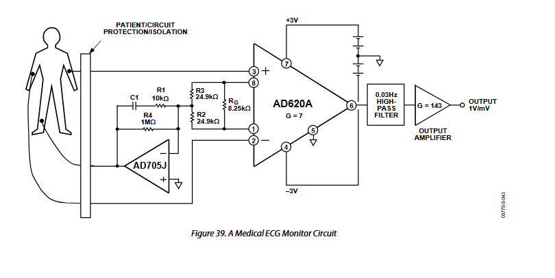

My teacher want me to make a differential amplifier ECG measurement device with 3 electrodes and AD620 Differential Op Amp. Should I open another post for it or write about it here since diff. amps. been talked about here.
Something like this:
I was thinking of how the hell I was supposed to use a diff amp which has 2 inputs to measure 3 inputs. This is really interesting since it is using the gain setting in an unique way.
I need it to operate at 5V from Arduino so I will use a TL081 to set the middle point.
Lab document says use op amp for setting middle point but it seems to be not necessary.
It's only the difference between two inputs, the arm (or chest) electrodes.
The third electrode is used to "drive" the sensor<>body voltage and keep the average electrode voltage well within the opamp common-mode range.
The third electrode cancels hum and noise picked up by the main electrodes.

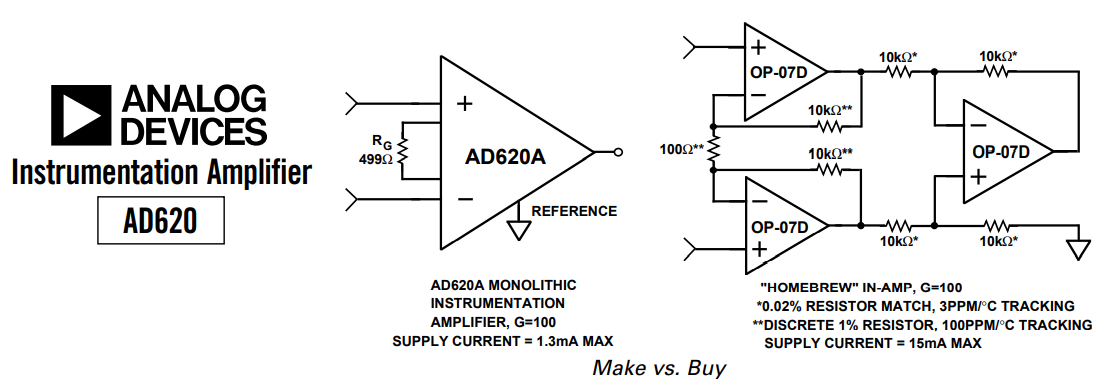

I guess you did not read the datasheet for the AD620. it is not a simple differential amplifier, instead it is an Instrumentation amplifier.
Lookup "instrumentation amplifier" to see that has 3 opamps in it plus a few very well matched resistors.
The minimum recommended supply for a TL081 is +5V plus -5V, maybe it can feed the 3rd electrode..

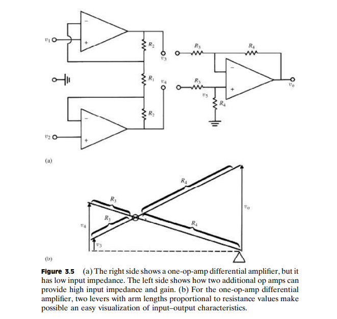

Isn't instrumentation amplifier is just 2 more op amps added to the differential amplifier to increase it's performance.
I know what an instrumentation amplifier is. I just referred it as differential amplifier since it acts like and consists one. I made one out of TL074 at #16. Anyway lab report says we were supposed to use OPA344 for subsequent amplifier but since I attend to a poor college that only requires a lifetime worth amount of money of an average family for 4 years of education for it's paid students they can not resource enough funds to purchase appropriate components for labs. For this reason TL081 will have to work with +-2.5V. It will be sad and maybe have distortion but will try.

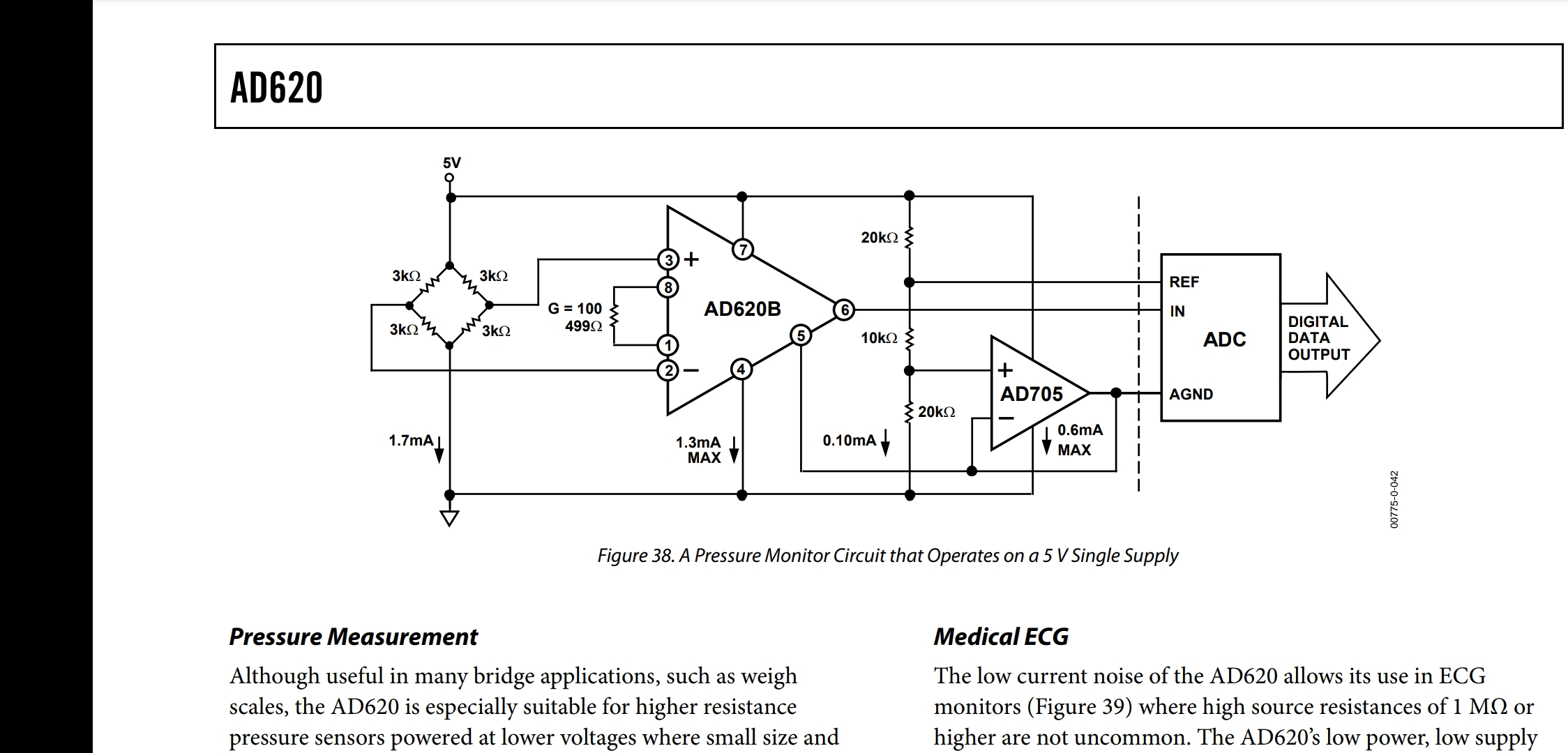

One difficult thing to understand for me is the connection of gain setting pin 8 and 1 in my previous post. Output is connected to the electrode. It looks like it is set to 7 times gain by default.
Checking the datasheet more reveals a lot of information. It seems like it doesn't have jfet inputs but still has high input resistance thanks to some very high beta thing it got going on. I don't have enough time to check it throughly since I have exams coming up but it is interesting that they provided us these since it seems like it is not super cheap either. I was expecting bunch of half dead LM741s.

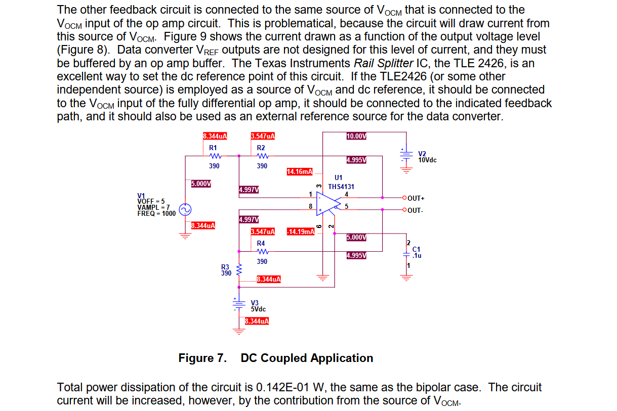

Texas Instruments Differential Op Amp single supply article says I need to buffer the reference voltage and I was thinking I could use TL431 since it has a default reference voltage of 2.5V so I don't need extra resistors for 5V single supply and it is very cheap instead of using voltage divider and an OpAmp buffer.
Any ideas how I can simulate human body in LTSpice to test the full ECG circuit. And how should I pick TL431 bias resistor. Looks like people often use 330 ohms and since I am powering it with 5V using high value resistance causes current to be too low and some voltage fluctuations at the reference pin. Since TL431 is rated at 100mA maybe I can use something like 100 ohms instead.

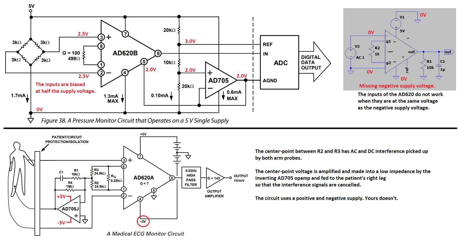

The Maxim opamp produces a high output impedance (use a 1M load) , a high noise level and no high audio frequencies (old telephone or AM radio sounds) when its current is set low.
The AD620 instrumentation amplifier does not work with an input at the same voltage as its negative supply (both are grounded in your circuit). It needs an additional negative supply.

It is used with 5V single supply here.
Will high output impedance cause issues for leg drive. At the output it should be ok since it will feed into Arduino analog input. I will use it in high current mode. Why is got terrible specs though, if one thing I learned from Analog IC class there should be a tradeoff for something. This looks like it is straight bad except operating voltage.
I have 2 AD620 chips. Can I use one for leg drive somehow.

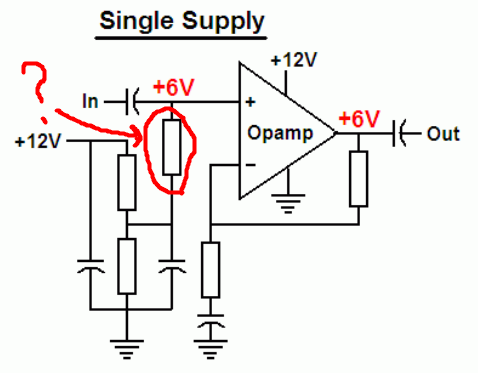

Please learn why opamps must have their inputs biased properly.
It is much easier to use an ordinary opamp as a single-input inverting amplifier than an AD620 2-inputs instrumentation amplifier.

The patient and the circuit's ground must never be connected to earth.
The circuit's 0V ground voltage is near half the supply voltage when there is a positive and negative supply.
Then the amplifier inputs are biased so that they work.
