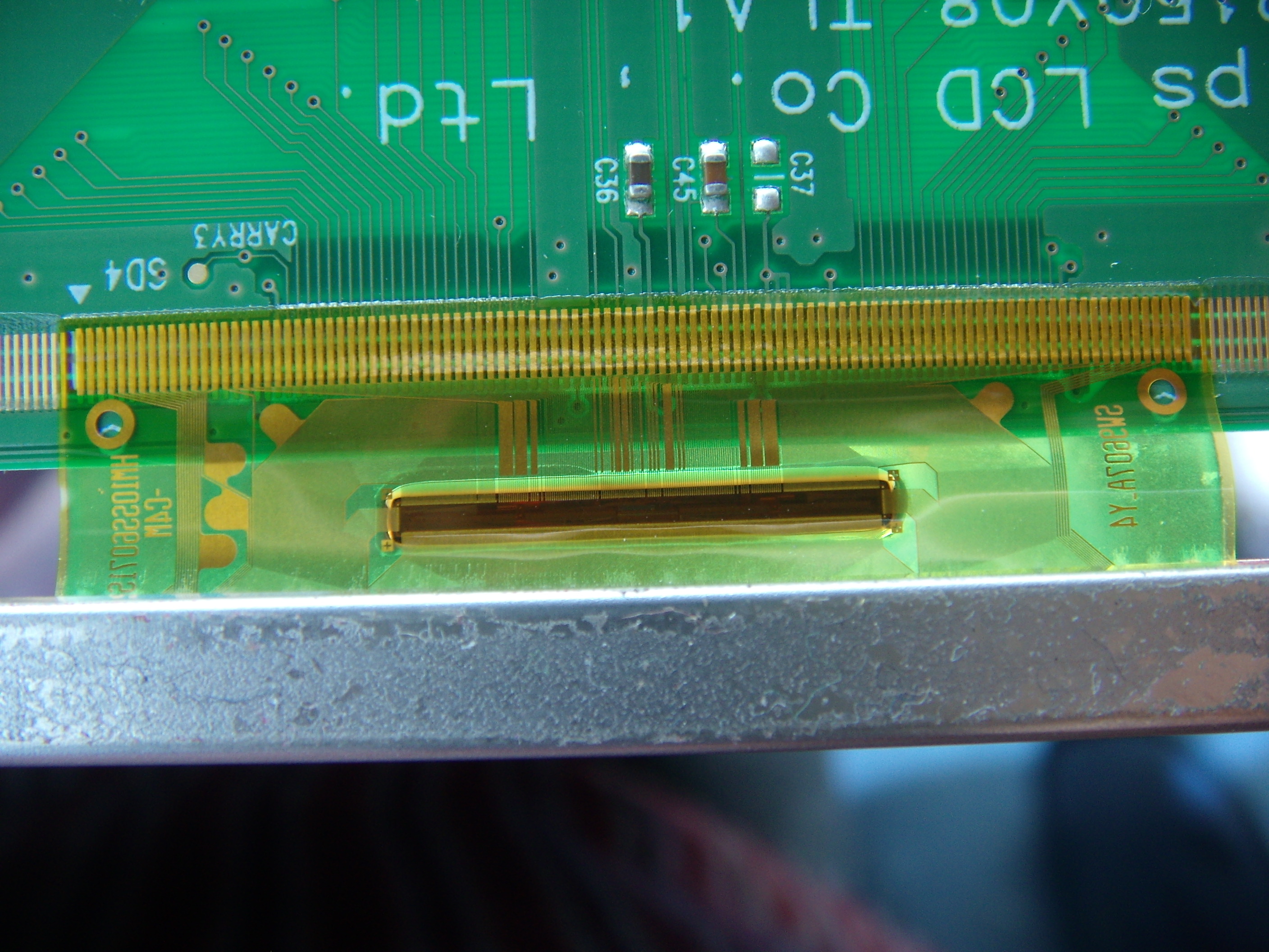

is it possible to fix my laptops LCD panel?
Chris2009
early on it simply had a red vertical line of pixels about 2/3 of the way from the left side. Then another (blue?) line appeared. Eventually it started wigging out altogether. I could fix it by grasping the top of the bezel and depressing the front. This worked for a while. Eventually that stopped working. Then I opened it up and discovered that if I pulled down on the circuit board (it's at the top of the panel, in back obviously, Toshiba Satellite L25-S1192), this would fix it also. So I started applying tape judiciously to pull down on the board. Eventually that stopped working (the screen is mostly white, areas of faint blue or other colors). I started 'scoping' a little deeper and see that the harness that goes into the panel proper has extremely thin traces. W/the naked eye it appears as if there's a solid coper plane descending into the panel. I used this microfiche lense to get a magnified view. Crazy meticulous stuff.
Anyway, is my problem fixable? If there's a chance of fixing it, I'd like to know (don't want to blow 100$ on a new panel right now, nor buy a new laptop right now, and even my Asus eee 900a is giving me problems!). Please help :(
I guess what I'd like is information on troubleshooting lcd's in general. I do have a scope (no probe) that samples at 60mhz.

if u dont know what you are doing you should get someone to repair it for you-the fault you have is a common fault but it involves stripping down the laptop to the motherboard before you even start ......so if you can strip it down get yrself a soldering iron and desolder braid,desolder the connector that connects the ribbon to the tft and motherboard and resolder it..........
judging by the trace pitch of that cable, you'd need a hot air reflow machine to do it right. just take it and get the panel replaced. the new panel comes with all new cables.

The simple facts are that these panels are not made to be repaired, even if you do know what you're doing and happen to have the right equipment. The expectation is that that when the panel dies, it is replaced as a unit. Manufacturers typically do not even publish the information you'd need to get inside the panel and work things out, and even if you only value your time at minimum wage, you'll still lose out by trying it yourself vs. just replacing it.
And yes, you *can* do more damage to a non-operating device, if you expect that you can fix it. How? You can fix the existing problem but if you screw something else up in the process then the "fix" was pointless.
Your realistic options are a) get it repaired; b) buy the replacement parts, or c) scrap the idea. Like it or not, them's the facts. You don't have the equipment or experience needed to fix it. . .and honestly, if you sent it in for repair, they wouldn't bother trying either. They'd swap out the bad panel for a good one. Much, much cheaper than trying to repair the duff panel.
In fact, these days you can buy a Toshiba Satellite L25-S1192 for less than the cost of the replacement panel. In insurance terms, it's a write-off.
Actually there is another option, which is probably what I'd go for: use it without the display. If you have a home router or something, hook it up to that and use it as a headless file, print, or web server (it could probably handle all three tasks, actually). Might squeeze a few more years of useful life out of it that way.
Sorry that this isn't the answer you want to hear, but that's probably because nobody capable of doing it would consider it worth the time or effort. Wanting to hear a certain answer to a question doesn't mean that you will, and getting your knickers in a knot about it isn't going to change a thing.
