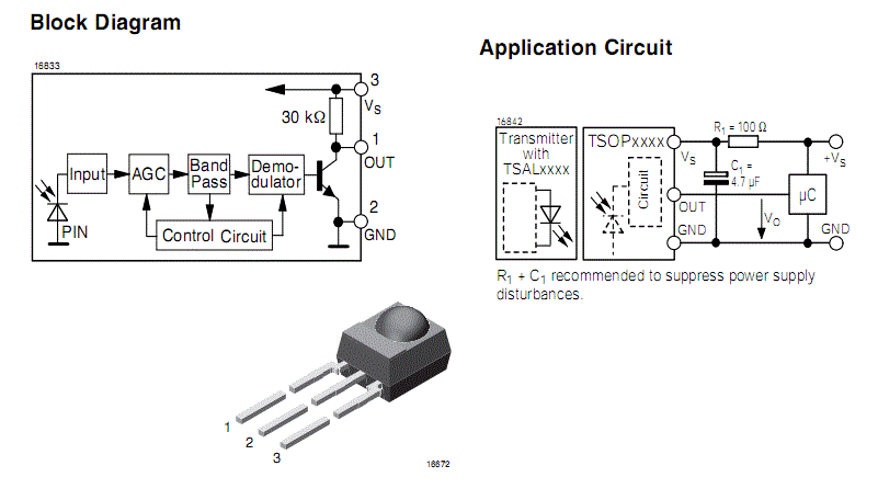

Your diagram is contradicting itself, the picture shows Out as on the far right, whereas in the schematic it shows itself in the middle? It looks like is hooked up right though, just might confuse somebody :)
TSOP IR detectors have several pinouts, you have to check your datasheet. Most have built in pull ups (again it's in the datasheet and so is the resistor & capacitor).
As was said I need 100ohms and 4.7u. I'll change them now and use the logic tool.
47uf should be fine. Try the Logic tool first. Set the trigger to falling edge \ .

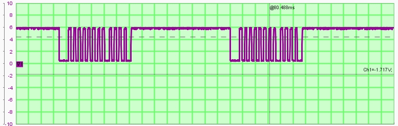

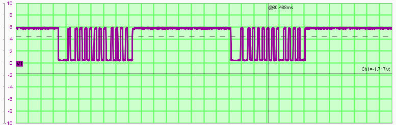

As my scope was already attached here are buttons 1 and 2 I just took now. So it seems my tsop is fine (I think). Need to change the 100ohm and 4.7u though.
(the device ID is for CD not TV. I have made that change in the code using 0x11)
