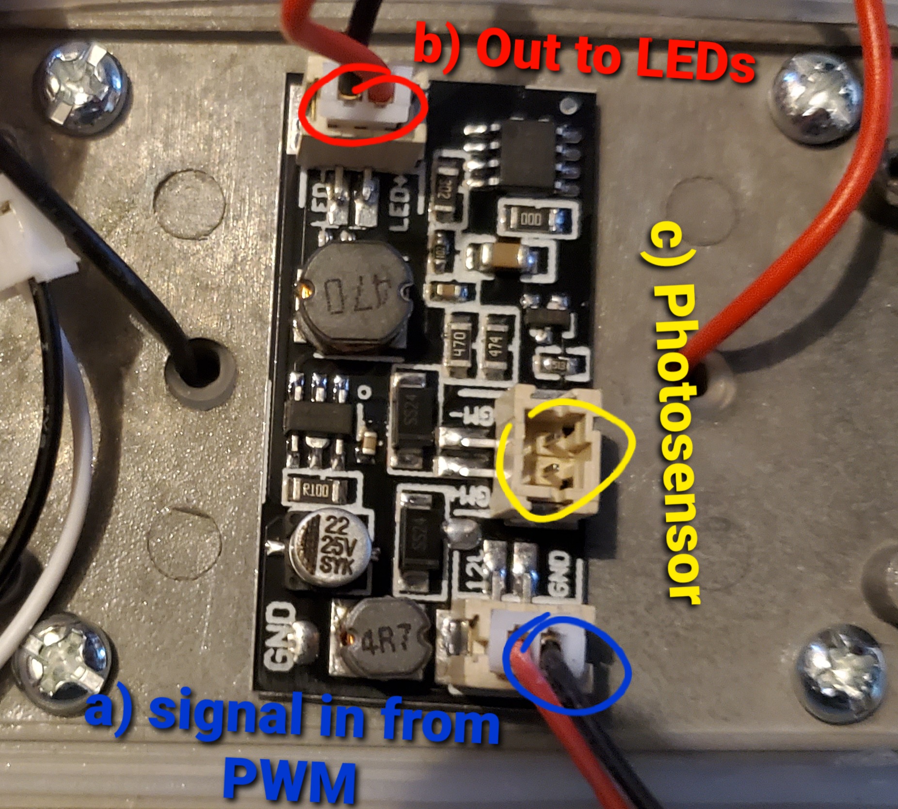

Hello. noob here. I don’t know what i'm doing, and am looking for help.
I'm trying to make an IR strobe light with a cheap light source and a PWM.

Can I achieve my desired strobing effect by simply connecting the power supply output to the PWM, and then the PWM output to the illuminator?

The IR LEDs have no detailed specs and have no detailed datasheet describing the max allowed peak current at various pulse widths because Amazon and their sellers are not engineers. The IR LEDs in a remote control have a detailed datasheet because they are made for high current very bright pulses of IR.
This illuminator is probably not made to be a very bright IR strobe light, just an ordinary continuous IR light. High current pulses will probably burn it out.
If its power supply voltage is more than 12V then the current will be higher, it will be brighter and it will burn out sooner.
It is a 12VDC, 8 watt illuminator could work. One challenge will come if there are any significant sized capacitors across the power supply. Trying to flash faster than the capacitor can charge/discharge will cause the sharp edge of on/off to be less sharp and eventually not turn off completely or on completely if it is too fast. You could open it up and remove the decoupling capacitor if needed. It is only there to stabilize the intensity.

I was talking about the possible presence of capacitors across the 0 (ground) and 12V power inside the IR illuminator That could cause the rising edge of the voltage to slow.

gophert ; got it. thanks. I'll splurge $15 on the illuminator and open it up in search of caps.

The illuminator has a faint red glow that is clearly visible to the naked eye. It looks very bright to a cellphone camera. Pulsing at 1hz to 10hz, all looks good. At 25+ hz, i don't really see any pulsing, even though i should be able to easily see that flash rate. so gophert was probobly cortect about componants not keeping up with the pulse frequency.
A picture of the lluminator's brains are attached. It's not obvious to me what this does. I'm tempted to bypass the board by plugging (a) directly into (b).
I unplugged (c) so that on/off isn't controlled by room britness.
