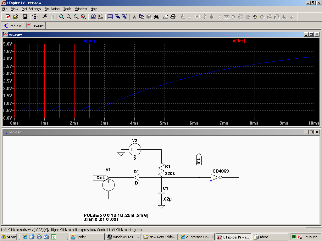

The detectors are pulse detectors so they need pulses at 38 Khz to work right.
Then you need to turn the pulsed back into a switch signal.
They are also sensitive to noise so use C1. Most application notes add a 100 ohm resistor between +5 and the detector with C1 at the detector.

Problem will also be those TSOP IR receivers have an AGC so sending a continuos data stream won't work very well.
This is an old wives tale that runs rampant on these forums! It is simply not true for all IR receivers.
If you transmit a continuous 38KHz IR carrier to a Sharp GP1u58X IR receiver, it locks on to the carrier, and sets its internal agc based on that signal level. If you then interrupt the beam for a short time (like by moving your hand or body through the beam) the receiver output pulses on the rising edge as the beam is re-established. It does this reliably, every time, with a range of > 3meters even in daylight.
The output is not DC coupled, however. The duration of the output pulse seems to be dependent on some internal time-constant inside the agc-loop as the loop re-acquires the IR signal. It works well as a beam-break detector. I use it to count runners as they run down a trail during the Wasatch 100 mile run.
Sorry, but >3m is a pretty appalling range :p
The TSOP's probably do a similar crippled range on a continuous carrier?.
Your comment about the output not been DC coupled is probably exactly what we're talking about, where you need pulses, not a continuous carrier.
No, this is outdoors, in bright sunlight with only about 50mA peak current in the transmitting LED. The system runs on battery power continuously for about 2days at a time, and must be backpacked to where it is set up, so that precluded bigger batteries and higher peak LED current. If I run it at night, outdoors, the range is about 15m, which is about as good as any IR remote I have tried.
For a beam break detector, modulating the transmitter with pulses, and then adding a secondary pulse-detector, filter, and output comparator is totally unnecessary.

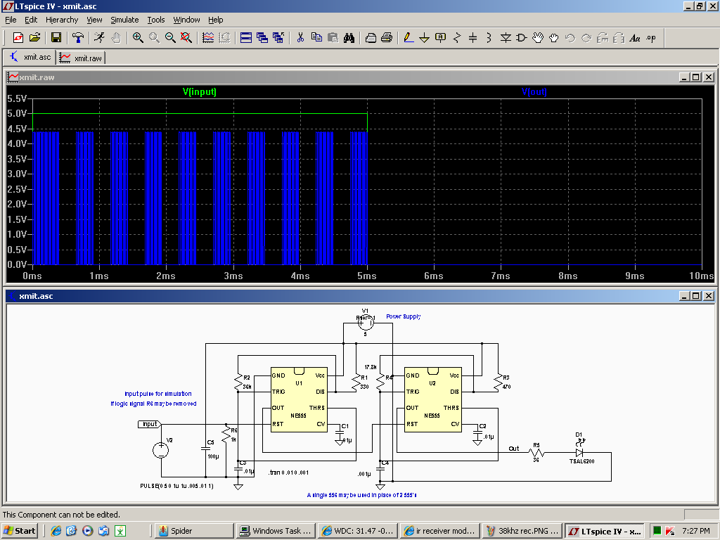

Is it safe if I will place 10k var resistor on R4 here?
Sorry if the image is so big. I unintentionally used Quick Reply than Reply.

To answer your questions first:
1- For it to run all the time tie the reset pin to Vcc
2- No
3- Yes, If you are using a television remote each channel has a different set of pulses.
Now the circuit:
It does work-- but, In the simulation I attached the low frequency (200 HZ) was just to show it could be turned on and off. You want the first stage to run at about 2KHZ. Your second stage runs at about 20KHZ. It would be better if it ran at 38KHZ.
Also to make the duty cycle closer to 50% (symetrical) your R4 should be small compared to R5.
From what R4 are you referring to? R4 on my image or from yours?
Yours. Play with some values in the equation for the timing on the 555 and you will be able to see that with your setup you can get almost a 50% duty cycle (which is good enough). Be careful not to exceed the maximum current spec for the dischage pin.
