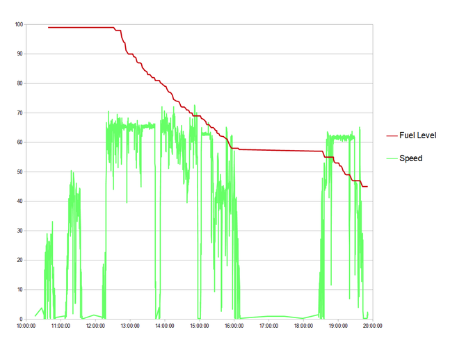

I've been using the Telit GE863, GE864 and GE864 modules for some time for vehicle tracking, which includes a lot of additional information along with the position and speed.
Here is an example of what can be done. The speed came from a GPS receiver and the fuel level by reading the CANbus:-
E4CDDxCVoAAb0rP
Thank you. This is what I'm looking for.

I do it by reading and writing data via PHP scripts and an SQL database running on an Internet server - this has the advantage that you can make a lot of adjustments in the PHP code, not needing access to the hardware. So keep the hardware/software side simple, and do the clever bits on the PHP side.
For example, we're providing remote readings from water meters, which provide a simple pulse output - historically the logger would count the pulses, do the required maths (based on how many pulses per litre etc.) and then send a text of how many litres/sec, litres/hour or cubic metres per hour had gone through the meter. This meant the receiver either had to 'wake up' occasionally, to receive instructions, or read them at it's normal transmit time.
I decided a GPRS system would be better, rather than texts, and that simply sending the pulse count is all you need to do - the required conversions are done in the PHP, and easily altered at any time you wish.

It's encoded in the URL. I send HTTP GET requests with a load of arguments on the address. They would be something like:-
GET /data/index.php?lat=52.45762&lng=-1.40367
In the index.php file on the server I have code that is something like:-
$lat = floatval($_GET['lat']);
$lng = floatval($_GET['lng']);
and then those values will get stored into a database.
I used many other arguments for various types of data, and the URLs get quite long.
