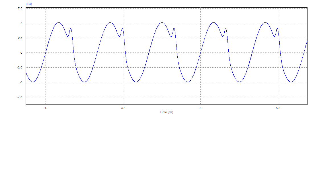

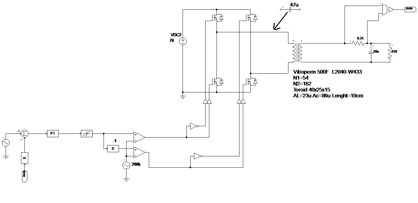

i'm testing an inverter with these features:
Fswitching=220KHz
Fout=3KHz-10Khz
Vout=150Vac
Pout=150W
Current feedback.
Sinusoidal output is obtained with transformer leakage inductor+output capacitor.
In the figure below there is the schematic.
The problem is that a little DC component (about 100mA) put transformer into saturation and the output waveform has a distorsion as in figure
I don't understand from where it can come this DC component. Could you help me?
A capacitor could solve my problem? what features should have this capacitor? Ceramic or film cap? I had thought of 47uF@25volt as the voltage across it should never be too high.
Let me know.
Your circuit has nothing to properly turn on the upper Mosfets with a gate voltage that is 10V higher than the 70V supply voltage. A Mosfet driver IC normally does it.
If you drive the MOSFETS at 50.5%/49.5% (not symmetrical) there will be DC current. You could look for this DC current and adjust the drive. Or you can add a capacitor.
If things go wrong you could get 70V across the cap. Look for a high current cap. Most caps will burn up at high current.
I'm thinking of a transzorb protection across the capacitor. Is it a good idea?
Another question: what capacitor technology is most suitable for this application, ceramic, film or other?
Let me know.

I've seen that waveform many times before on simple homemade power inverters based on low frequency iron core transformers that use a simple LC tank circuit effect on their secondary windings to reshape a square wave input into a more fitting sine wave shape output.
Most often it comes from there being too much capacitance on the transformer's secondary winding set causing a basic LC tank resonance that's large enough and just out of synchronization far enough with the system frequency being dictated by the driver circuits to create a offset beat effect.
Best guess is that the 20 uF - ? capacitor on the secondary, is trying to setup a LC tank resonance that's about 10 - 20 percent lower than the driver circuits frequency.
I would be tempted to try changing it to a ~15 uF ? value and see where the waveform notch drops in at or if it disappears all together.

AG - regarding the above, I think that the diagram is intended to be conceptual rather than a complete schematic. You're right, of course, but I suspect that the OP knows how to drive FETs.
Ron is correct; you can servo the DC component to 0 (how effective this is will depend upon how accurate your servo is) or you can simply AC couple the transformer using a capacitor.
Personally I'd prefer to fit a capacator, as this guarantees zero DC. You could then use a servo as well to adjust for zero DC across the capacitor and therefore exactly 50% duty cule on the bridge. About the only reason I can think of not to fit a capacitor would be if your design was of such high power that the capacitor would be prohibitavely large or lossy.
Capacitive coupling also helps protect the bridge and transformer against some modes of failure.
Film capacitors are generally used in these applications (Polypropylene usually I think - but I'd need others to confirm that). As Ron said, it will need to be rated generously to handle your ripple current. "X" rated compoents are often used.
At only 70V supply, you should easily be able to find a capacitor that will stand the full supply voltage so there would be no need for a transsorb or similar accross the capacitor.
You should also take note of TCMtech's advice, as he's got quite a lot of practical experience with inverters.
Although -

Same effect will show up with that configuration at any frequency if the transformer L to load C ratios are not tuned to a frequency close to what the system is set to run at.
It's related to that pesky impedance matching issue that comes up with certain systems like this that use an LC tank circuit of sorts in their output stage to reshape a large blocky square wave based primary power input into a more sine wave like secondary waveform.
When done right a simple LC tank power circuit can compensate and clean up a huge amount of waveform distortion issues originating from the primary side of the system but when done wrong it can create some pretty strange effects that show up at odd times and in very odd ways under certain conditions as well. ;)

The reason for a small DC current in the primary could be simply because of a very slight difference in transistor turn on and turn off times and/or the Vsat for each transistor. This creates a DC current because the pattern itself has an average DC voltage offset.
It doesnt take much to saturate the core because of that DC voltage offset which because of the normally low DC resistance of the primary the current becomes great even with a small difference in pattern amplitudes and/or widths.
This can add a lot to the peak flux density which tends to ratchit up more and more over time.
One way to get rid of it is to integrate the primary voltage and use that as feedback. Your capacitor might work though, i have never had to do it that way. The cap has to be able to handle the RMS current.

Doh! I apologise - I'd been thinking about this in the wrong way (which is why TCM's comments didn't make sense to me initially).
I had been thinking of the transformer working at the switching frequency of 220kHz - the transformer (and any capacitor in series with the primary) is actually seeing the output frequency, which could be as low as 3kHz. Of course!
That does change things a bit, and explains why you where considdering such a large cap. Your calculations seem right to me, assuming that there is not much standing DC coming off the bridge in the first place - this will appear in addition to the voltage generated by the primary current (but if you're only getting 100mA of DC then this DC error can't be very big at all).
Hope I've not confused the issue with my misunderstanding.
Yea it took me a long time to get my head around how that works too.
The biggest issue I see with the design is the output stage LC tank circuit is likely going to have a rather narrow frequency band (like cheating crystal oscillators base frequency up or down. It only goes so far before it won't work.) it will operate in without creating those odd peaks and dips in the primary signal waveforms so trying to get it to make a clean sine wave output over a 3 -10 KHz bandwidth may not work as it's presently designed.
Likely it may need a moderate value of resistance in series with the output stage capacitor plus have the value of that capacitor reduced to the bare minimal amount that can still filter out the higher input side PWM frequency but not create a dominant resonant harmonic within the working frequency range of the output stage.

Core saturation from unbalanced current happens in a voltage mode PWM. (Where you drive duty cycle with out watching current)
In a current mode PWM each cycle terminates when the current reaches a set point. If the core heads into saturation the duty cycle change automatically to compensate.
Not sure what you are saying here. Arent most converters driven with an H bridge of transistors with no bridge current limit? Back in the 80's we later started to install hall effect current monitors in each bridge but before that there was no current monitoring. I think the majority of converters are built that way, with or without current monitoring.
A voltage mode full bridge can slip into saturation if things are not perfect.
Adding some core gap should help some.
Adding a capacitor will balance the current.
or
Monitoring the current. A current mode PWM will keep the core from saturating in one direction.
