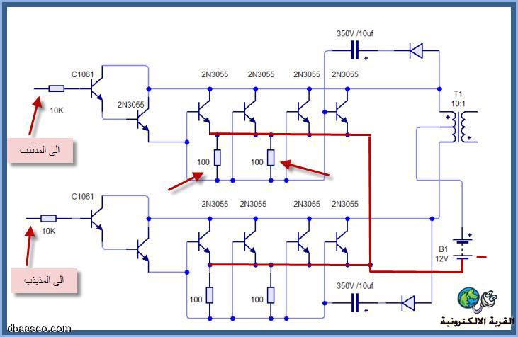

inverter driver
muhammad59
1-is this good driver for inverter ??
2-why use diode and capacitor ??
3-how determine or know correct resistor sizes ??
The 100R's are just to turn the transistors off.
The circuit will not work properly.
The 2N3055's will not turn ON fully.
It's just a very bad design.
