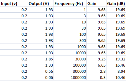

You have a table of output voltages at various frequencies.
You are looking for the gain of the amplifier, so you need to know the input voltage.
The gain is then the output volts divided by the input volts.
The gain can then be converted to dB using dB = 20Log10(V/v).
You do not state the input voltage so I am going to make the assumption that it was 200mV (0.2 volts).
Here is my interpretation of your results:

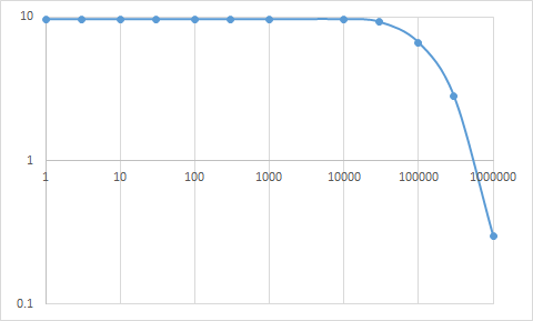

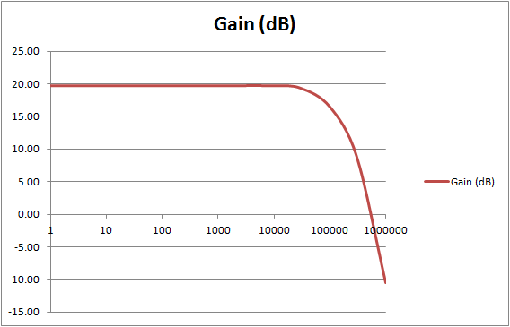

Using this table I produced this graph:
That is not too bad is it?
Thank you very much I also used a logarithmic scale base 10 for the frequency on the x axis as well as the gain because I forgot to mention that to you.So i just changed that myself. and ended up with this

Hi fleur_,
Your calculation is correct. In an inverting amplifier the gain is determined by the ratio of Rf/Rin. If you measured a gain of 10, instead of -10, then your meter probes were probably backwards.
Does that mean I can say that the difference between the theoretical voltage gain and actual gain is 20 and would the percentage error be 50%
You are mixing up the voltage gain of 10 times with the voltage gain of 20dB which are the same. The negative voltage gain is not a loss of gain, instead it is the output signal that has become inverted.
A voltage gain of 10 times= +20dB, 100 times= +40dB, 1000 times= +60dB, 10,000 times= +80dB etc. A voltage loss of 10 times is a loss of -20dB.
One assumption that you made was that the output resistance of the signal generator is zero ohms.
A second assumption that you made is that the signal level is much lower than the 2Vp-p input shown on your schematic so that the poor slew rate of the lousy old (47 years old design) 741 opamp does not cut and distort the high frequencies.
A third assumption that you made is that you think all 741 opamps are the same which is not true. You tested only one and the datasheet shows only a typical one. But they are not all the same, some are worse and some are better.

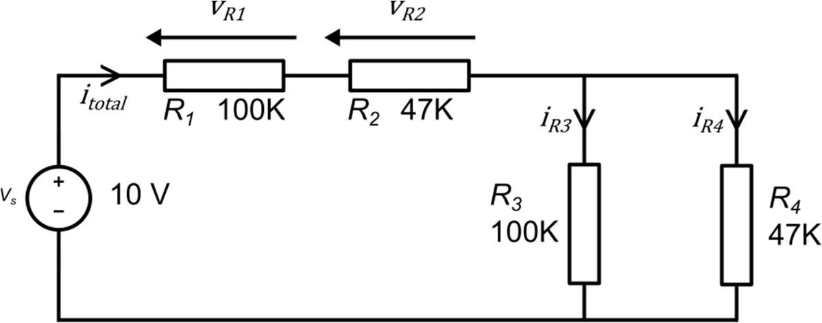

I am trying to calculate the quantities labelled in this schematic Vr1,Vr2,ir3 and ir4 so i have to use ohms law but combine it with the rules for series and parallel resistors.
What I did so far is for the first two resistors in series I=V/R therefore 10V/100k+47 not sure if this is the correct way of doing it ....

Be careful about your order of operations. Saying 10V/100k+47k won't give you the same answer as 10V/(100k+47k). In this case you need to make sure you add the resistors first.
That being said, if you're trying to find Itotal first (which I recommend), then you need to combine all of the resistors. Start with the series resistors and get one equivalent resistor, then combine the parallel resistors and get one equivalent resistor, and then you'll see that you simply have two resistors in series after that. Simply combine them, divide the 10v by the Rtotal you calculated by combining R1, R2, R3, and R4, and you have Itotal. That should give you a good start.
R1 and R2 are in series so their total resistance is 147k ohms.
R3 and R4 are in parallel so their total is 31.972789k ohms. Then the total resistance is 147k + 31.972789k= 178.97278k ohms and the total current and current in R1 and R2 is 10V/178.97278k= you figure it out.
The total current is known then the voltage across R3 and R4 can be calculated and their currents can be calculated.

Yeah that's what i did initially I found i total but for some reason I thought it was wrong.So i did 10v/100k+47k+100k+47k because ohm's law is I=V/R so now I have I which is 1/294000A
But I am stuck here.
The values of parallel resistors do not add. Only series resistors add up.
Read my post #29 again. Two resistors in parallel have a value that is less than either one.
