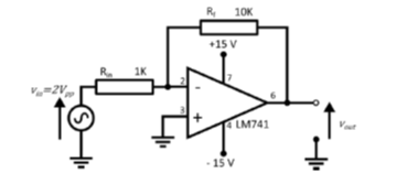

I have to write a lab report about an inverting amplifier specifically the 741 op amp and we are investigating the frequency response.
so for the theoretical voltage gain i got -10 and i got 10 for the actual gain i am not sure if that is any where near correct.
Show the schematic.
Show the schematic.
Hi fleur_,
Your calculation is correct. In an inverting amplifier the gain is determined by the ratio of Rf/Rin. If you measured a gain of 10, instead of -10, then your meter probes were probably backwards.

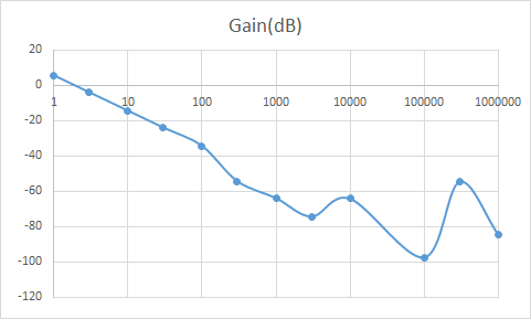

this is what i got
Frequency Gain(dB)
1 5.711146
3 -3.83128
10 -14.2889
30 -23.8313
100 -34.2889
300 -54.288
1000 -63.8357
3000 -74.288
10000 -64.208
100000 -97.522
300000 -54.609
1000000 -84.436
Yuk, that is horrible.
However, I have just plotted your data and it is fine, within certain limitations.
I am going away from the PC now, I will be back in a couple of hours and will explain how to do it. (If no one else beats me to it).
Your frequency response is completely wrong, maybe because the output resistance of your signal generator is too high and there is solderless breadboard capacitance all over the place.
Since the input resistance of the inverting opamp circuit is only 1k ohms (Rin) then the output resistance of the signal generator should be less than 50 ohms for half-decent accuracy (5%).
The datasheet for the lousy old 741 opamp shows its response when its gain is 10 should be -3dB at about 30kHz so its gain should be 10 from DC up to about 6kHz.
But you show a gain of less than 2 at 1Hz and less gain at higher frequencies.

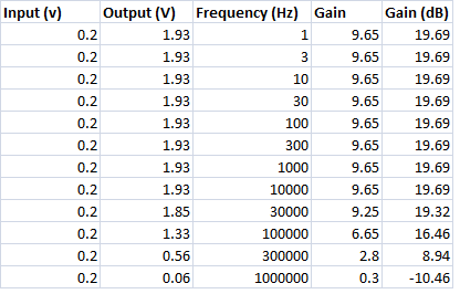

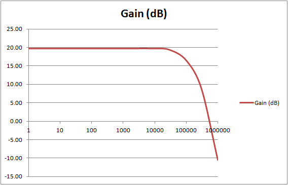

You have a table of output voltages at various frequencies.
You are looking for the gain of the amplifier, so you need to know the input voltage.
The gain is then the output volts divided by the input volts.
The gain can then be converted to dB using dB = 20Log10(V/v).
You do not state the input voltage so I am going to make the assumption that it was 200mV (0.2 volts).
Here is my interpretation of your results:
Using this table I produced this graph:
That is not too bad is it?

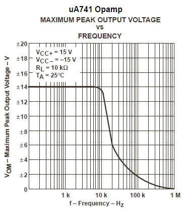

His first schematic shows an input of 2Vp-p so the horribly slow slew rate of the lousy old 741 opamp reduced the frequency response much more. Most modern opamps produce frequencies above 100kHz at full output level with no problems.
In post #7 he (she actually) wrote:
At the following frequencies I got 1.93V for 1Hz,3Hz,10Hz,30Hz,100Hz,300Hz,1kHz,10kHz. and for 30kHz i got 1.85V 1.33V for 100kHz ,300kHz i got 560mV 60mV for 1Mhz
But then went on to mangle the data during the dB calculation and graphing stage.

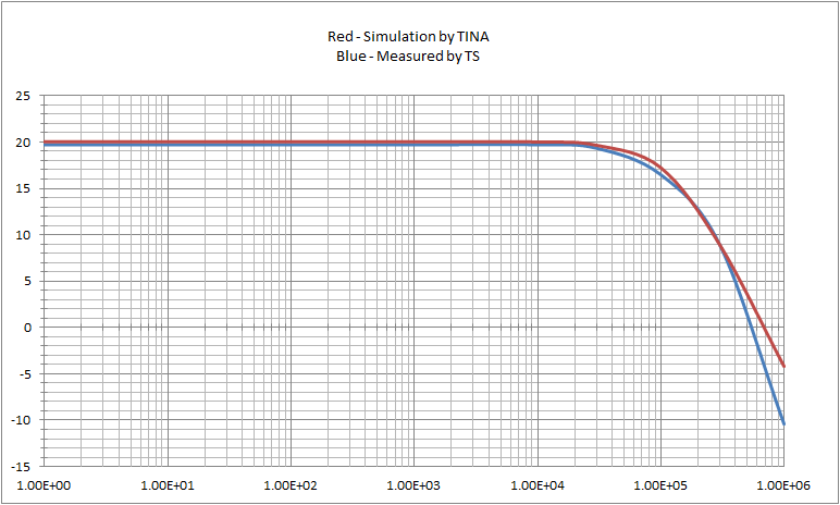

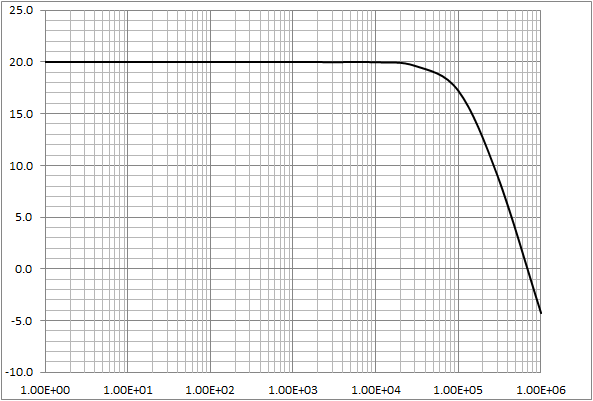

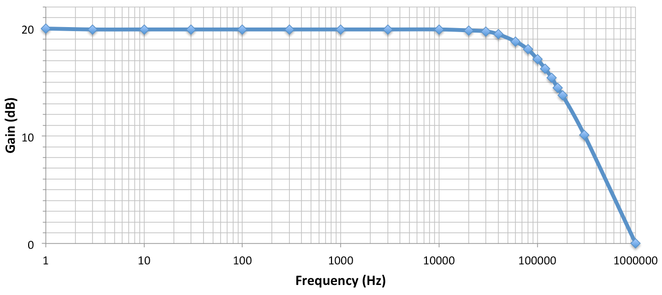

here's a plot as well from excel
on edit: Added an Excel graph comparing plot of TS' data vice simulation data from TINA..
