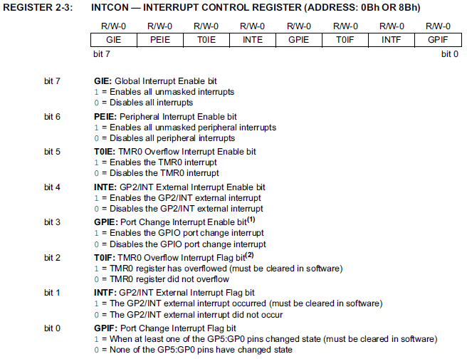

I'm working on a project that requires my μC to wake up from sleep via an interrupt. I am using the PIC12F629 and HI-TECH compiler, but I'm don't quite understand how everything works.
The basic analogy of the program will run through some code if one of the IOC switches is activated. I'm told that I can't poll the GPIF bit while sleeping, so I assume I poll the GPIE bit?
Another notable factor that contravenes with my understanding is a peripheral interrupt. What are the differences and similarities that exist between a peripheral interrupt and a global interrupt? As shown in the datasheet (depicted in the attachement).

You can do it in two ways.
1. Don't enable interrupts (GIE=0) and your code will continue after the sleep instruction when the switch is activated.
2. Enable interrupts (GIE=1) and your ISR will get executed when it wakes up. In this case a nop should follow the sleep instruction.
In both cases, before the sleep instruction you should enable and clear the IOC interrupt (GPIE=1, GPIF=0).
Note that during sleep no code is executed so it is impossible to poll your inputs.
The Global/peripheral interrupt difference is really just a legacy thing. The Peripheral ones just didn't fit in the original register and so new registers were added. So, Global are in INTCON and peripheral in PIR1 etc.

I think you are not understanding what sleep does. Sleep stops the oscillator and so no instructions are executed. The only things that can wake the chip are external interrupt sources, of which IOC is one, and reset or the WDT. When the chip wakes up you check which pin caused it to wakeup and take the appropriate action.
