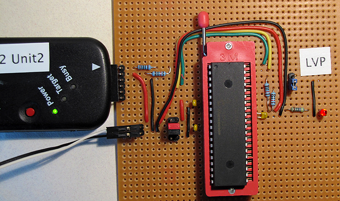

Update . My previous post PK2 ZIF circuit works fine on 16F887 both PK2 standalone and MPLAB 8 operation ,( non LVP program / verify etc etc etc ) this is with external 5v power ON . the 887 has different LVP pins reason for extra option strap.
Edit... also now write...verify...etc 18F2420 ..:)
C....
Q what about PIC EE your circuit using it ...?
Q does your "running" PIC18F2431 circuit use RB5 PWM4 ... pin 26 by any chance ?

Here's mine.
PIC EE ????
No, RB5 not used.
Camerart
C If your program uses pic EEprom It would need to be initialized , similar but different to pic memory as previous posts, its default new chip state is usually FF . ( chicken and egg . needs to start at known value at least once )

I tried changing the programs on a 'good' and a bad' PIC, then programmed the PICs again with the latest program, then READ them and compared the HEX files. Both the same. Again, I think they are programming ok.
Camerart.
Received 10x new 18F2431 PICs today (With a different batch number)
Same result as before. I now have 1x PIC that will erase, program a different program on it, erase, blank check, read, and re-program ok, works in the circuit. 5x other PICs from the first batch and 4x of the new batch don't work in the circuit, although they all Flash the LED as per the program.
I got onto Farnell technical support, tried an earthing wrist band, and grounding the circuit power before fitting PICs, still failed to get results. :banghead::banghead::banghead:
Camerart.
Once again, what is your target circuit? You showed us your ICSP circuit, but not the circuit you're putting the PIC in after programming it.
EDIT: Or do you have your ICSP and target circuit combined? Make sure you tell your PICkit to release the chip from reset after programming.

After many tests on these PICs I'm pretty sure that the problem is not theirs, but somewhere in the way I'm testing the circuit.
When I say circuit, I mean the motor drive circuit not the programming circuit, with Jumper for LVP and a LED for when voltage is present. This Pcircuit is working fine and I suspect the PICs are being programmed ok. In the Mcircuit there is also a LED.
EDIT: In the program there is a start-up LED flash, (Works on all PICs) then once AxxxExxx is received, the 'loop' starts and in the 'loop' there is a LED toggle, that tells me it is running. This toggle LED only runs on one PIC, and motors spin ok.
I am testing the Mcircuit by injecting the expected AxxxExx into the 18F2431, instead of how it should work, by an 18F4520 sending AxxxExxx to the 18F2431 (There will be 2x18F2431,s ignore) When I fit the programmed 18F2431 into the circuit, I must disconnect the AxxxExxx sending wire from the FTDI programmer, as it has voltage on it. I'm now looking at this as the most likely cause of the problem.
