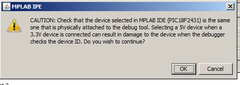

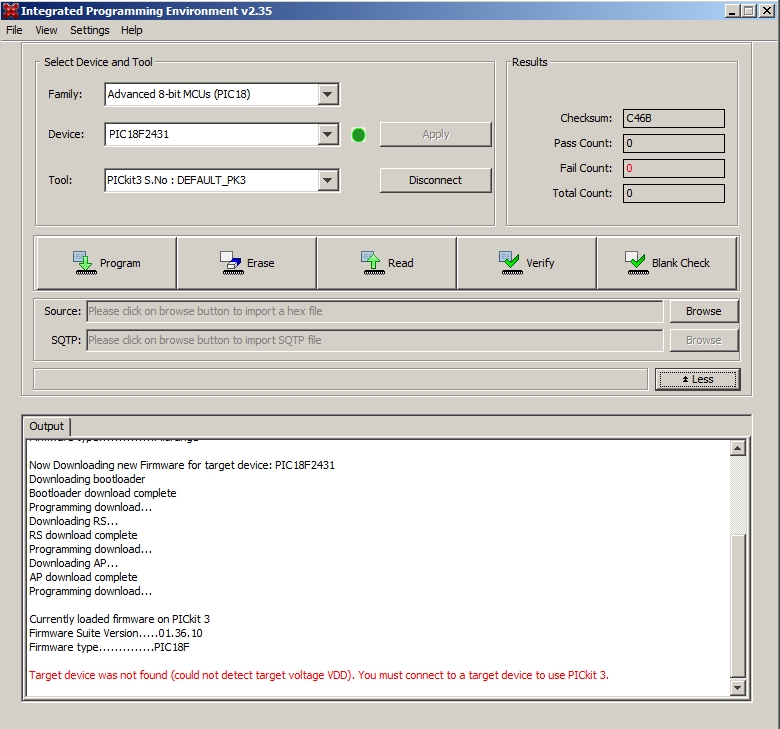

Mine has just arrived too. I've never used MPLAB before.
Moved J1 to pos 3. I got the result: 5V or 3.3V, I clicked ok, then I got the result No VDD when trying to connect.
(I can hear "now the fun really starts...:)" from somewhere)
Thanks, Camerart.

Your confusing an old man... thought 18F2431 was 5v Vdd and did not zif board have own supply ?
Edit ... :):)
Edit ... :):)
For some reason pickit 3 highest voltage setting is 3.5v which is enough to program with...
That is not universally true. My PK3 does 5.0 volts. What you are seeing is probably a function of the device chosen, like in the configure window in MPLab. Be sure a non-LF device is chosen.
John
John I was going to say that...:meh:
Like these little faces ,,,want to use this one someday.:grumpy:
I'm testing on a basic pic18f45k20... These things run from 2~5v... I'm going to try a pic18f452 ( got an old one somewhere )

Ian, I just confirmed that PK3 and ICD3 both show a max voltage of 3.5V for the !8F45K20 and 5.0V for the 18F452. I suspect you knew that. I guess MC dropped the LF for some chips.
John

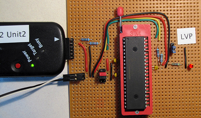

Finished the ZIF circuit.
Tried it with PicKit2. The 5x 18F2431 showed: program, erase, blank check all showing OK. The verify, showed 'Failed to verify at programming address 0x0000' error. All didn't work in the circuit.
Tried it with PicKi3, the 'good' 18F2431 programmed ok, and worked perfectly in the circuit. The other 4x verified ok. There is a LED flash in the program which flashed ok, but didn't move the motors. I programmed a simple motor test on 1x and this moved the motors.
I'm guessing that I might have 'popped' all except the 'good' one, making them not work fully.
I'll buy some more PICs and see how they work.
Camerart.
I decided to build my own zif PK2 setup , although I don't have any PIC18's of any kind ( couple on order ) , post #63 suggested my circuit won't work as it said on the tin ... ? :nailbiting: but did not explain reasoning .....
Watch this space.....

Hi G,
LVP bit set, now both PicKit2 and 3 appear to be programming ok, with all green and no errors. Result, the same as before 1x PIC Ok, 'now' 6x show LED flash, but don't turn motors. Again, I'll buy some more and report back.
Looking forward to seeing your programmer working.
Camerart.
I've been reading and writing to the 18F2431,s with different programs and the HEX files are changing as expected. If I program a 'good' PIC and a 'bad' one with the same program and then compare both hex files, they are both the same, so I'm convinced all pics are being programmed, but the 'bad' ones have a pin or more not working. I've ordered some more.
Camerart.
Update . My previous post PK2 ZIF circuit works fine on 16F887 both PK2 standalone and MPLAB 8 operation ,( non LVP program / verify etc etc etc ) this is with external 5v power ON . the 887 has different LVP pins reason for extra option strap.
Edit... also now write...verify...etc 18F2420 ..:)
C....
Q what about PIC EE your circuit using it ...?
Q does your "running" PIC18F2431 circuit use RB5 PWM4 ... pin 26 by any chance ?
