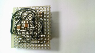

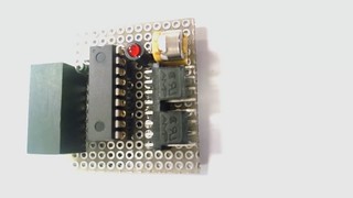

My method for small prototype boards is a usually just a section of vector board.
Typical small project prototype.

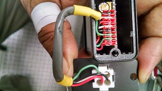

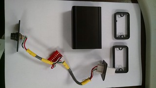

Gear signal emulator (variable reluctance sensor replaced with Hall sensor) for low speed motor mod for a ion beam mass slit device, 1.9 RPM instead of 1700 RPM to reduce bearing wear. PIC18F1320 controller.
