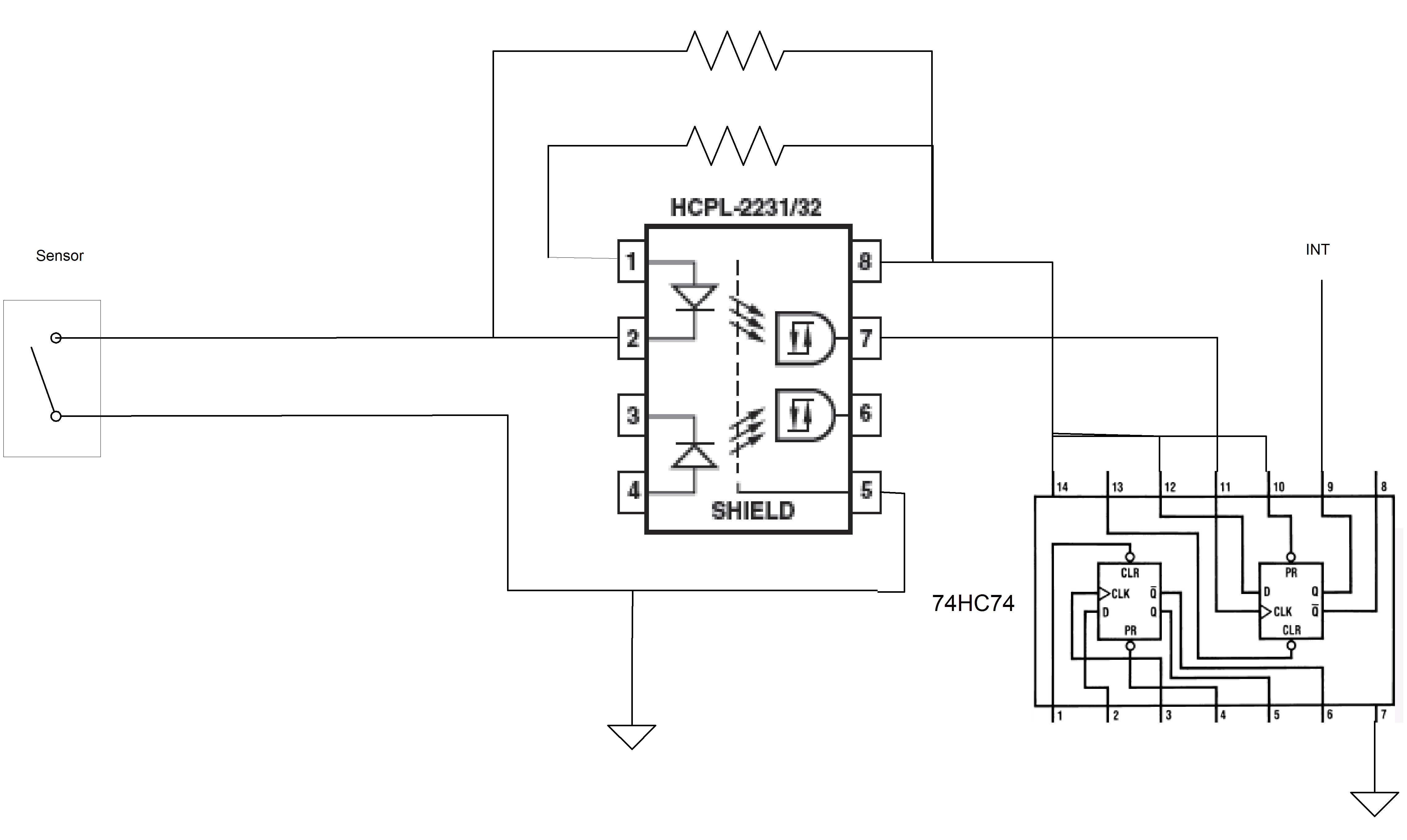

Like this attached..
With pts A and B connected to the INT pin , One end of 1&2 connected to Vcc and the other end connected to the I/O pin if switches are involved.
Here i may have to check the corresponding I/O line when INT is triggered isn't.

Attached is an example of one channel. OR gate the INT outputs from all channels to generate an interrupt from any channel. Connect the INT outputs from each channel to a multiplexer. The output of the multiplexer goes to an I/O pin (set as an input). The channel select inputs of the multiplexer go to I/O pins (set at outputs). Your interrupt service routine reads the output of the multiplexer while your channel select output scans to determine which channel generated the interrupt. Use an I/O pin (set as output) to clear the flip-flops once the service routine is completed.
Be aware that the flip-flop will not be trigger again until the sensor switch is opened and closed again. If the sensor remains closed after servicing it, the job is done, until it opens and closes again.

You could wire OR the switches via diodes to an interrupt input. The ISR then reads the switch inputs to determine which switch is active. This would also detect multiple switch/input closures.
Just use the IOC feature of the chip. You connect your 4 push buttons to PortB 4-7 and when ever a button is pressed it will cause an interrupt. The reason they added this function is so you didn't need extra chips/diodes, whatever.
