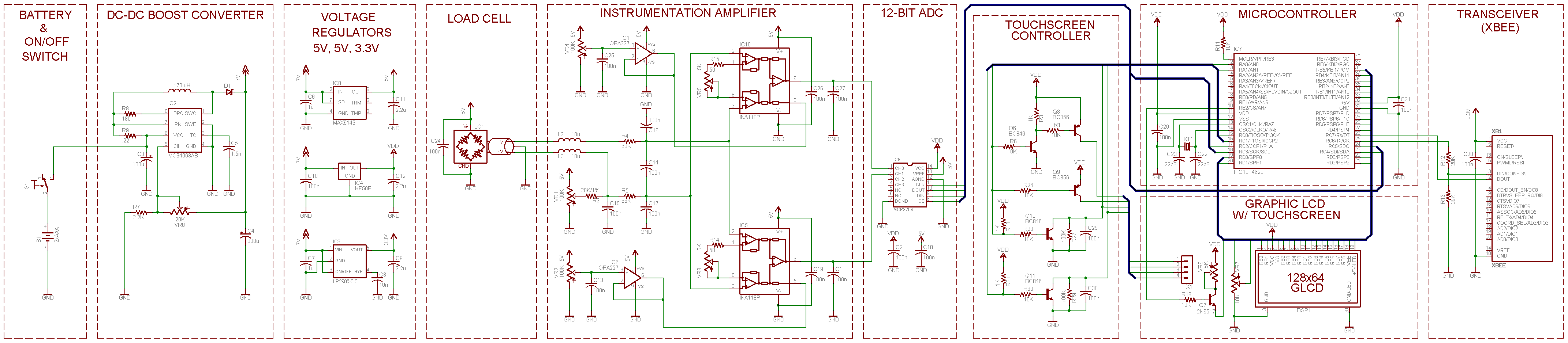

Hello again everyone. I finally got around to sourcing all the parts and have started to put this circuit together. I decided to go with the IN118P instrumentation amplifier and an OPA227 op amp to buffer the reference input of the IN118P. The output from the IN118P will go into an MCP3204 12-bit ADC IC that communicates with the PIC via SPI. The IN118P, OPA227, the VREF input of the MCP3204, and the load cell are all powered by a precision 5V voltage reference, the MAX6143. The rest of the 5V devices (PIC, LCD, VDD of the MCP3204 ADC IC, etc) are powered by a non-precision 5V source, the KF50B.
Anyway, I ran into a problem right away that I can use some help with. I started by setting up a test circuit for the amplifier portion just to check that everything was working correctly. I put the IN118P in a breadboard and connected the inverting, non-inverting, and reference pins to ground. I should mention that this test circuit was powered by a standard 7805 and my bench power supply. There is also a 100nF cap no shown that I placed between V+ and V-. Here’s a schematic:
In this configuration, I would have expected the output to be 0V ± any offset. Well, I measured about 35 mV. I have 2 IN118Ps and both of them output the same 35 mV. I also know it's not my multimeter because it reads 0 V when I touch the positive lead to ground.
The data sheet quotes an offset voltage of 50 µV max so I'm not sure why I'm seeing 35 mV. If the 35 mV is just the input offset getting amplified, then I would have expected the output to change when I adjusted the gain pot but nothing happened.
Is there something wrong with my test set up or my understanding of how this circuit is supposed to work? Any guidance you can offer is much appreciated.
Thank you.
P.S. I also attached the most recent schematic of the entire project for reference just in case anyone wants to see it.

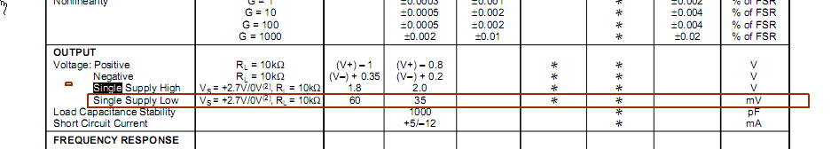

I think I may have just answered my own question. The datasheet says that the single supply output voltage low is 35 mV. That seems consistent with what I'm measuring. Is the 35 mV because the IN118P is not rail to rail? At least I can't find anywhere in the data sheet that says it is.

It will be. The MAX6143 powers the bridge of the load cell, the INA118P, the OP227 and the VREF input of the MCP3204. I haven't put any of that together yet but that's the ultimate plan. Just for testing the INA118P by itself, I am using a 7805 because the MAX6143 is a surface mount device.

The d/s shows 35mV for Vlow with a single supply.

Yeah, it's starting to make sense now why I got the results I did. Also this excerpt from the paragraph titled "Single Supply Operation" on page 10 basically explains all my problems.
"With single supply operation, VIN+ and VIN- must both be 0.98V above ground for linear operation. You cannot, for instance, connect the inverting input to ground and measure a voltage connected to the non-inverting input."
I feel silly because I'm usually the first one to point people to the datasheet when they ask questions like mine and even sillier yet because I've read this entire datasheet before. I guess that's what happens when you get distracted for a few months.

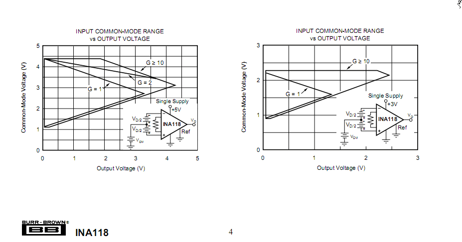

The INA118 with a single 5V supply will limit at about 1V to 2V below the 5Vsupply, its also effected by the value of the load resistor R5.
When I use the AD623 [IA] I have the same problem, I get round this by following the IA with a MCP6002 rail to rail OPA, set for a non inverting gain of 2. This means I can adjust the gain of the IA to give a +2.5V max out. I use the other half of the MCP6002 as a buffer amp for the Vref to the IA.
OK.?
EDIT:
Another option would be to use Vref/2 on the MCP3204 and set the IA gain to give +2.5V at max bridge input.
Look at page #4 of the d/s to see the effect on the Vout with different Vbias voltages. ie Common Mode voltage.

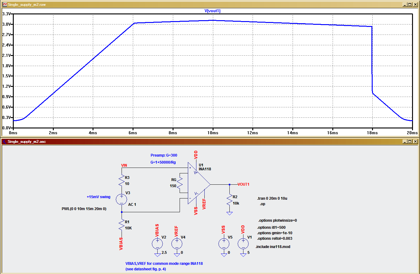

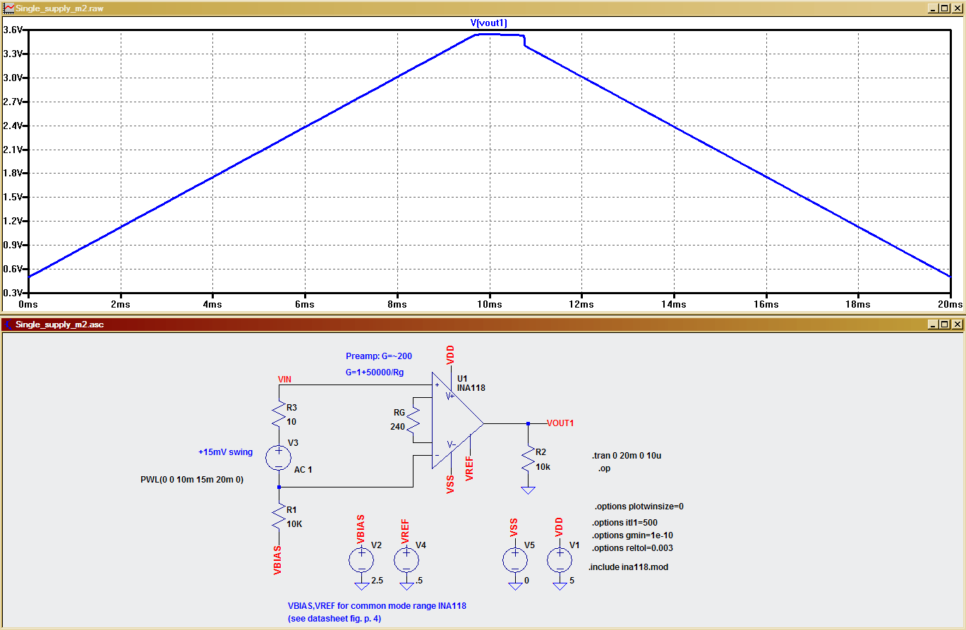

Look at these sim images.
The 1st is the circuit you posted, gain about 330 with Vref=0
the 2nd is gain ~200 with Vref = 0.5V [ just starting to limit on the output]
Both with a 0 to 15mV input signal swing

Ah OK. The fog is starting to lift now. I noticed those plots you attached while I was reading the datasheet but in all honesty, I didn't know how to interpret them. Just to make sure I'm understanding them now, the common mode voltage is the voltage at the inputs with respect to the reference pin (in this case ground). Is that correct? So in my latest circuit, the common mode voltage would be about 2.5V, correct? If that is the case, couldn't I just add an additional series resistor between the bridge and ground to bump the common mode voltage coming from the bridge and gain a little more output voltage from the INA118P?
I also like your suggestion of using half the supply voltage at the VREF pin of the MCP3204. I have some 1KΩ/1% resistors that should do a pretty good job unless you think there is a better way to tackle that.
I was aware of output current effect on output voltage swing. That plot is on page 6. To minimize this effect, I was planning on buffering the output of the INA118P with an MCP6002 (your favorite) before going into the MCP3204. I happen to have quite a few MCP6002s around because I belive you suggested them to me some time ago while I was working on an earlier project. I always buy more than I need becuase I fry stuff all the time.

These plots really drive home the effect you're talking about. Just out of curiosity, why does the plot start around 200 mV, not 35mV?

The starting at 0.2v on the plot I believe is related the point you made in post #33, ref the d/s note about a single supply effect on grounding an input pin.?

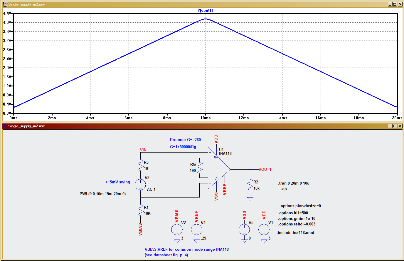

The sim shows the optimum around 3V for the Vbias, gain is ~260, the output voltage is just starting to limit.
This will need to be proved in an actual circuit.
I would be careful in optimising the circuit too much, it can lead to problems when repairs are made to the circuit.

OK, maybe I'll just ditch that idea and go with VREF = VCC/2. Did you see my edit to post #37?
