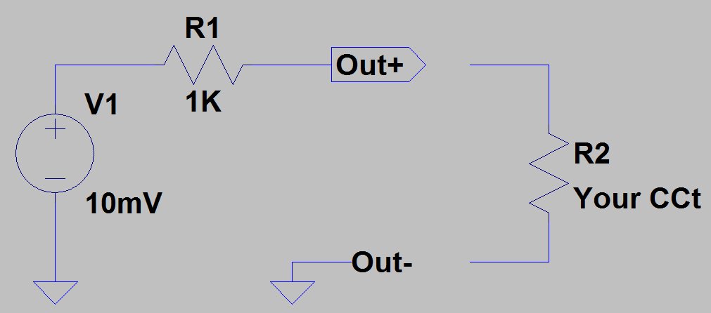

I am not sure if you just need to do this one time or you want to know some theory of how to do this mathematically.
If you take Nigel's advice you can use build the circuit in spice to simulate, then do a few tests to determine the input resistance.
If you want a straight up mathematical analysis you can assume that the transistor is a controlled current source, then perform a few math tricks to get the result. This usually involves assuming a range of Beta values for the transistor just like other calculations that involve bipolar transistors.
The transistor, when viewed as a constrained current source, leads to a circuit which is fairly simple with only two nodes so it's not hard to calculate.
However, you'd also have to have knowledge of the base emitter diode IV curve.
Using Thevenin equivalent circuits, build it. Put a 1K (for example) in series with the output of your test circuit (say 10mV). Load it with your circuit and measure the new input voltage between your 1K resistor and the input circuit. The drop in input voltage will be caused by the loading impedance. The rest is school boy maths.
