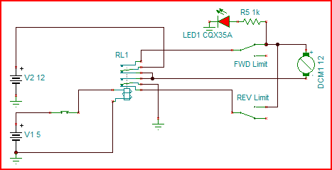

Input for linear slide actuator
Why do I think I (we) went a long way around for a very simple answer?

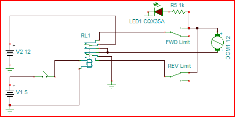

I think all I need to do is swap the wires on the switches (common and NO). Better yet, IIRC they are quick connects not even soldered.
Here is the circuit with the slide having traveled to the left.
Yes when the slide first starts to move, the input will come on. So instead of changing 1 line of code I will have to also add 1 (wait for Input=0 then wait input =1).

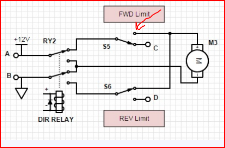

At the point indicated, 12VDC or 0VDC is present depending on the conditions of RY2, S5 and S6. Simple 0 and 1 digital conditions, only swapped when the slider engages either the OPEN or CLOSED limit switch, demonstrated with an LED below:
or (OPEN):
If you trace the lines, (and this is confirmed in the SIM), either logic condition is held until the slider engages the limit switch towards which it is headed (having disengaged from the the limit switch that it is leaving).
I can put up graphics of EACH STEP for the switch conditions is you like.

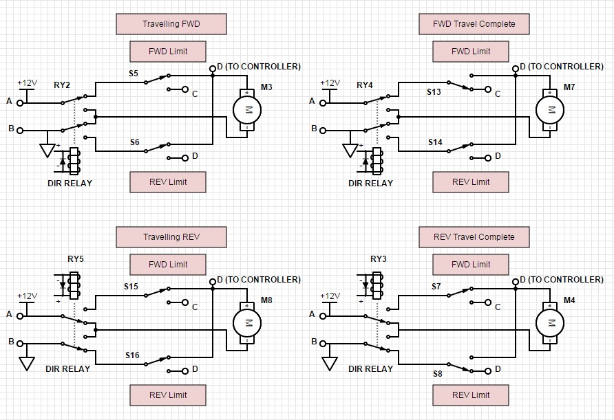

I agree the LED point will be 12V or 0V. The circuit needs to differentiate between limit switch and travelling. Unfortunately I don't see that in this circuit, yet.

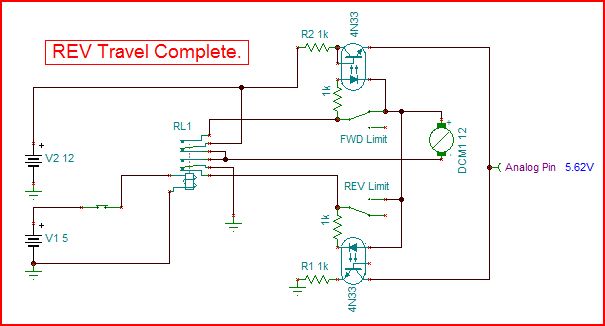

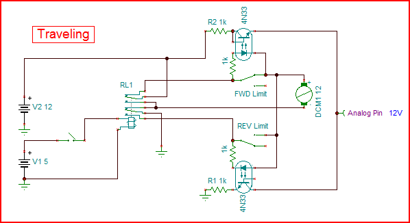

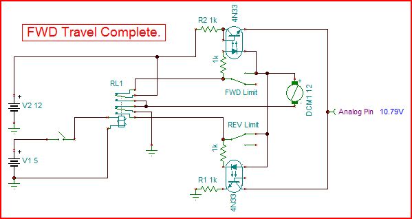

At Point D:
Travelling FWD =12V
FWD Travel Complete =0V
Travelling REV =0V
REV Travel Complete =12V
The voltage out for travelling and travel complete are different depending on if it is travelling FWD or REV. Which is what I think cowboybob is saying. but that still provides two different voltages for FWD Complete and REV Complete.
P.S. Sorry about the upside down relays, I wanted to show them in position so I (and everyone else) can follow.

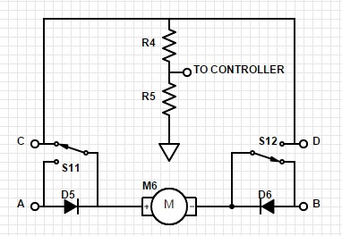

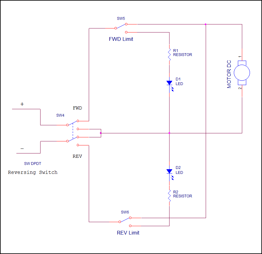

In the below circuit LEDs D1 & D2 illuminate when their respective limits are met. Both D1 and D2 could easily be replaced by opto couplers. The problem here is working from an existing circuit and keeping the parts count down. Being a small motor drawing <600mA reversing and control is relatively easy. Modifying the existing circuit isn't quite as easy as starting from scratch. :(
Anyway, opto couplers could be used to provide the logic outputs.

ADWSystems, we're simply talking around the same solution:
1. two, distinct voltage values (the logic) on a single (one wire) connection (Gnd {0} and Vcc {1}) that only occur at distinct slider positions
2. an assumed slider movement, confirmed by 1. above, within the "wait" code (an assumed code timeout on the "wait" to capture a slider error).
Whatever the logic choice (voltage divider or opto-isolator), you should add a diode to the circuit (as below) to ameliorate any back EMF from the motor when it is turned off:
Unless, of course, I've missed something thus far... :woot:
Cowboybob, looking at D1 in your drawing, what happens when the motor polarity is reversed? As drawn the cathode is on Motor + and anode is Ground but when the motor reverses what happens? Most reversing brush type motors we just place a cap or three across the terminals and each terminal to the motor case, generally 0.1 uF.

I can follow your logic and will be drafting it today, but how it works is not the same as the expectation. The expectation was similar to Ron's drawing, only a result at the switch (1) and nothing (0) in between (while travelling). Your logic provides the same signal during travelling as one of the limit switches. Since the motor controller and the sensors are tied to the same processor it is possible to integrate your logic; because I know the commanded direction of travel I know which signal (0 or 1) to look for.
Ron
Nothing , since the cathode would also be grounded. Any back EMF generated from the motor running in reverse would be applied to the 12VDC Vcc line feeding the - motor connection.

I understand that, it took me and you an extra post to switch my gears. Do you see that is not what was expected?
The expectation was 1 at the limit and 0 during travel. (life would be great if everything was this simple)
-The preferred option would be: 0 at the starting limit, 0 during travel, and 1 upon reaching the ending limit. Ron has it in post #29, but I will need to see if they will add the hardware (extra wire, pr of resistor/optos, connectors, etc.).
-My circuit in post #22 has, 1 at the starting limit, 0 during travel, and 1 at the end limit. This would require hanging resistors from the switches to field cables, or running both other switch pols back to the cabinet (similar to Ron #29).
-Your solution as (a) if travelling forward then 0 during the travel and 1 at the FWD Limit and (b) if travelling reverse then 1 during travel and 0 at the REV limit. So the signal depends on the direction of travel. No exactly analogous to the expected logic. Doable, but I will need to get them on board and to change their thinking the same way I had to. This has one wire and one resistor/opto pair.

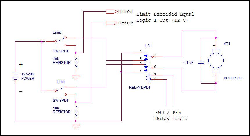

Here, this should be a solution:
The limit switches were moved upstream from the reversing relay logic. When either limit is met you get a logic 1 of 12 volts, less if you use a divider. This is as simple as I can see it working. I did not label Fwd / Rev but as drawn the logic is pretty simple as to what is open and closed. Also not shown is a diode across the FWD / REV Relay coil.
Will this fly?
Ron

Ron, what's the capacitor for?
Keep in mind the motor is mounted with the switches, which is away from the direction relay and power source. Currently it runs from a 2C cable, I'm trying to convince them to rewire with 3C. I think the new layout would require 6 or 7 conductors (2-motor, 1- power to sw common, 2 for limit sw NC, 1 or 2 for the limit sw NO)
