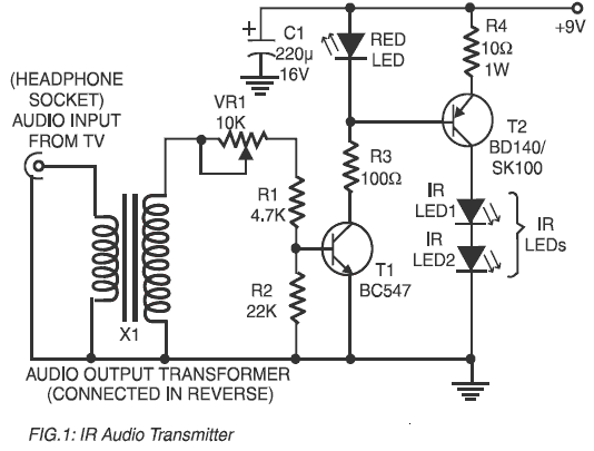

I think there is a site in India with an IR headphones circuit. It uses an audio transformer. The circuit does not work.

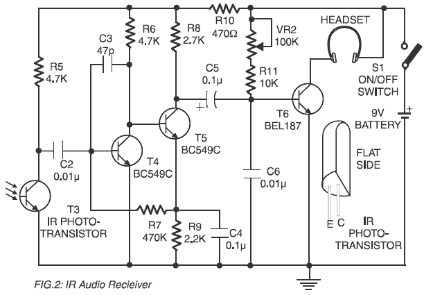

That is the Indian circuit that does not work:
1) The transistor is not biased so it rectifies the signal producing severe distortion.
2) The red LED abruptly limits the current which causes even more severe distortion.
I think the design of the IR receiver is just as bad.
thanks but can u tell me what are the defects in receiver circuit and what should be done to get rid of these problems.

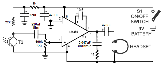

You need a modern audio amplifier like an LM386 then it has a 470uF output coupling capacitor.
Make the IR receiver like this:

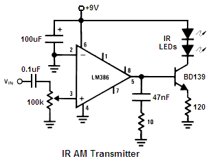

It is easy to use the LM386 audio amplifier IC to drive a power transistor that drives two IR LEDs in series with amplitude modulation. A 9V alkaline battery will become weak in about 10 hours.
