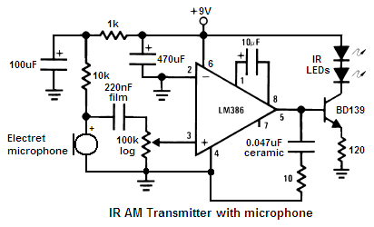

Adding a 10uF capacitor from pin 1 to pin 8 of the LM386 boosts its gain 10 times to 200. Then an electret mic can be powered and connected to the input volume control like this:

pls tell me what is the range for this circuit, since the ir leds that i used can work only upto 3 inch, how to increase the range????????
It should be much farther.
1) With the transmitter powered from a 9V battery for a few minutes, measure the voltage across the battery and across the 120 ohm resistor.
2) Turn up the volume on the receiver then turn up the volume on the transmitter until the sound is distorted.
3) Try it in a dark room.
4) With the receiver powered from a 9V battery for a few minutes, measure the voltage across the battery and across the photo-transistor with and without it exposed to IR from the transmitter.
What are the part numbers or please post the datasheets of the IR LEDs and of the photo-transistor?

Sorry, but there's very little 'right' about either of those circuits.
First off, no decoupling capacitors anywhere, and both opamps are been run with an input impedance of only 1K, far too low for either transmitter or receiver.
the opamp for the transmitter has a signal voltage loss of much more than 100 times instead of a signal voltage gain.
The feedback pot is only 100 ohms maximum. an opamp can barely drive 1k ohms, not 100 ohms and less.
The 1k input resistor is like a short to ground to the microphone.
A mic preamp for an electret mic is supposed to have a gain of about 100 (not a loss) and have an input impedance of about 47k ohms, not 1k.
So the preamp opamp should be non-inverting to have a high input impedance and have a voltage gain.

It is easy to use the LM386 audio amplifier IC to drive a power transistor that drives two IR LEDs in series with amplitude modulation. A 9V alkaline battery will become weak in about 10 hours.

If you made the circuits that use an LM386 amplifier IC in the transmitter and receiver then the range can be increased by adding more BD139 transistors with IR LEDs and 120 ohm resistors. Also the range can be increased by adding a preamp transistor to the input of the LM386 IC in the receiver.
Since it uses IR then the range is farther in the dark.
