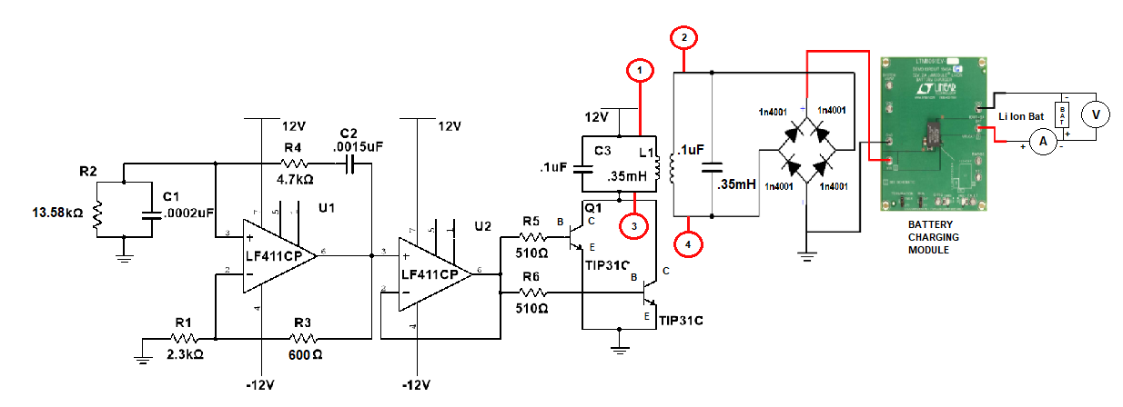

Regarding the figure below, what is the proper way to measure the Voltage across the inductor? although it is not a good idea that I used class c amplifier.

I assume you mean across the L1 transformer primary.
If the power supply outputs are isolated, then connect the oscilloscope common to the +12V supply to measure from point 1 to 3.
Sir, what do you mean isolate the power supply? I Really dont have any idea how to measure L1 using oscilloscope.
(not isolated in #2)

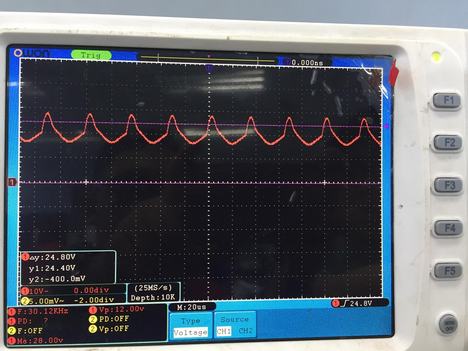

Connect the scope ground to your ground. Connect the probe to (1) which is 12V. Set the scope to display this in the center of the picture.
Now move the scope probe to (3) and you should see a picture where 0 volts across the transformer is the center of the picture.
Another way: We know there can not be DC across a coil or transformer. Set the scope to "AC" and the scope will remove the 12V DC from the picture.
