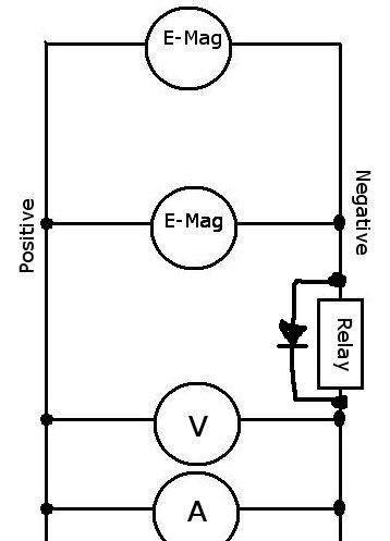

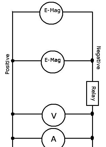

I drew up a little diagram, my relay is on the main line, not in one of the parallel branches. Both of these mags are turned on at the same time. Would someone be able to just throw the relay into the drawing. Doesn't have to look good, just so i can get it.

Hope you were serious about it not having to look good :D
That's a pretty confusing diagram by the way, the power supply arrangement isn't very clearly marked but I assume the positive and negative labels refer to the connection points they're closest to on the diagram.
By the way, the electromagnets will require protection diodes in a similar configuration, as they are also inductive loads. Probably bigger ones in fact. Of course unless there's something sensitive to the brief voltage spike in the circuit, you shouldn't need any of the protection diodes anyway though.
