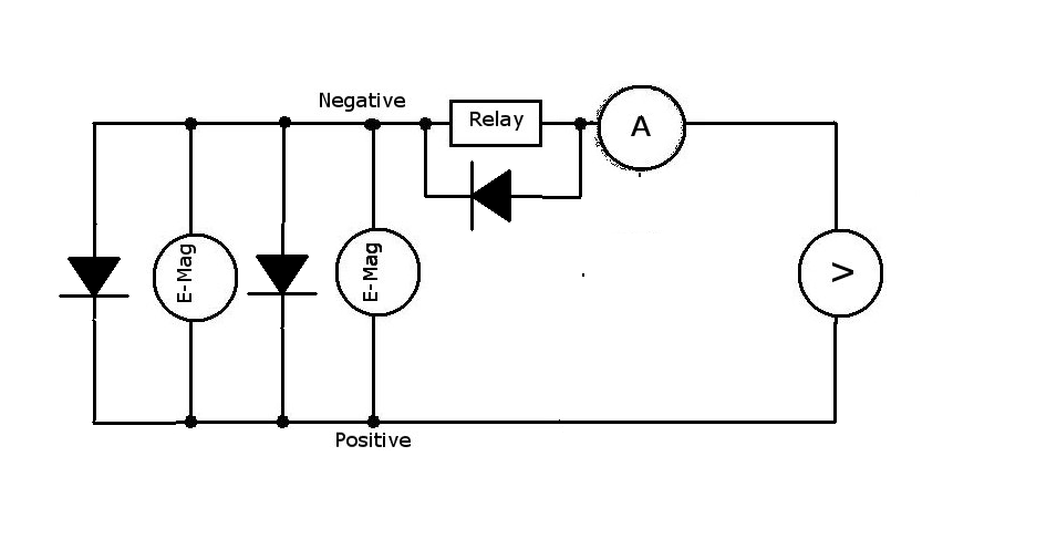

Here's a more protective design

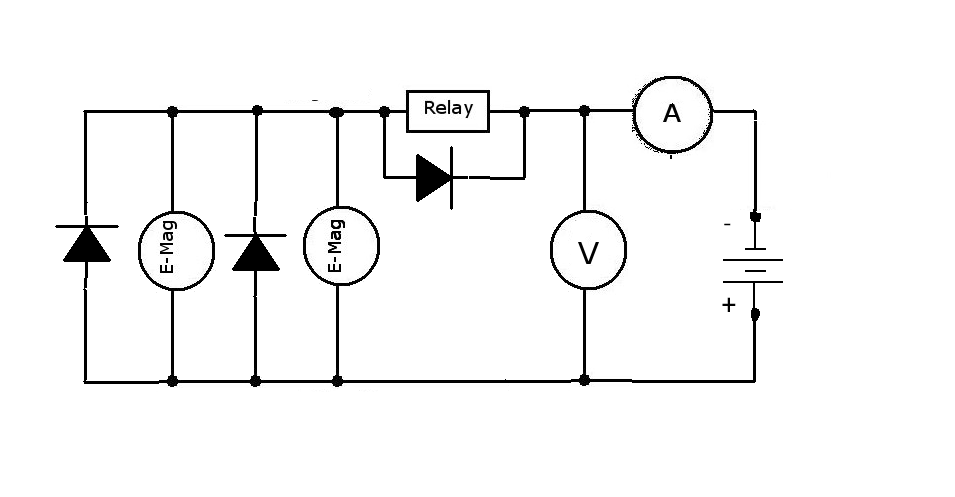

I added in a battery and removed the words negative and positive to avoid confusion. Are the diodes still in the correct position? I thought the other end had to be facing against the negative side.
Note that a voltmeter should be connected in parallel. It has high impedance and you have it connected in series, which will prevent anything but a very small current flowing through.

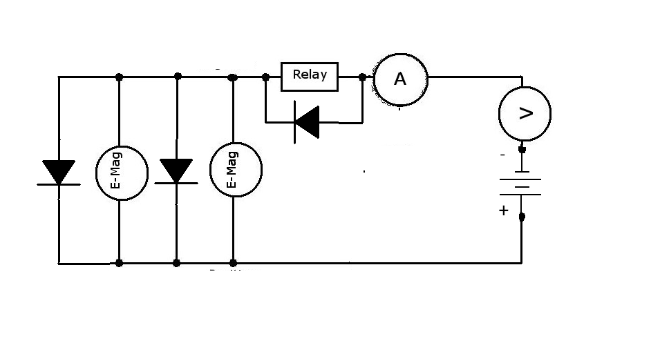

There I think I fixed it, also I rotated the diodes, I'm pretty sure they are correct now.
No, the diodes were correct before. As explained previously, they should be in antiparallel with the inductive load. Turn them back around ;) The voltmeter is correctly connected now.
How?? I thought they were supposed to give a clear open path for the excess voltage to go back to the negative terminal. If I put them back, power will flow from the negative terminal through the diodes and cancel out the relay. The relay will never break the circuit.
Well for a start, the way you have the diodes connected in that picture, there is a clear conductive path across the battery terminals, with only the two diodes and the (low-impedance) restricting the current. The majority of the current would flow through this path and not through the electromagnets or the relay.
From your statement, you don't seem to understand the polarity of the diodes; the start of the "arrow" is the anode, which is the positive end; the other side is the cathode, the negative end. The diodes need to be given a reverse bias to be used as protection diodes for the inductive loads; that is, they need to be connected "the wrong way round".

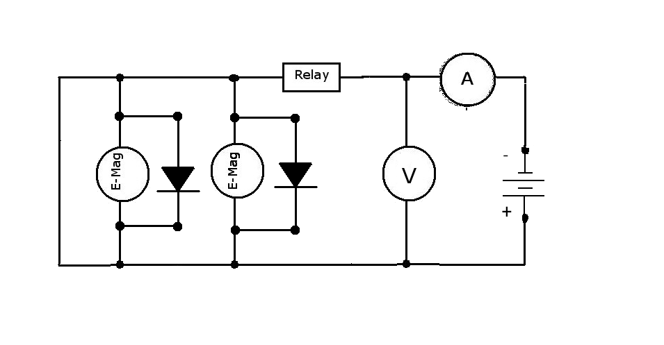

Ok fair enough. How about this instead, one diode for each magnet, that way its in a nice self contained package.
All you've actually done there (besides removing the relay's protection diode) is move the protection diodes on the schematic to a less clear position. Hopefully you understand that other than the addition of the battery and the removal of the relay's protection diode, your schematic is the same as the one provided by kinafi.
Edit: Sorry, just noticed you also added a conductive path on the far left so that the electromagnets are also no longer in series with the relay. Not entirely sure why you've made that modification though...
A question to whoever may be able to answer it: why the two protection diodes for the two electromagnets, since both protection diodes are in parallel with both electromagnets anyway? Is there a specific reason why this would be required? Would the electromagnets not be able to share a single protection diode?

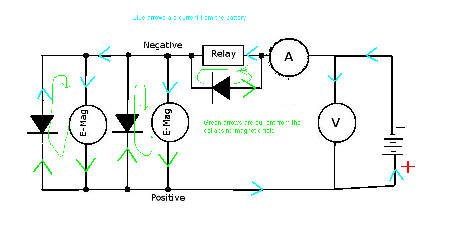

Basics, Electron theory, Current flows from - to + outside the source,
Current flows through a diode against the arrow, cathode to anode,
Charge up the electro magnet and when the power is removed and field collapses, It becomes a source of the opposite polarity trying to keep the current flowing in the same direction and you want the diodes to conduct.

While it is true that electrons move from negative to positive, it is convention that current flows from positive to negative. You're just confusing the issue by showing the opposite.
I was actually more confused when you said that. I figured power on a battery flows from negative terminal to positive. What were you saying
