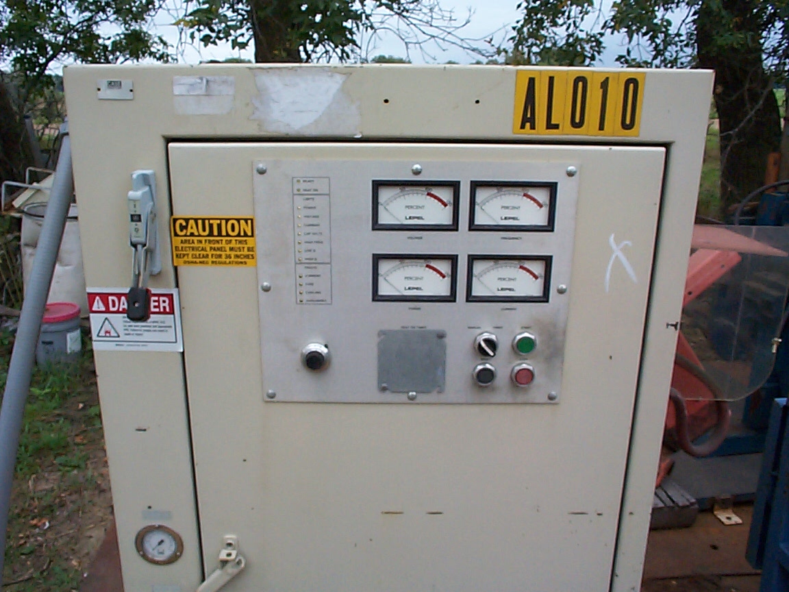

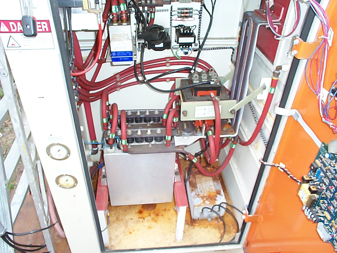

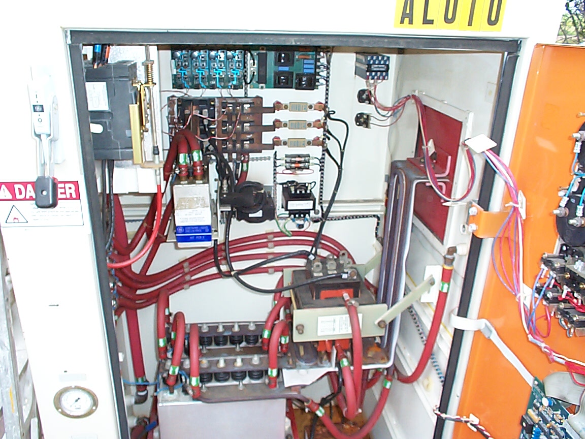

A buddy of mine has a large scrap yard and salvage business and one of his many odds and ends is a used 77 KW industrial induction heater rig.
I want it but have yet to ever find a legitimate use for it! That and I only have a 240 VAC 200 Amp service in mys shop. Good excuse to step up to a 400 amp service though! :D
Don't really have any specific use for it, LOL
at 77Kw that unit must be insane!
Just readly a project to build and an opertunity to learn some new aspects of electronics, but a really awesome tool to have. As i do a bit of mechanics it can come in handy for heating bearing etc.
